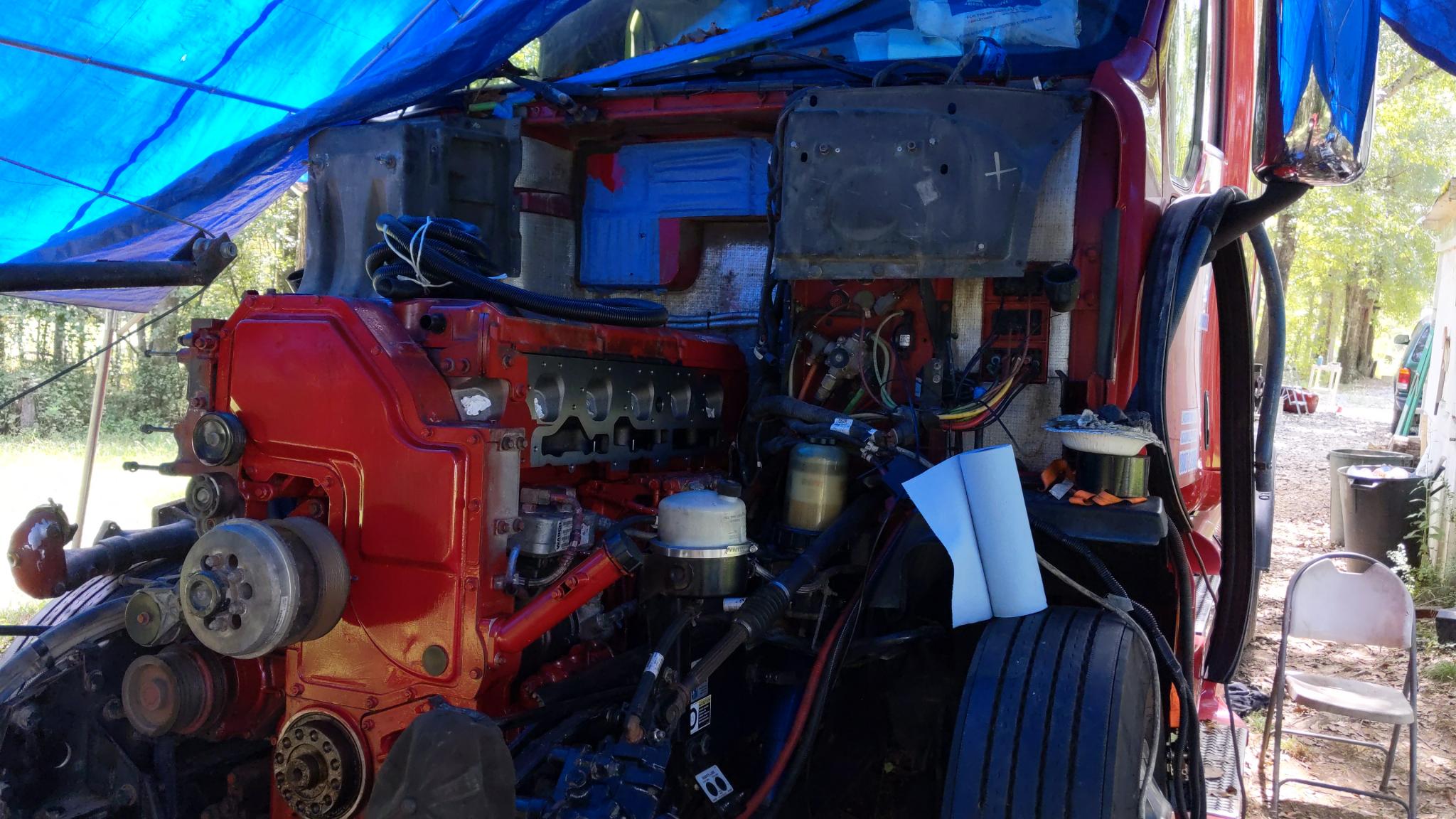

Helped Mr. JimT install head day before, and finished up the final torqing the head yesterday. Looks like he has been doing a lot of painting and cleaning on things.

Yup, spending extra time cleaning and painting things that I never plan to touch again, if I can help it! Much easier to clean the grease/oil/dirt/peeling paint off while the parts are removed. It's gonna look shiny new red from the frame rails up. Far from a high quality paint job though. 1 thick, slightly runny coat of IH Red paint from Tractor Supply is all most stuff gets. Looks like Cummins Red but goes on much thicker and takes about 4 times as long to dry. A little Corroseal on select parts exposed to road salt.
Would be nearing completion today if I didn't spend all day waiting to to go the parts store for some small odds and ends. Probably gonna add yet another day to the project :/

Looking pretty! Much nicer than that hot mess you arrived with! I now wash mine down with hot water, Dawn, a rag and a garden hose... LOL! Keep her fresh. ;-)

Looking good. You can see the light at the end of the tunnel now.

Yeah, spending a few extra days degreasing, removing rust buildup, cleaning and repainting all the external parts as I put em back on. My engine bay is tight and set back into the cad so it's hard to paint about half the engine once assembled, plus this way I can get a coat of paint on the back sides of components to help prevent rust buildup in the first place.
And for those who say painting is unnecessary and a waste of time, I'd argue that beyond the nice clean look you have the added bonus of being able to spot new leaks really quickly as they will stand out against the new paint. Like Waterloo mentioned, I plan to personally clean the engine bay from here on out (no power washing monkeys will touch this baby).
As for progress, lots of cleaning/painting. Got the new damper installed and fixed up some of the wiring harnesses that were starting to fall apart (mostly the wire loom disintegrating). Also started the day yesterday with a slight hangover, so I wasn't moving too fast...
