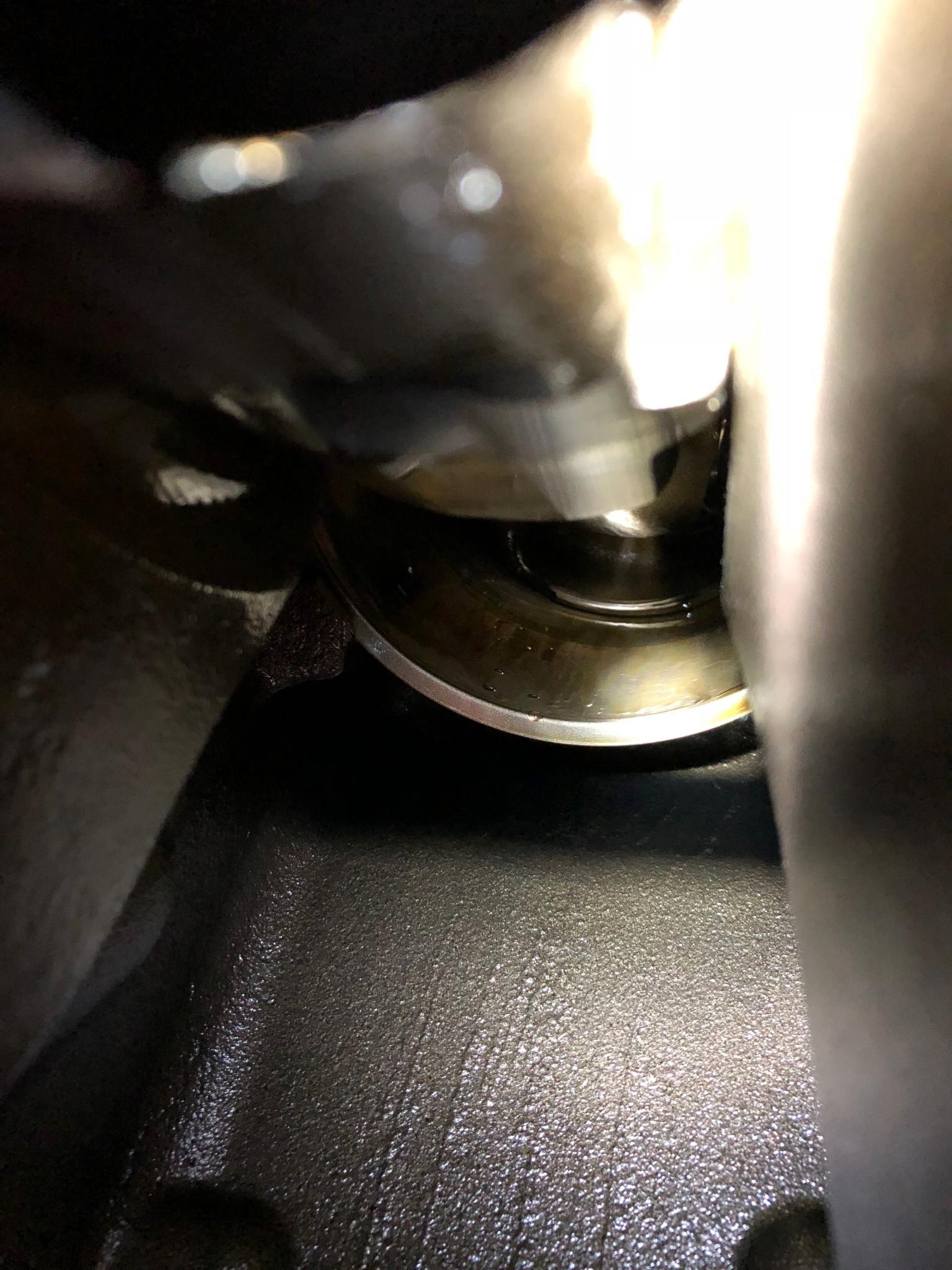

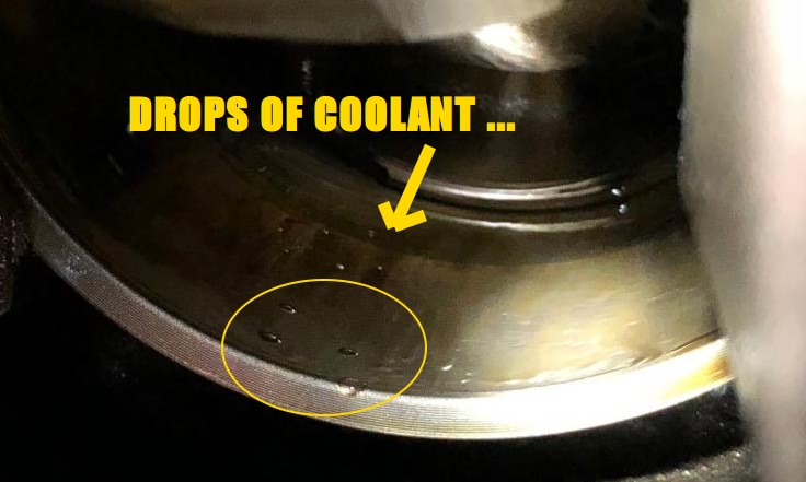

If you really want to get to the bottom of this, drain the oil and drop your oil pan. Pressurize the coolant system to 20 psi and let it sit overnight. Following day, bar the motor, two people makes this easy.
Pressurize the coolant system, I use a Stant hand pump and adapter I found on Amazon. https://www.amazon.com/gp/product/B0002S...UTF8&psc=1
Looks identical to the Snap-On units. Here is the adapter that my truck requires, for reference. https://www.amazon.com/gp/product/B000VS...UTF8&psc=1
I don't know how your cooling system is set up, but pressurizing is the way to go, you just need the correct adapter(s) for your particular system. The way I found the correct adapters was to ask one of the techs at the dealer what they use. I crossed referenced the Snap-On adapter he was using and found the much cheaper Stant unit.
Here is what you are looking for if you drop the pan and pressurize the system...
./uploads/201804/post_2_1524224778_b7d7987bc5a293f7617c199ef09cfefc.jpg

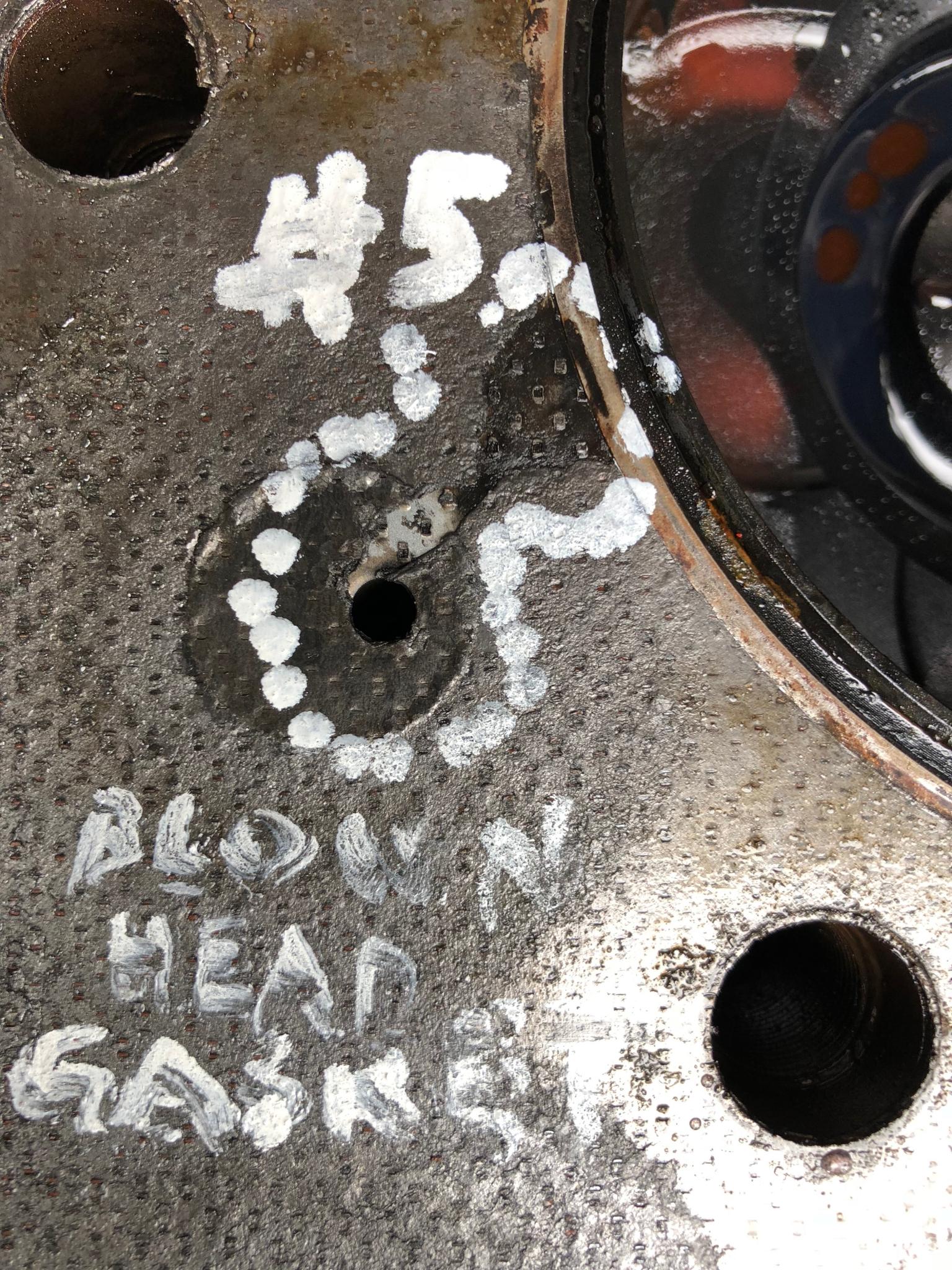

This took a couple of days to show itself. We pressurized, let sit for a good 12+ hours, barred the motor, Rawze was under the truck watching as I worked the motor. The first try we found nothing. Let it sit again overnight, repeated and this time we actually heard the coolant in the block gurgling when I barred the motor. The pistons make a shhhhh sound, number five cylinder went gurgle gurgle gurgle. And sure enough, it was the #5 cylinder that was the source of our coolant leak. The liner had fretted and took out the head gasket and the head.
Here is the head gasket...
