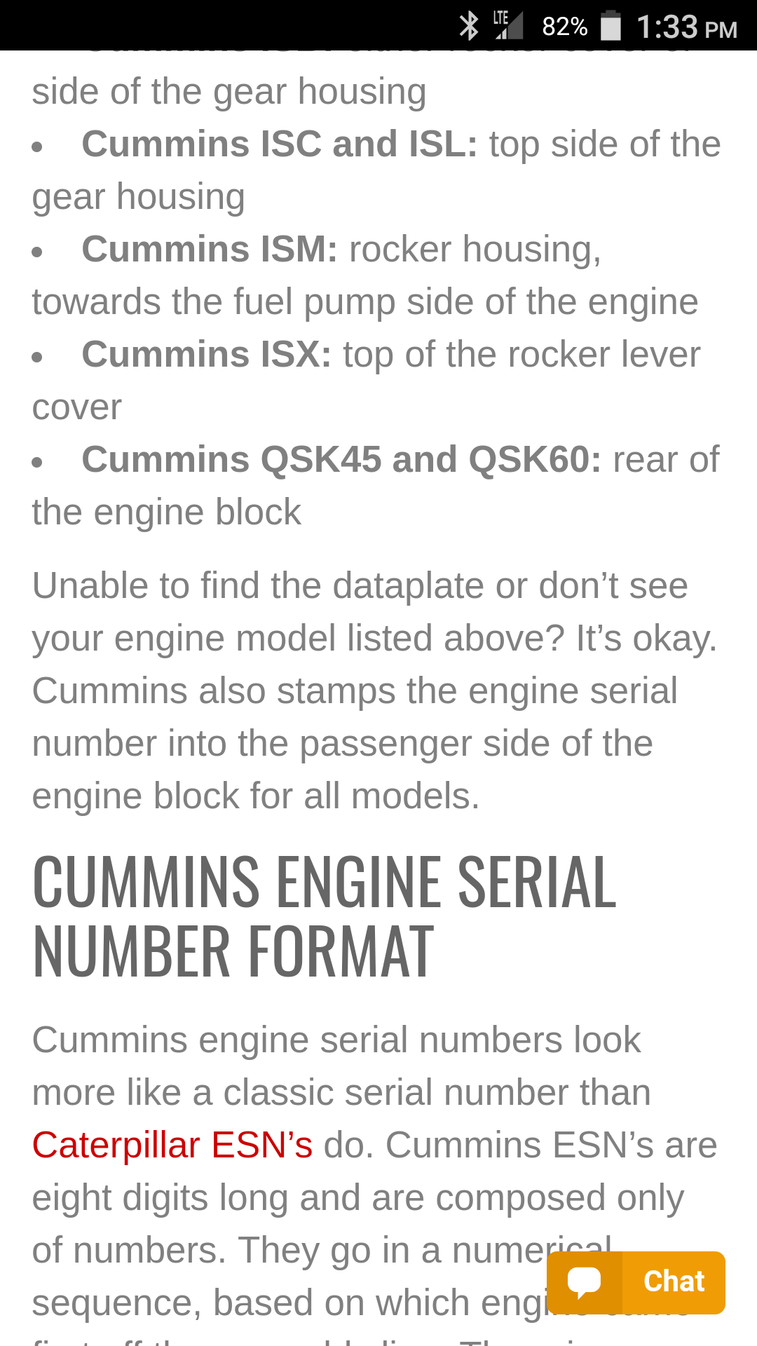

08-30-2018, (Subject: 2007 isx cm870... PLZ HELP )
RE: 2007 isx cm870... PLZ HELP
./uploads/201808/post_3285_1535650491_4979a2fdf92586220ced2da6788f6797.png
I've never personally looked for it there but its worth a look.
(08-30-2018 )Chamberpains Wrote:  I've never personally looked for it there but its worth a look.
well im sure its there but i think its behind the egr cooler....
