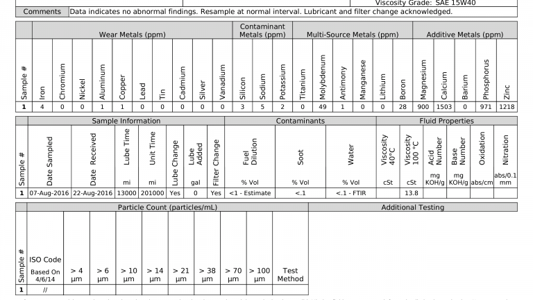

It will be hard to find if pressure test coolant cause you have only 40ppm of potassium. I had about 50ppm of potassium and didnt find when pressure test my coolant. But I found that my oil cooler big gasket was leaking oil and mixing oil with coolant abit. So I replaced oil cooler gasket and potassium is gone from oil analysis now.
This is 13000miles mobil delvac 15w40 oil sample on @m*m^2.
./uploads/201608/post_608_1471958126_fec555d6a4735ab1a488bd5fdb32b8a0.png
Btw ..I dont run bypass filter no soot in the oil.
