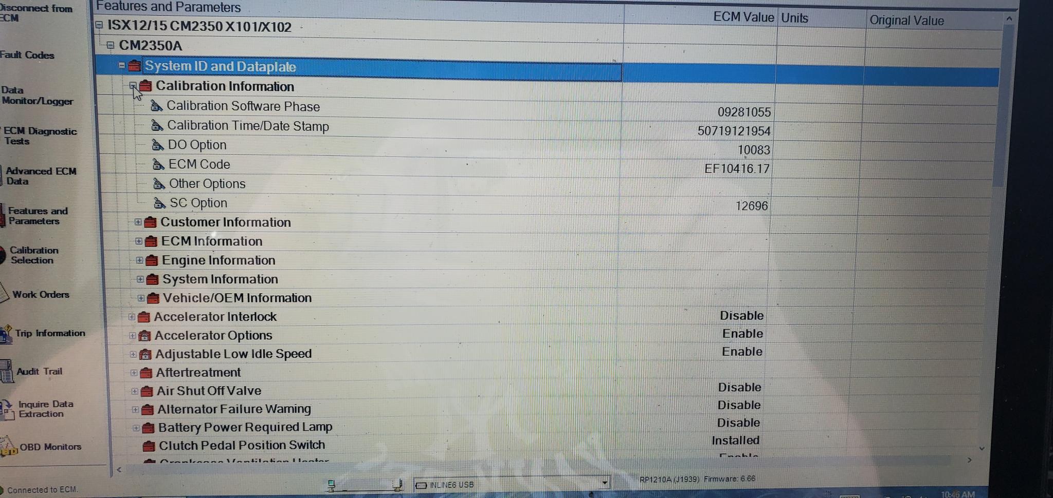

 RE: Need help to identify this isx...  (10-03-2020 )Rawze Wrote:(10-03-2020 )jared1751 Wrote: I have no idea what program is in it. This motor having 327,000 I should be addressing the fuel pump? Is there anything else that would need attention now? the overhead was run and dpf clean this week before I picked it up. I know the previous owner would have not addressed anything other than pm's and warranty work. I took youyr advice and got the inline 6 and insite up and running. I will do the research to learn my way around insite, in the meantime is where do I find which program is in it?  |  |||
|    10-17-2020, (Subject: Need help to identify this isx... )   Post: #17   |  |||
| RE: Need help to identify this isx... | |||
|    10-18-2020, (Subject: Need help to identify this isx... )   Post: #18   |  |||
|  RE: Need help to identify this isx...    ECM code is your calibration     |  |||
