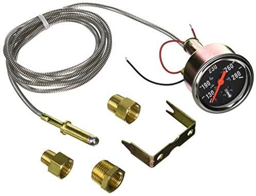

(02-26-2022 )Rawze Wrote:  There is no doubt that those hoses have gotten damaged by all of the battery current flowing thru them that it is not supposed to handle.
From my youth, you can start a Ford 302 maybe twice by only the mechanical temperature gauge as your ground. Also serves as an under dash glow light for a very short time...
./uploads/202202/post_2789_1645890246_bbcc89f0514e008f99c4c316d61f7049.jpg

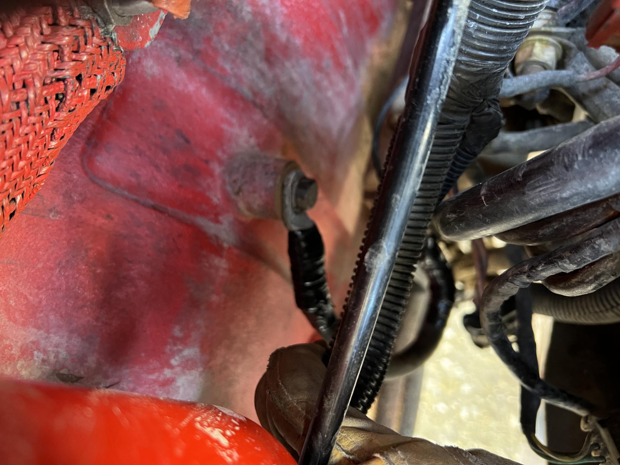

I found this ground going from the block to the starter.I disconnected it on both sides and peeled back the cover on it a little bit and the wire looked good.Did the same to the ones on the starter and they were good as well.Sanded the block side and the bolt and nut that hold the wire to the block.Attached is a pic of it.
