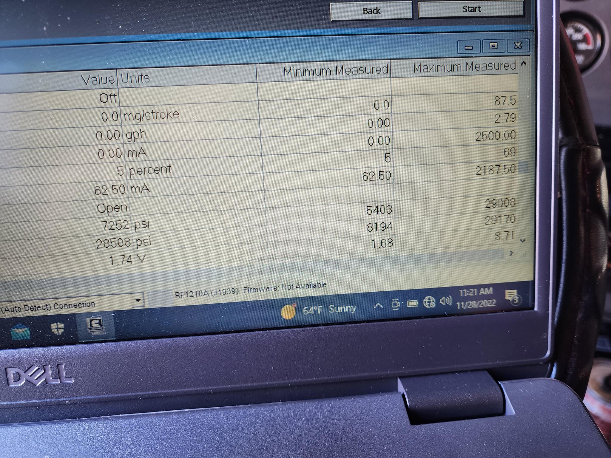

RE: Cm2350 intermidiate loss of power
I never lost more than 800 psi in one minute and I did it 3 times
11-29-2022, (Subject: Cm2350 intermidiate loss of power )
If you have any ideas where should I go from here please let me know thank you!
