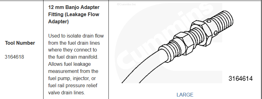

| 02-25-2020, (Subject: Isx 2350 485hp. Surges has no power ) Post: #27 | |||
RE: Isx 2350 485hp. Surges has no power (02-25-2020 )Rawze Wrote:It is possible fuel leak from valve return line connected to fuel return manifold. Line need to be disconnected completely and moved away from valve head or use special tool to monitor only valve return line or block valve return line at fuel return manifold with 12mm bolt.(02-24-2020 )LLT Wrote: ... | |||
