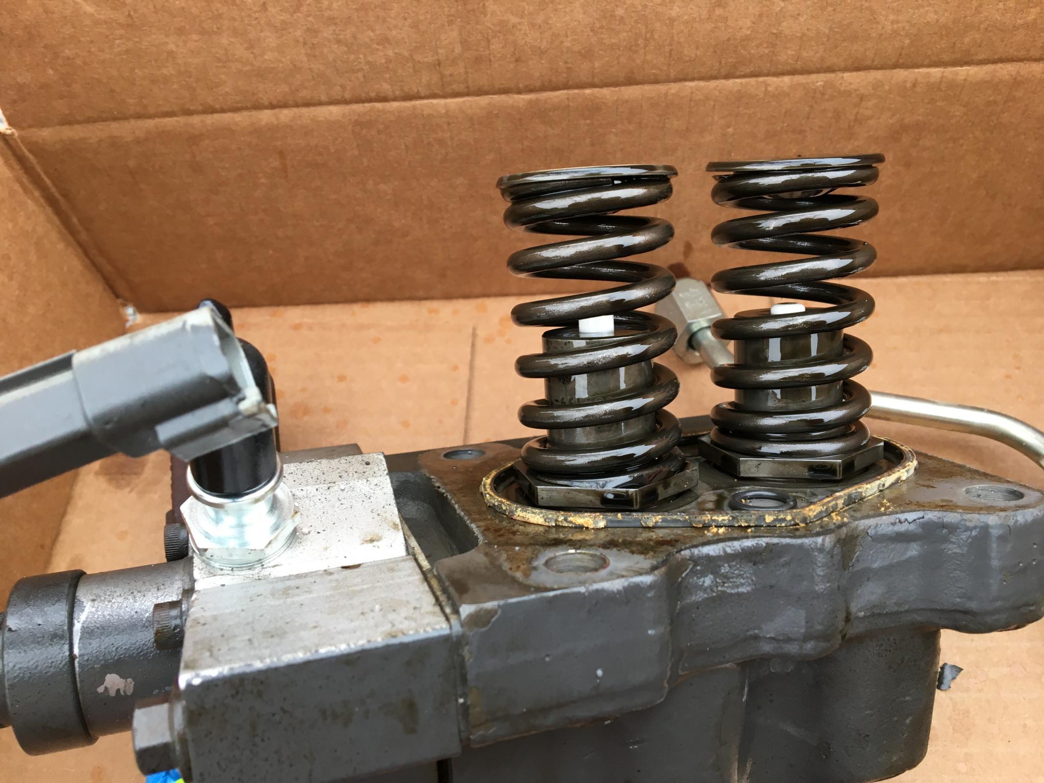

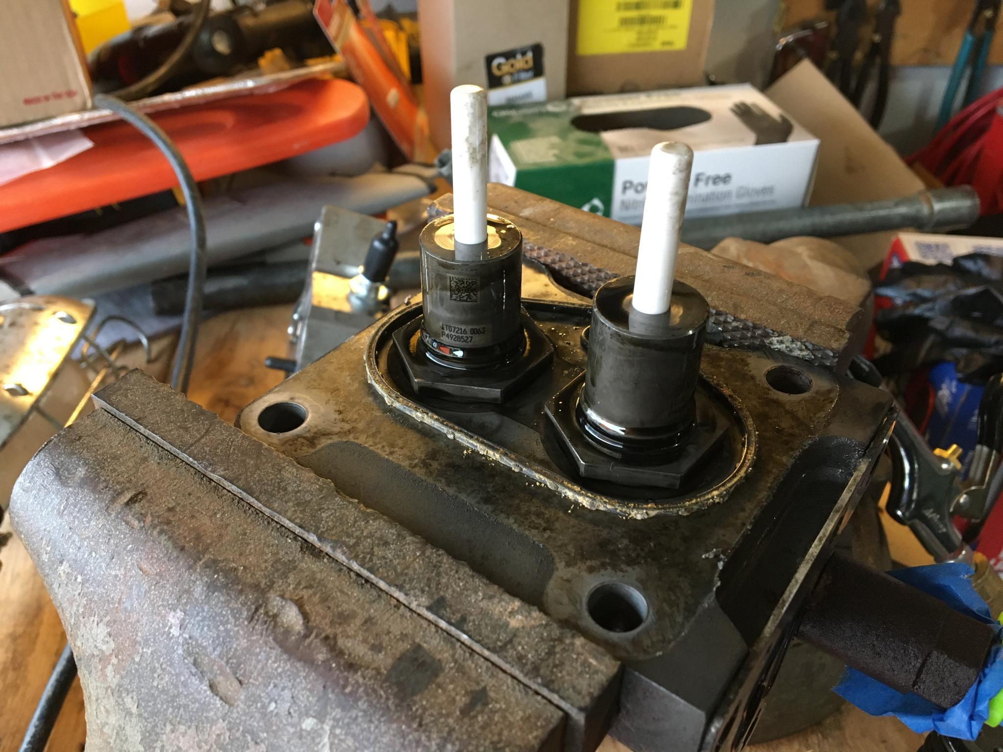

Pump body and pump head. Ceramic plungers. Prob should replace them? Did no do the bounce test yet.

Should pull the pump body off yet I assume?

(01-14-2020 )hookliftpete Wrote:  Pump body and pump head. Ceramic plungers. Prob should replace them? Did no do the bounce test yet.
those ceramic plungers have "I am about to destroy your entire engine" written all over them.

RE: On the side of the road...
That’s what I figured. Just pulled them out, no visible chipping, etc. both bounce well.

(01-14-2020 )hookliftpete Wrote:  That’s what I figured. Just pulled them out, no visible chipping, etc. both bounce well.
bounce them several times.. if they get lower and lower each time they come back up, then something is bad. <- this is not mentioned in the videos snailexpress provided.
