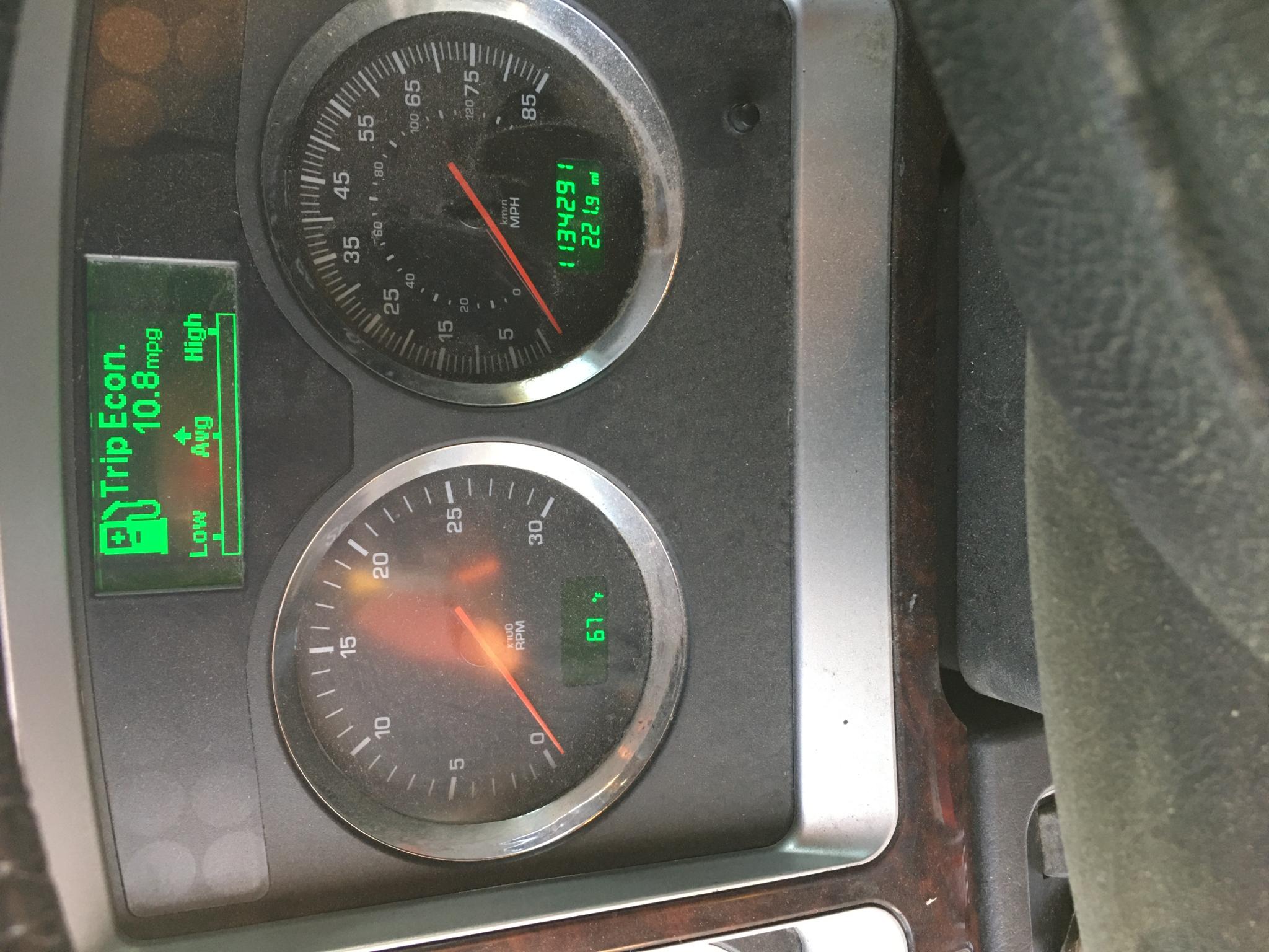

09-27-2022, (Subject: Fuel Mileage Bonus Round )
Post: #40
RE: Fuel Mileage Bonus Round
Thats the way its done.
