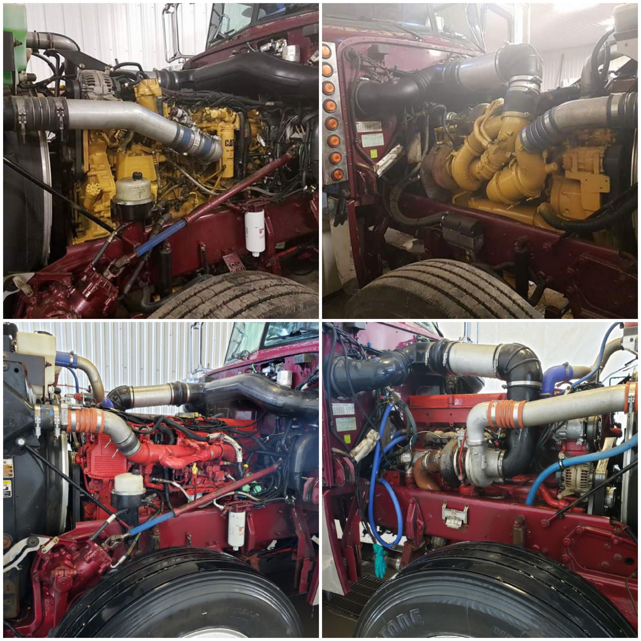

| 04-19-2020, (Subject: Brock's 08 Pete 389 engine swap(Yellow to Red?) ) Post: #48 | |||
| RE: Brock's 08 Pete 389 engine swap(Yellow to Red?) From Yellow to Red Finally have everything done, trucks going in for the safety soon and I'll be out working with her in no time. Just a couple odds and ends and shell be perfect! User's Signature: I'm no mechanic, I'm just a guy that breaks down enough to know a bit. | |||
| 04-19-2020, (Subject: Brock's 08 Pete 389 engine swap(Yellow to Red?) ) Post: #49 | |||
| RE: Brock's 08 Pete 389 engine swap(Yellow to Red?) looking good! keep us posted with how shes running! User's Signature: The creator said " Help your self and I will help you; Protect your self and I will protect you " | |||
| 04-20-2020, (Subject: Brock's 08 Pete 389 engine swap(Yellow to Red?) ) Post: #50 | |||
| RE: Brock's 08 Pete 389 engine swap(Yellow to Red?) Color of truck and frame looks like it was born to have a red engine but someone made a mistake on the assembly line User's Signature: 2010 Lonestar - CM871 - 13sp - 3.70s, 2016 T680 - cm2350 - 13sp - 3.36s - skateboarder | |||
| 04-20-2020, (Subject: Brock's 08 Pete 389 engine swap(Yellow to Red?) ) Post: #51 | |||
RE: Brock's 08 Pete 389 engine swap(Yellow to Red?) (04-20-2020 )Lonestar10 Wrote: Color of truck and frame looks like it was born to have a red engine but someone made a mistake on the assembly line LOL. Now that's funny. User's Signature: ->: What I post is just my own thoughts and Opinions! --- I AM Full Of S__T!. | |||
