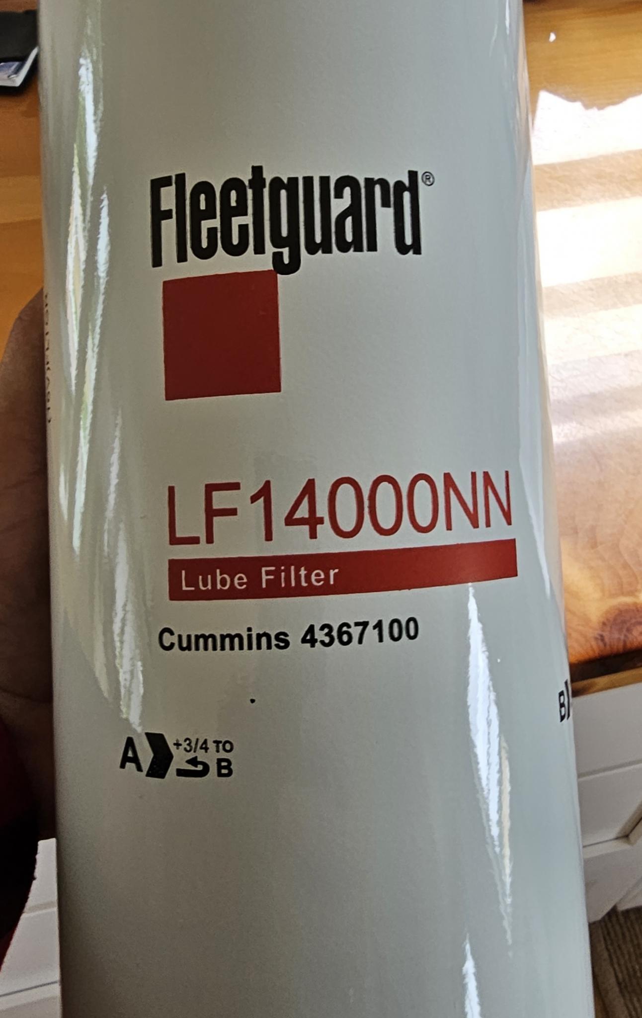

Here is the Amazon link to the LF14000NN that I also recently bought, also from the seller "Buyers Lair". The ones I received did NOT look like that, they have the normal heavy duty raised rubber seal in the top. In particular I've always purchased various quantities of the "2-pack", in case that makes a difference.

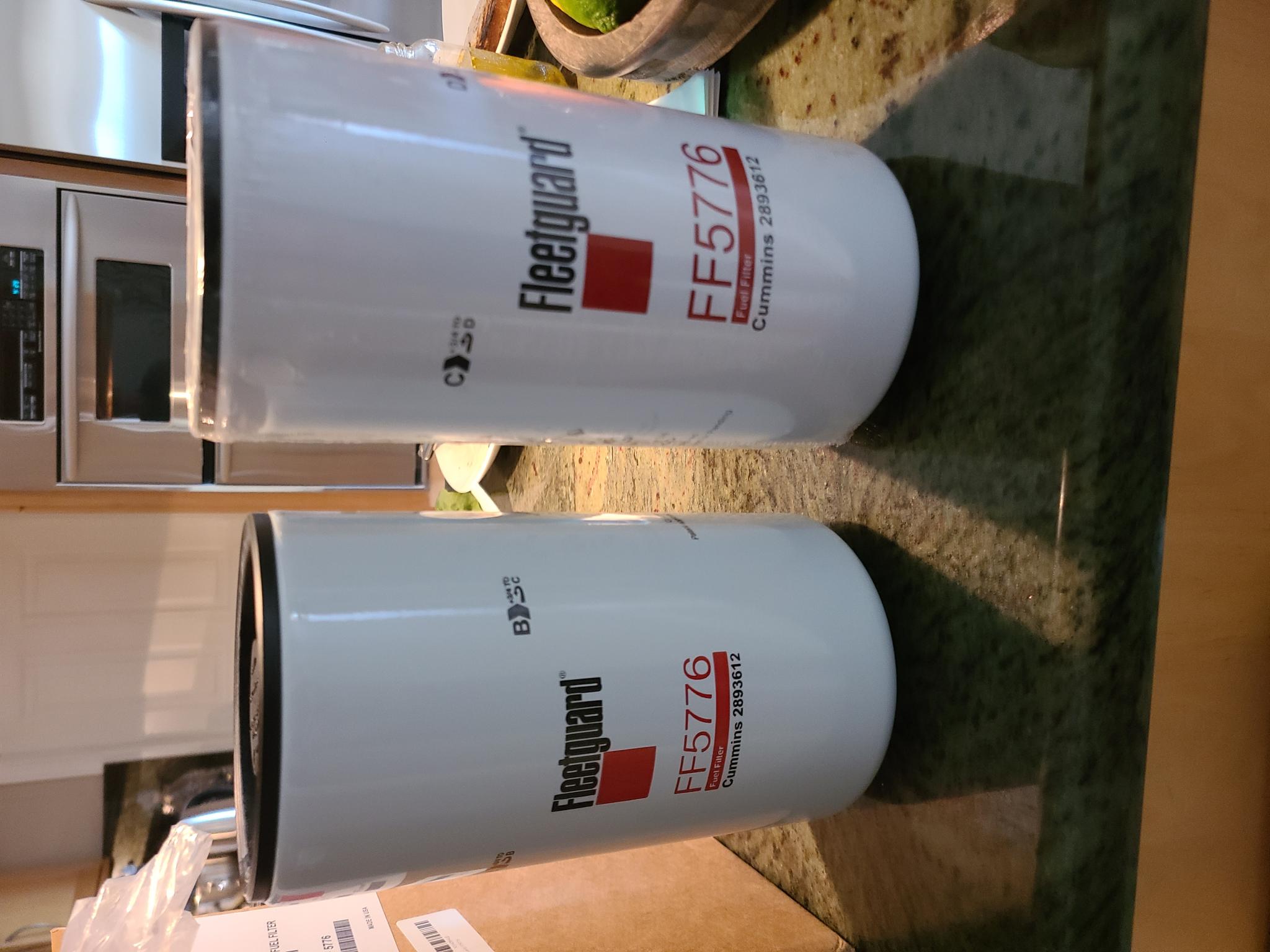

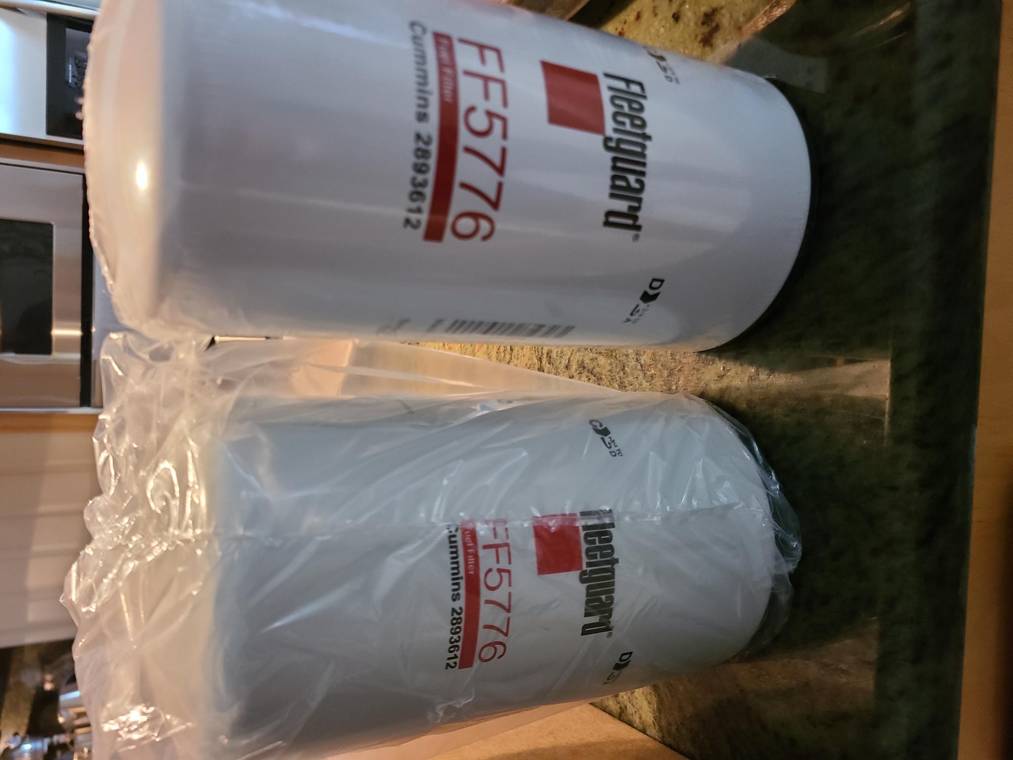

I bought 4 from local shop to compare to the last amazon purchase.. Local shop on left amazon on right. The amazon I thought was good at 1st but had no plug for filling again like the other 4 I sent back. The amazon filter is skinnier and taller and say made in USA which I thought was odd.. The local shop seem to be normal size and made in Mexico which is a shame but seem normal these days.. so buyer beware on the amazon china crap

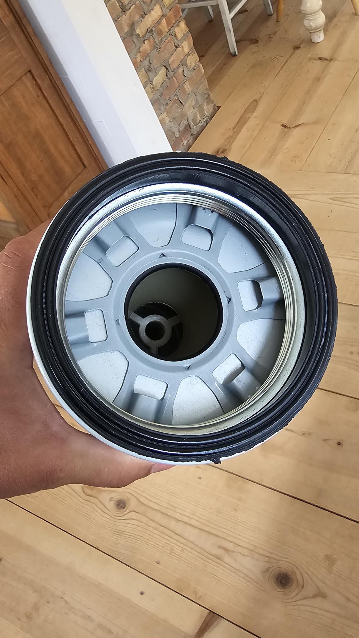

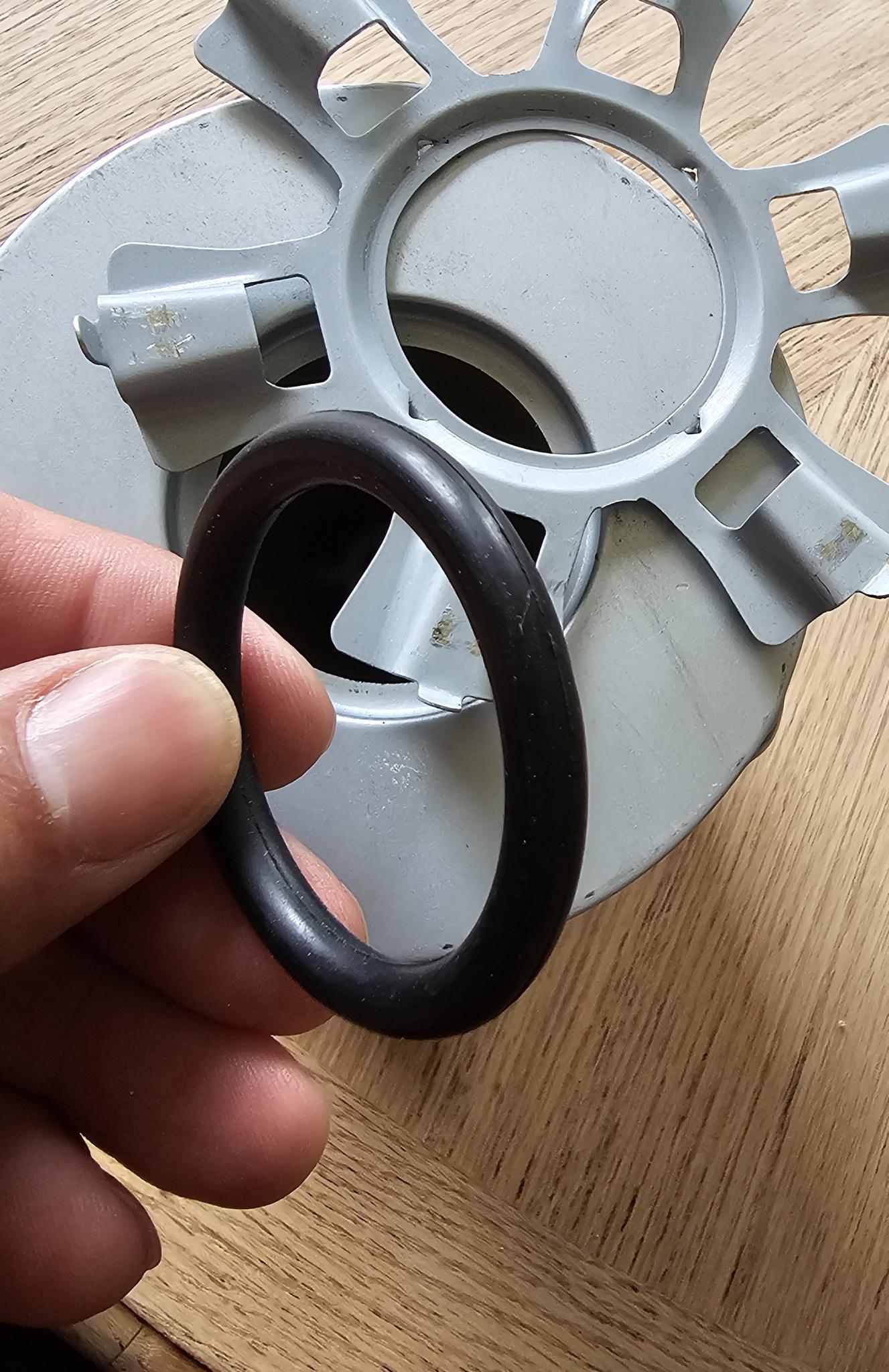

just a reminder, as this thread is getting long ...
Every actual genuine filter that I have ever gotten myself so far (I get them locally at stealers$it), had that expensive rubber flapper in the top end to prevent o-ring from getting sucked into engine, as shown in this pic...
