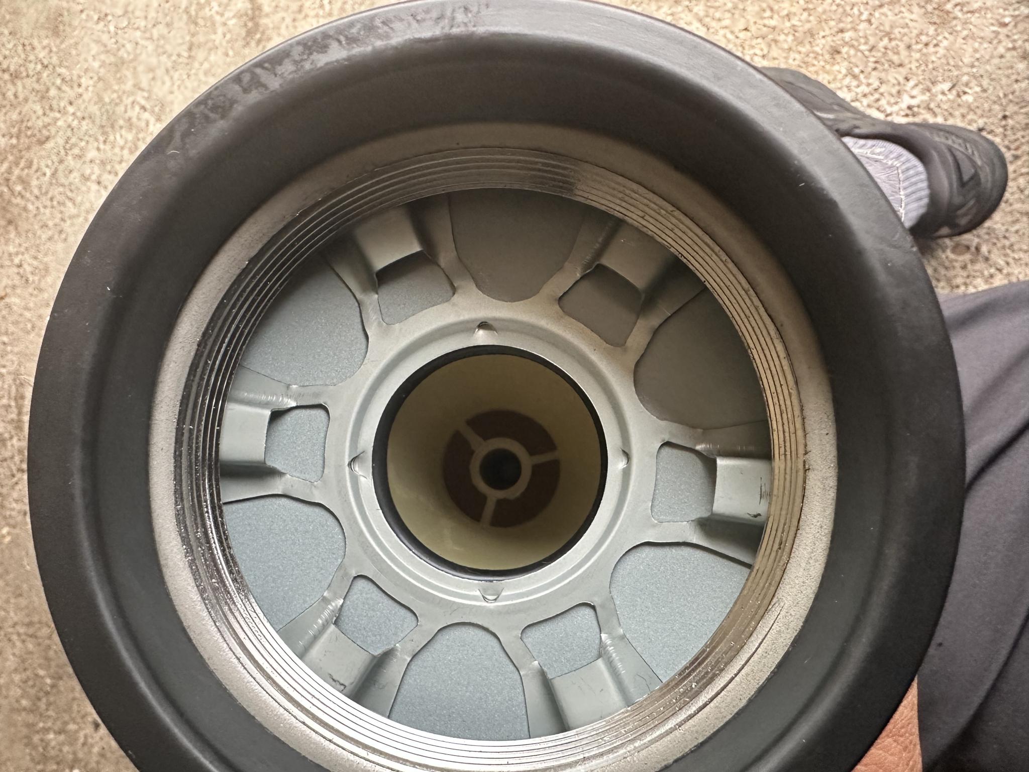

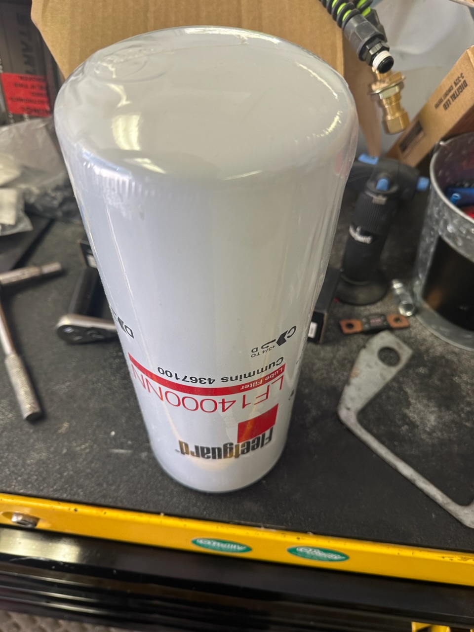

I wanted to know’ if These are the new normal LF1400NN Oil filter?
I normally order from a supplier on Amazon and get half dozen!
I’m suspicious these are Chinesium knockoffs.

Total pic
09-26-2023, (Subject: Amazon’ Fleetguard LF1400NN )
RE: Amazon’ Fleetguard LF1400NN
That looks like a chineesium knock-off with that VERY DANGEROUS o-ring in the center like that.
I would not use them if I were you.. and I sure HOPE LIKE ALL HE#LELL that the red engine maker themselves did not change that design in the center like that.. because that is a serious lawsuit waiting for them!.

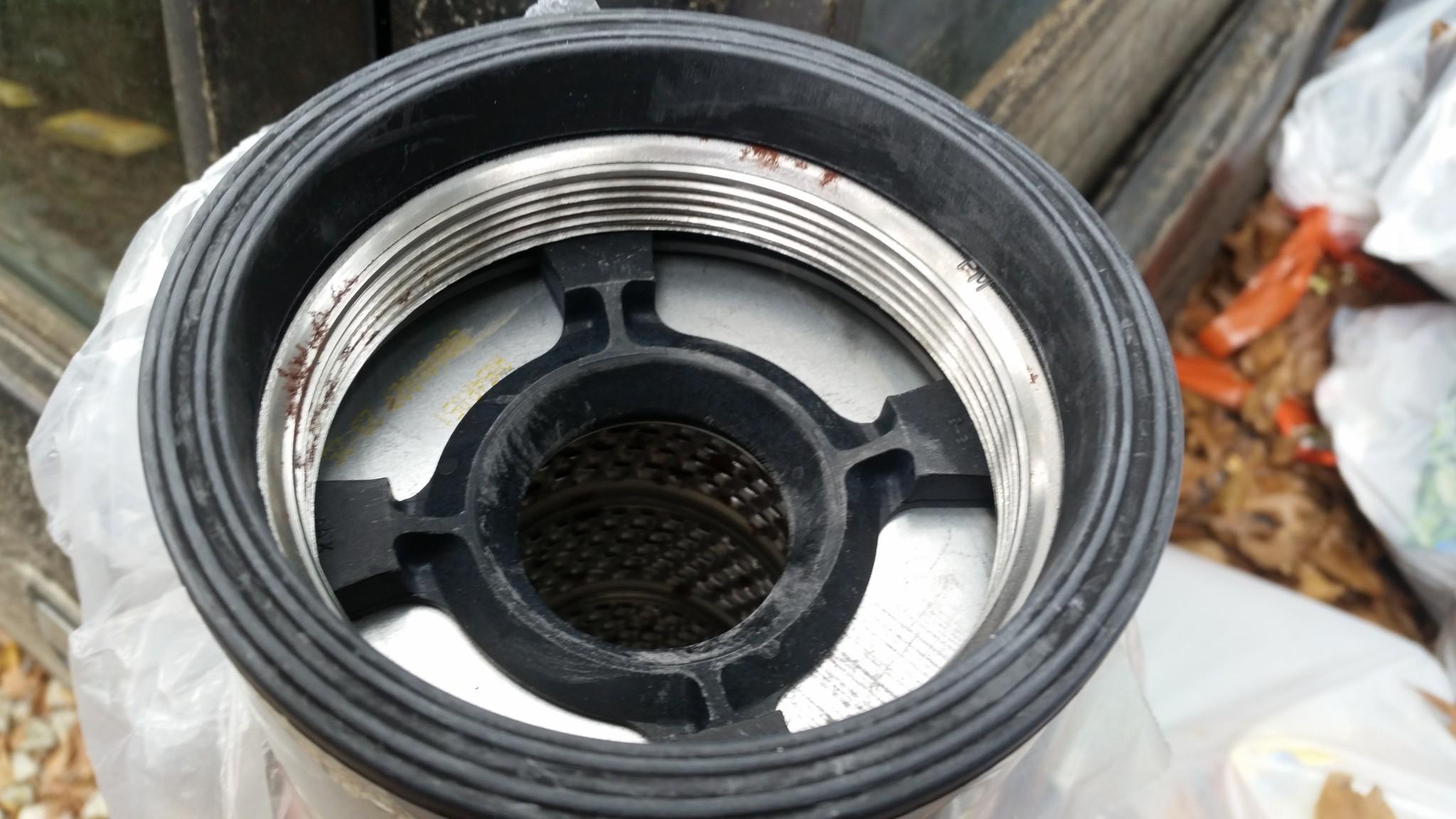

here is what it should look like...
and for those who do not know what we are discussing here...
I saw those same ones awhile back. The coloring was a hair off and the upper seal (from the side profile pic) appeared thicker. Didn't bother going any further...had a feeling the important part would be altered as well. Yeaaa....def return that $hit!

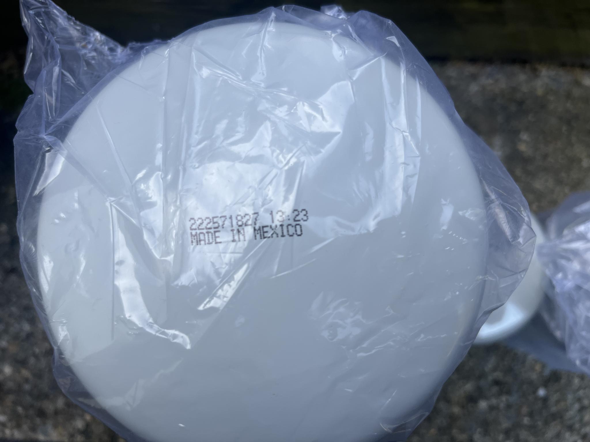

Someone correct me if I’m wrong. But I think all genuine filters will have this stamped info on the bottom.

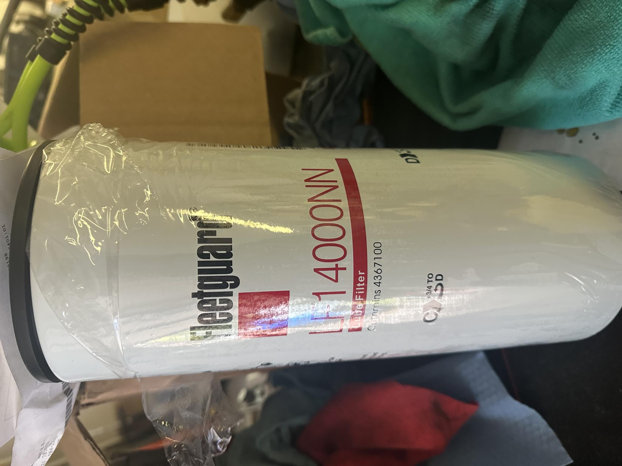

Pd6cas2 - It's the 'Cummins Filtration' you have to look for as the brand name on Amazon. I think many of the knockoffs didn't have that listed as the brand. Also, the part number on the filter wasn't printed as bold as the real deal.
 Thanks given by: JMBT , Pd6cas2
09-27-2023, (Subject: Amazon’ Fleetguard LF1400NN )
I noticed right away the name painted on filters graphic we’re off!
I already returned them for a refund.

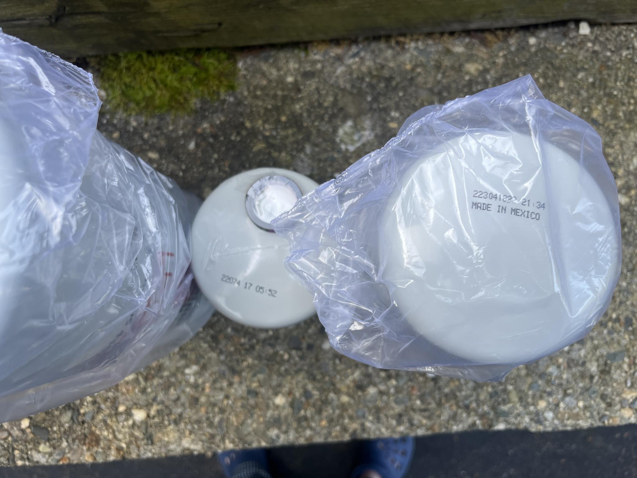

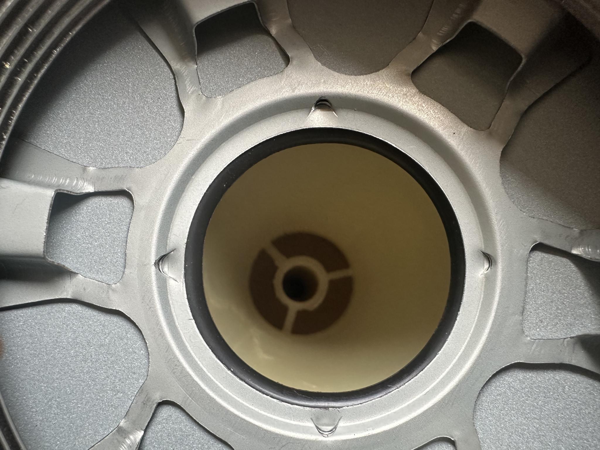

I re ordered from another supplier on Internet and here’s my new order.
Something is wrong they look 80% legit …
Biggest flaw Inside filter media has an extra plastic
Made In America instead of Mexic[/u]o
No serial numbers bottom of filter.
