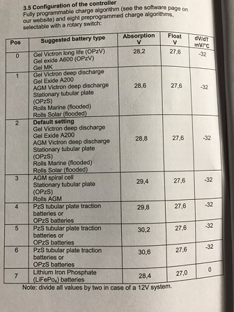

RE: Battery's All of you fellas planing to use AGM battery on truck, keep in mind that they have different charging characteristics.The truck charging system dos not provide optimal voltage for all charging stages,especially floating stage.Most of them required 14,6+Volts. My OEM Volvo AGM battery last only 3 winters.If you want to get the best of your batteries, consider additional charger capable to provide proper stage charging. Just my opinion. Some Idea below. | |||

RE: Battery's (01-29-2017 )mmssvv Wrote: ... Not sure about that statement. Maybe post a reference to more info from battery maker? Mine hold up just fine. My alternator peaks at 13.9 v and my inverter/charger cycles spikes them to 14.1 when plugged in, then settles out at 13.2 volts for long term charge. User's Signature: ->: What I post is just my own thoughts and Opinions! --- I AM Full Of S__T!. | |||

RE: Battery's (01-30-2017 )Rawze Wrote:(01-29-2017 )mmssvv Wrote: ... I believe some AGM batteries recommend a charge profile for maximum cycles, at the very least you should be maintaining 14.1 volts. At least the batteries I run this is what the manufacturer recommends for Odyssey batteries https://www.google.ca/url?sa=t&source=we...nF4sMOYcNQ | |||

RE: Battery's (01-30-2017 )Rawze Wrote:(01-29-2017 )mmssvv Wrote: ... Sorry,my bad!Wrong memory, number is 14,3V in Bulk and Absorption.My truck provide only 13,9v charging voltage and those 0,4-0,3V are still in big play for the battery life.3 years are very low life for AGM Batt. in my opinion. Below is the charging chart from my OEM inverter XANTREX for references. Thank You for the correction. ![]() Second one is from my solar controller VICTRON Energy BlueSolar MPPT 100/30 ![]() For 12V system divide by 2 | |||
