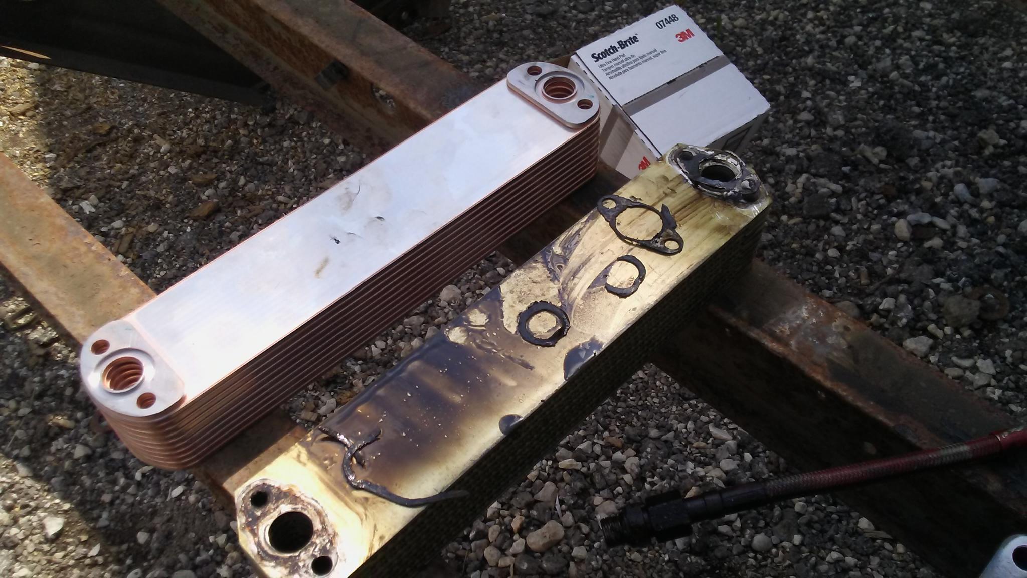

there was no gasket in the box with oil cooler, have measured old one with new one and new one is slightly thinner,
old one gas bottom/side where meets plain , new one is extended
need a gasket there, right?
have it figured out,there were two orings in the bag from the dealer
