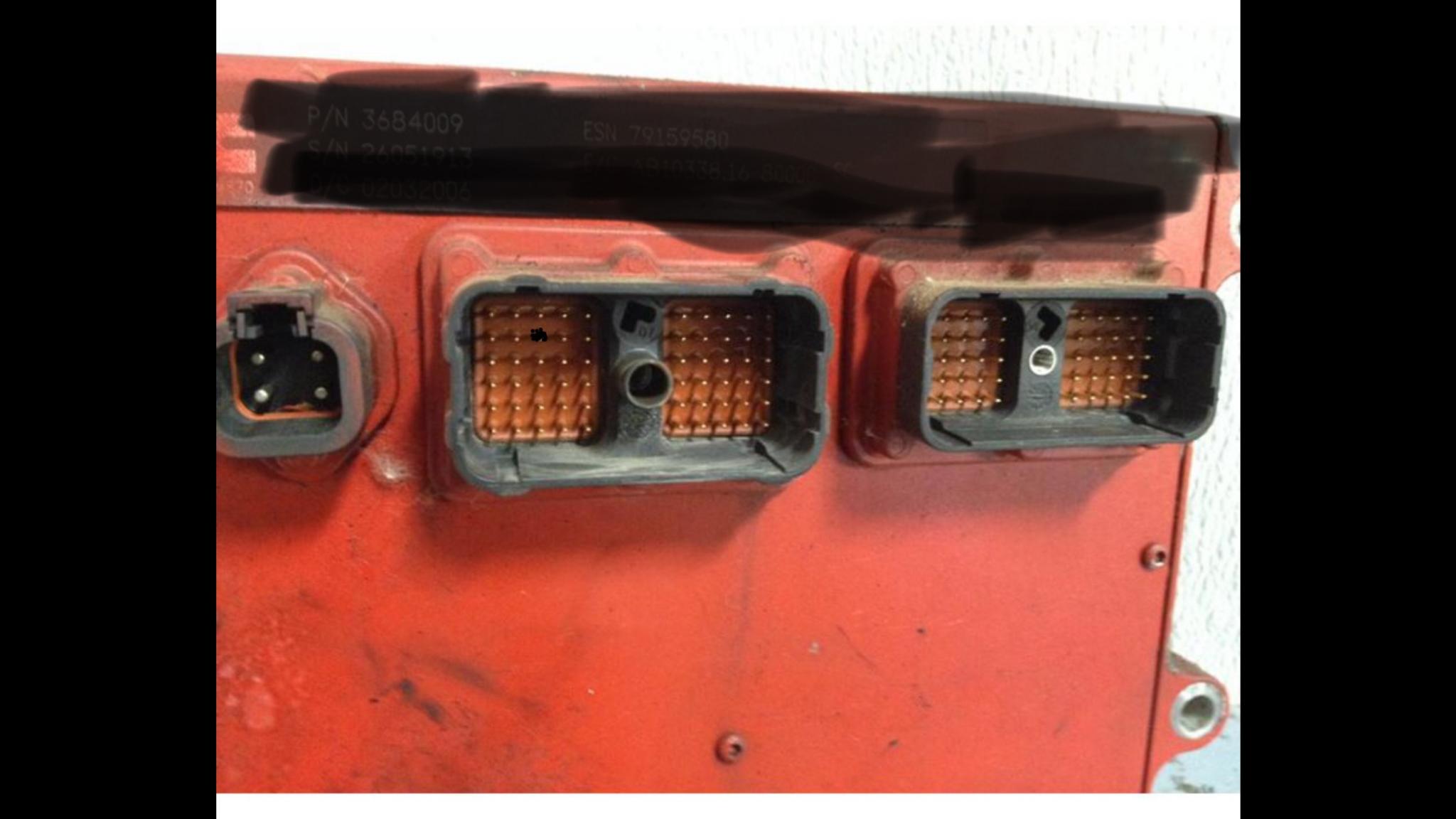

What pin is this?
   Anyone knows the pin number 13 of engine pins that goes to ECM?
I attached a picture and marked the pin for clarity?

It's pin 13 engine plug. IMAP temperature sensor signal.

(02-07-2018 )snailexpress Wrote:  It's pin 13 engine plug. IMAP temperature sensor signal.
I stand corrected, sorry I missed the OEM side and Cummins side.
Like an eager over-achiever, I just looked at left side of ECM, so left side of diagram, hide the crayons, I can't color inside the lines...
I don't want to give bad info, so I deleted my posts, thanks for pickin up my slack snailexpress

On the EOM side pin number 13 goes to inside the cab just behind the steering column and I found out it is not connected to anything.
Could be that the reason of shutting down the engine?
