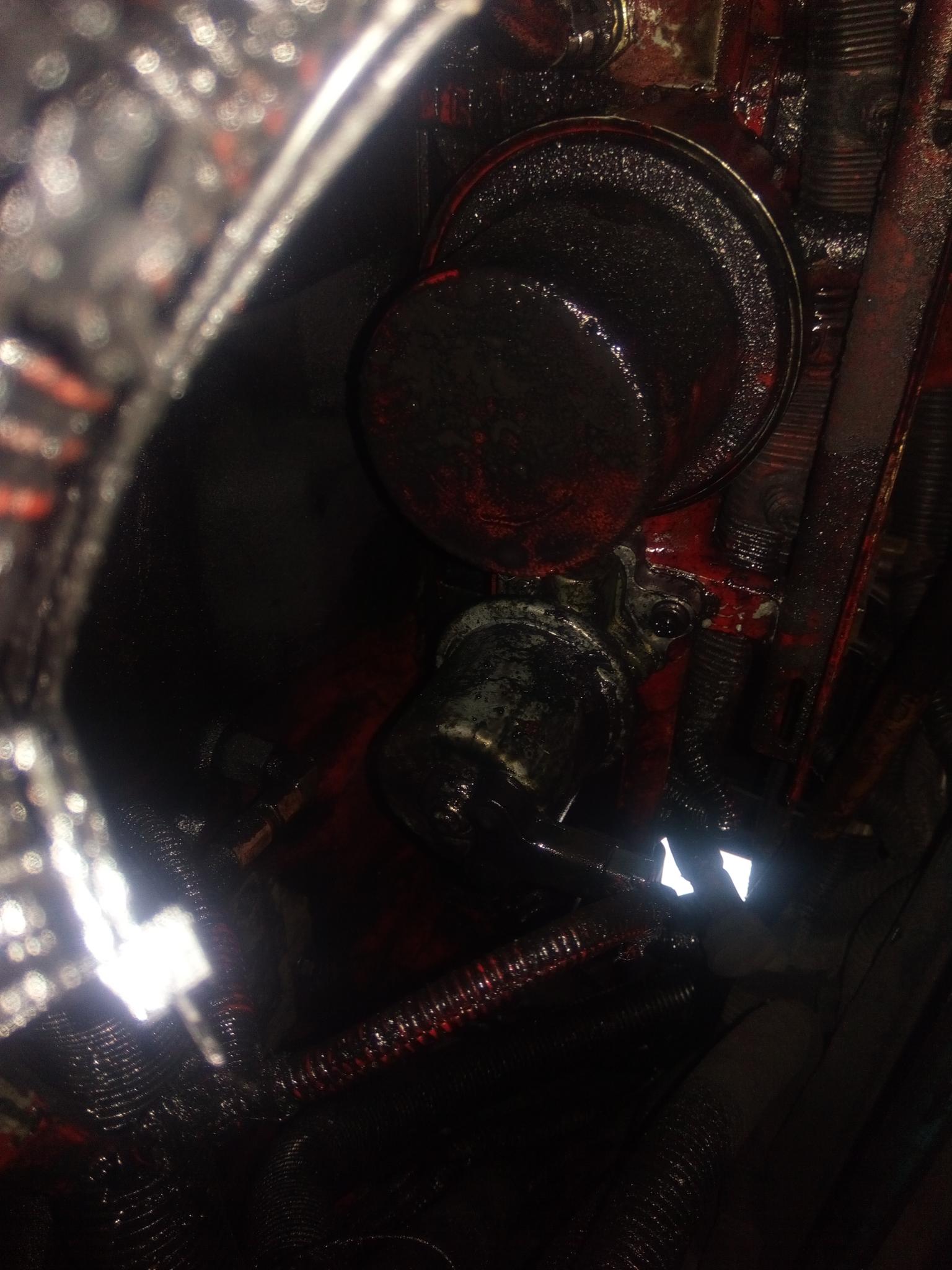

My apologies as I'm having to learn some of this terms used in trucking , at idle the pressure is 268kpa the fuel usage is stop and go what would be the ideal consumption the driver sent me a pic of a diesel leak on the diaphragm on the inlet side of the engine today , by water I meant coolant.

That is...well I’m speechless. It needs to be cleaned and fixed ASAP. You’re never going to find the leak with it that wet.

Leak or not, That is the nastiest looking engine I have seen in a while -- I would suggest a power-wash and some basic TLC too. Those photos point towards a seriously neglected piece of equipment. If you would have showed up over here at my house with it that nasty and neglected, I would have run you off to go get it power-washed and steam cleaned first.

S53S , I’m puzzled. First you wrote oil pressure at 265kpa max and now you said 268kpa at idle . That can’t be possible , unless oil sensor or oil gauge gives a false information.
This nasty thing on picture looks more like an oil than fuel . Either case is in desperate need to be cleaned. Smear some on paper and see what it smells like.

Thank you Wiseman I will confirm the readings again via pics, @ Rawze all comments received with gratitude I wash the engine every week when the truck comes back using a 250bar pressure washer myself , I sent the pic to show you the leak, I came on the forum for help because the leaks are irritating me being a first time owner I don't expect sympathy though lol! The stuff does smells like diesel. I really wish I could send the engine there or get a recon , I'm sure I'll get all the help I can from this platform thank you guys!
