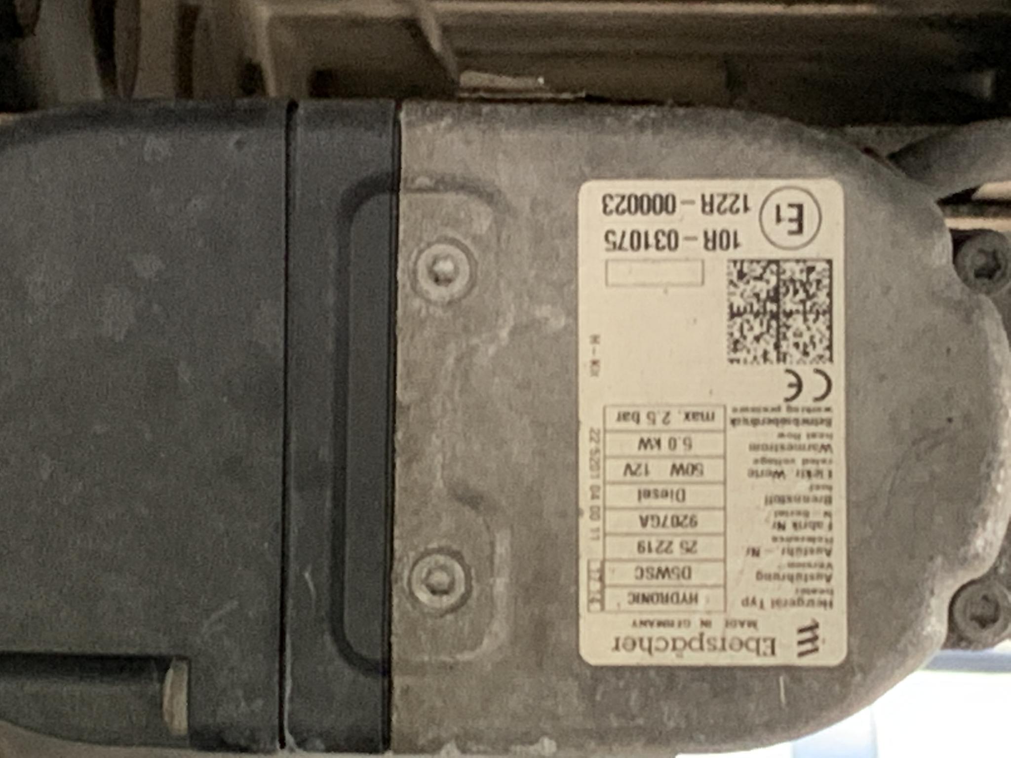

So I get to post in the international section now. I’m bad.... so electric factory apu I’ve been reading around the internet seem like a pattern is developing here. Bunk heat seems to quit working. Fan blows but no heat. It looks like it’s heating water for heater and engine. I’m liking that concept. It’s trying to run. Makes some kind of cycle then stops. I’ve cycle it a bunch. Like maybe 20 times. Smell fuel a little but no fire. Is the a igniter or something. Any information on this system is helpful.

try to start it a few times. but it probly needs the screen by the glowplug replaced also check for a fuel filter on the suction side of the pump where a nut connects to it. if thats not it then either needs burn chamber or diagnosed via a computer hookup.

So I got the bunk heat working. I had to remove the heater and take it apart. The burner blower was stuck from just sitting a lot. Lubed it up with some Howe’s spray. I love that stuff. Assembled it and put it on. Had a hard time starting but a heat gun and a couple wackes on the thing got it going. Now I’m wondering how to get my auto start to work. I turn off the truck and hit the switch and no green light. I don’t know anything about this system so any ideas would help.
