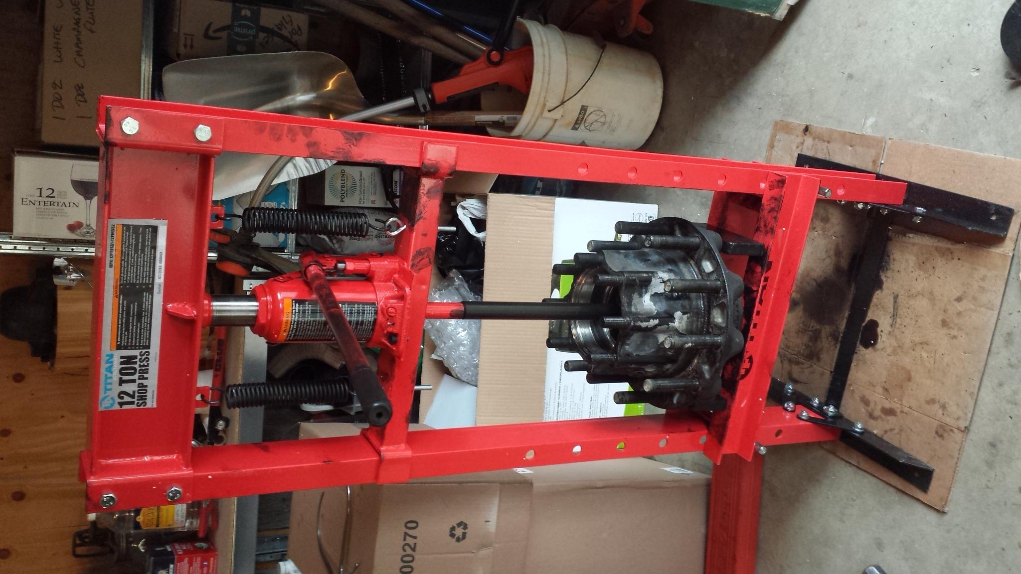

RE: Hub bearing adjustment w/dial indicator I made my own with a bottle jack and some plate steel and small "i" beams. Just remember to clean thoroughly the hub and races after pressing them in. Aluminum flakes have tendency to come off the hub while pressing the in. | |||

RE: Hub bearing adjustment w/dial indicator Did the rear hubs with preset bearings. They were all loose. Ride is much better now. No more wobble. Used a 12 ton press. Still ran a weld around the large cup to remove. Bought an otc 3 finger tool that was good to drive out the cups straight. Titan 12 Ton Hydraulic Shop Floor Press H Frame 24000 lb w/ Heavy Duty Steel Plates https://amzn.to/2PLgeMO OTC 7180 Universal Bearing Cup Installer https://amzn.to/2Vhoz17 PMD Products 19 Piece Jumbo Large Bearing Bushing Seal Disc Driver Tool Set 2-3/4 inch to 6 inch https://amzn.to/2Y0XHz5 User's Signature: 2011 Prostar Cummins 871 | |||
