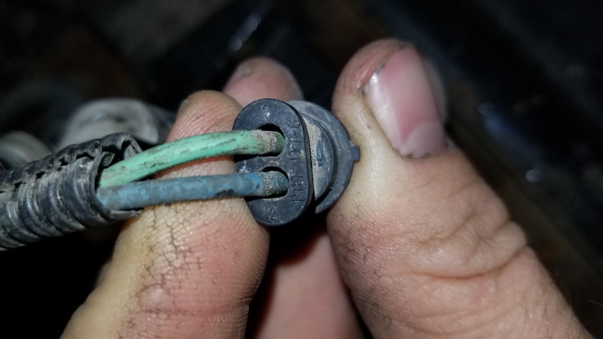

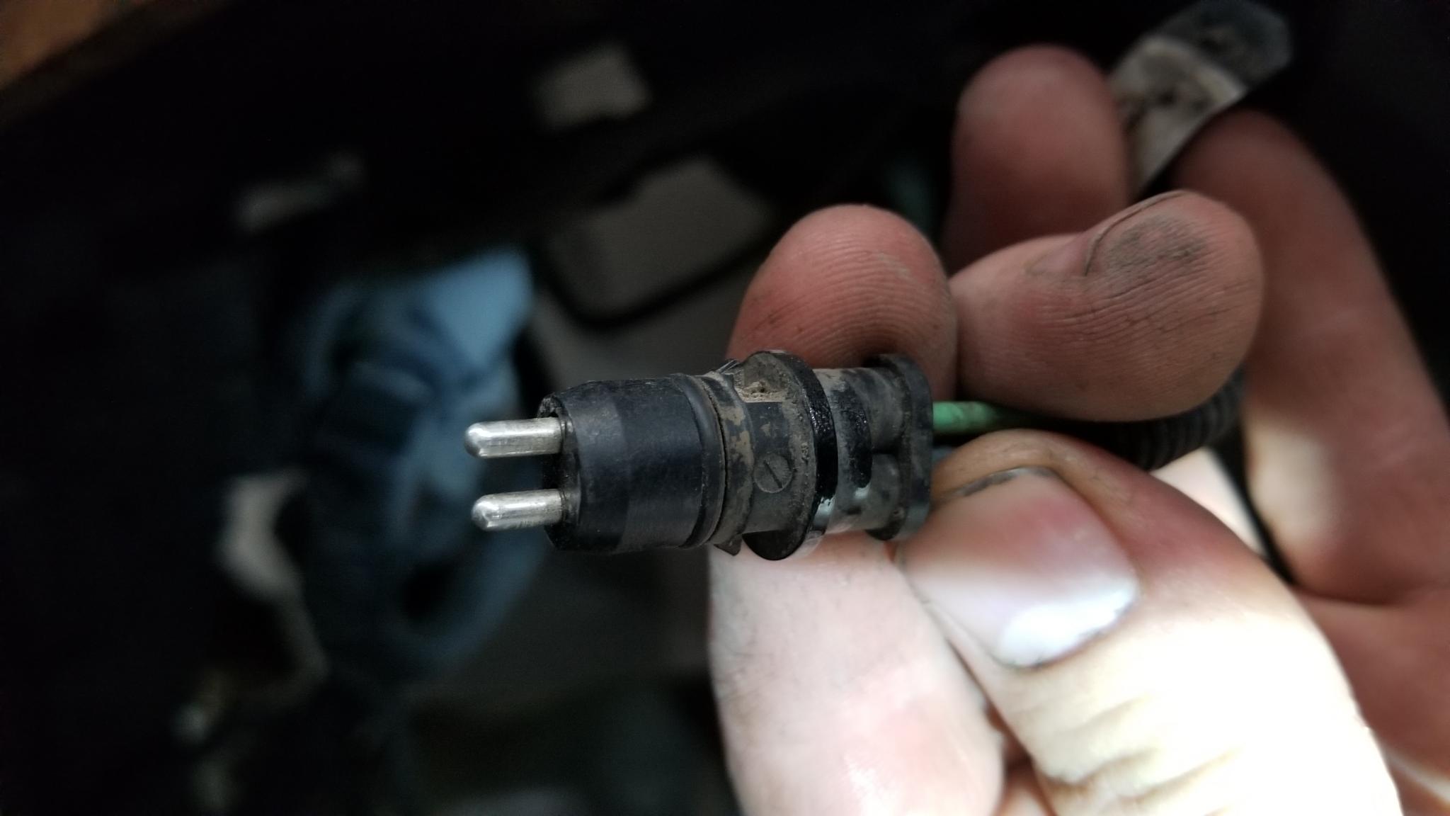

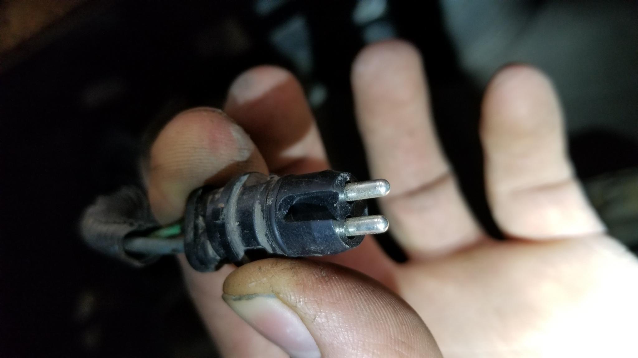

(10-23-2021 )Chamberpains Wrote:  Take a picture of the connector your talking about and post it here. We've found quite a few original manufacturers amd aftermarket manufacturers of some strange plugs before. I believe we'll be able to find you something that will work.
Hare are some pic's. the back of the shell has says APE-P2P on one side and PBT ITT-C on the other side.

10-23-2021, (Subject: ABS Sensor connector )
RE: ABS Sensor connector
ITT-C stands for ITT Cannon connector.
You can look parts here https://www.ittcannon.com/products/sure-seal/
