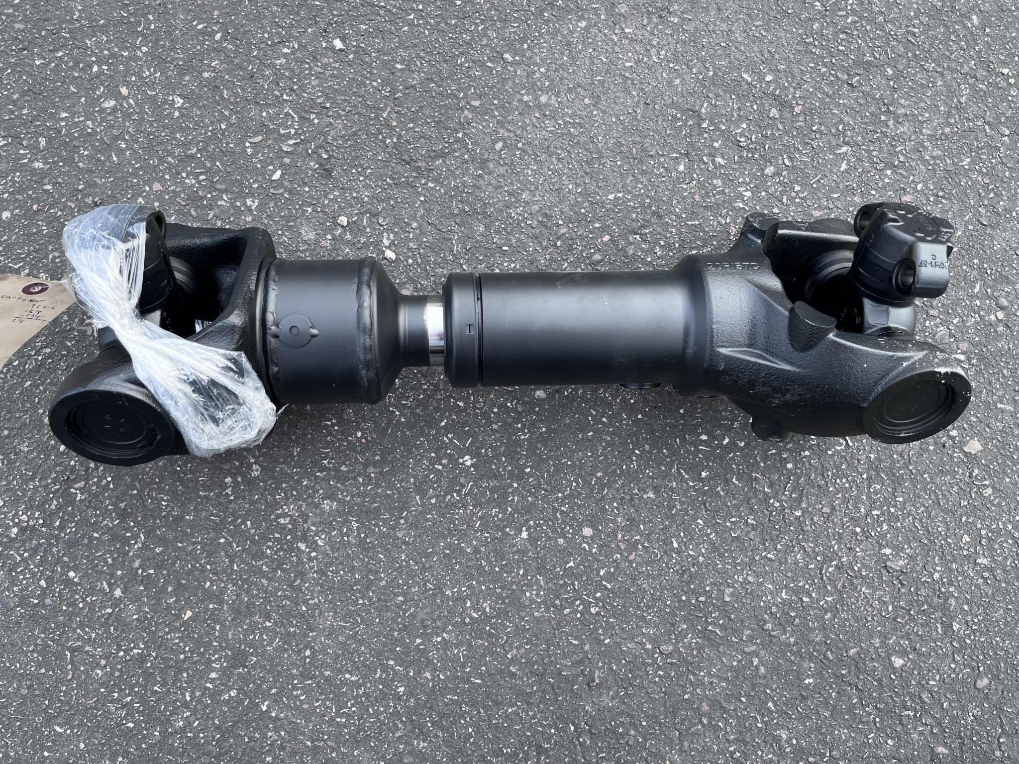

What have you guys been charged for driveshaft replacement/rebuild on your trucks? I needed my intermediate shaft replaced on my semi from spline wear and I’m getting $1300 for a brand new balanced driveshaft with OEM Spicer yokes. I am just wondering if that’s an outrageous cost before I go and pick it up in the morning…

Ok, to update this thread the total cost after tax was $1338 for a MERITOR driveshaft.... They shop does have a very good reputation and I feel they did a good job with the driveshaft and communication. I needed to also "rebuild" my output shaft as everybody was 2 weeks out with a new one and needed to be patient with pressing in the new bearings along with shimming them within a very small tolerance. It was a good challenge for myself over thanksgiving break as I also finally slowed myself down quite a bit. It is always good to take a long break from trucking as it helps tremendously with refocusing on what you are doing and trying to achieve! Thank you to all who chimed in!

Question, so thanks the horribly shitty winter and not doing my proper full pre trip for sometime I came across my seal on mid driveshaft (photo in above post) had popped off allowing whatever to get into it.
I took the drive shaft off to clean the inside of dirt, gunk, grime and with that being said I have everything cleaned up and ready to put back together and I am curious on how much grease that I need to put into the splined shaft tube? I figured enough to where the grease pushes out the splines when the two units are put back together with the seal not popped on?
FYI this is a Meritor permalube RPL style shaft. The service manual for Meritor does not explain anything on lubing this style.
