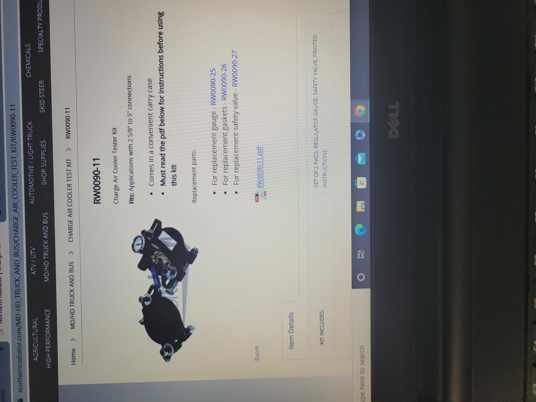

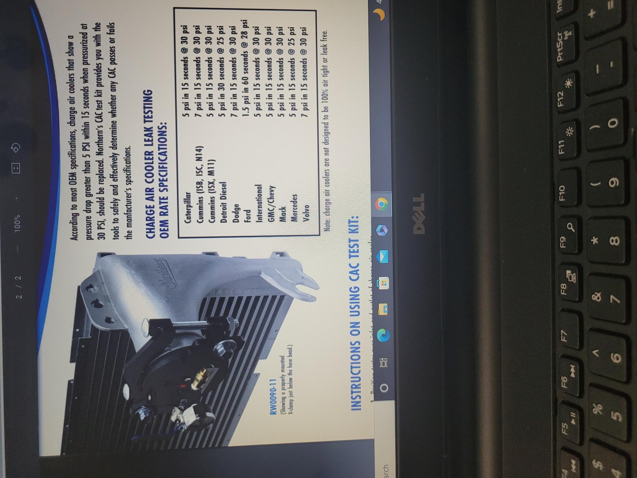

While looking around Northern website I came across the following.
 Thanks given by: Pd6cas2
05-06-2023, (Subject: Radiator conversion )
RE: Radiator conversion
(05-06-2023 )amermextrucker Wrote:  While looking around Northern website I came across the following.
I am surprised at how much stricter Ford is on a leaking cac
