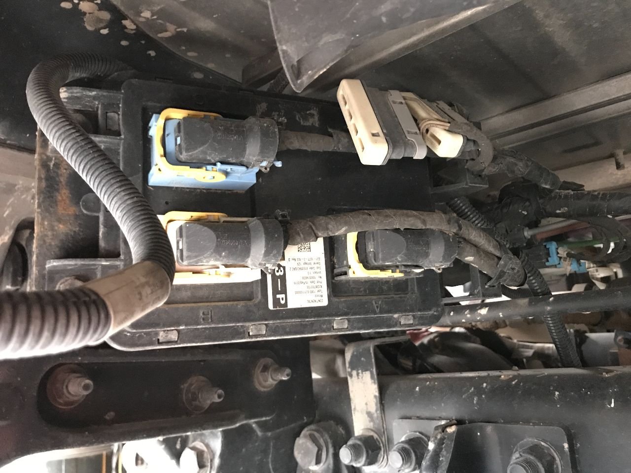

RE: 2010 KW possible bad cecu ![]() For those wondering about the location of a chassis Node on a KW User's Signature: It's hard to win an argument with a smart person, but it's damn near impossible to win an argument with a stupid person | |||

RE: 2010 KW possible bad cecu (06-22-2025 )Btech Wrote: No chassis node on a 2010, they were introduced for model year 2012 iirc. I did take dash apart.but didn't see anything obviously chaffed or rubbed through.since the last 3 years of owning the truck,My tach has never really worked properly, speedometer also acts up sometimes.the digital display sometimes freezes and comes back after the truck has been of for 15 minutes.this latest issue started since we got some heavy rains and water dripped on top of dash from the windshield not being sealed properly..my windshield guy was having a problem working around the visor and left a small spot without silicone. Since the water dripping on the dash , sometimes I step on the brakes and blinker comes on , or washer functions comes on , like they were being powered at the same time | |||
