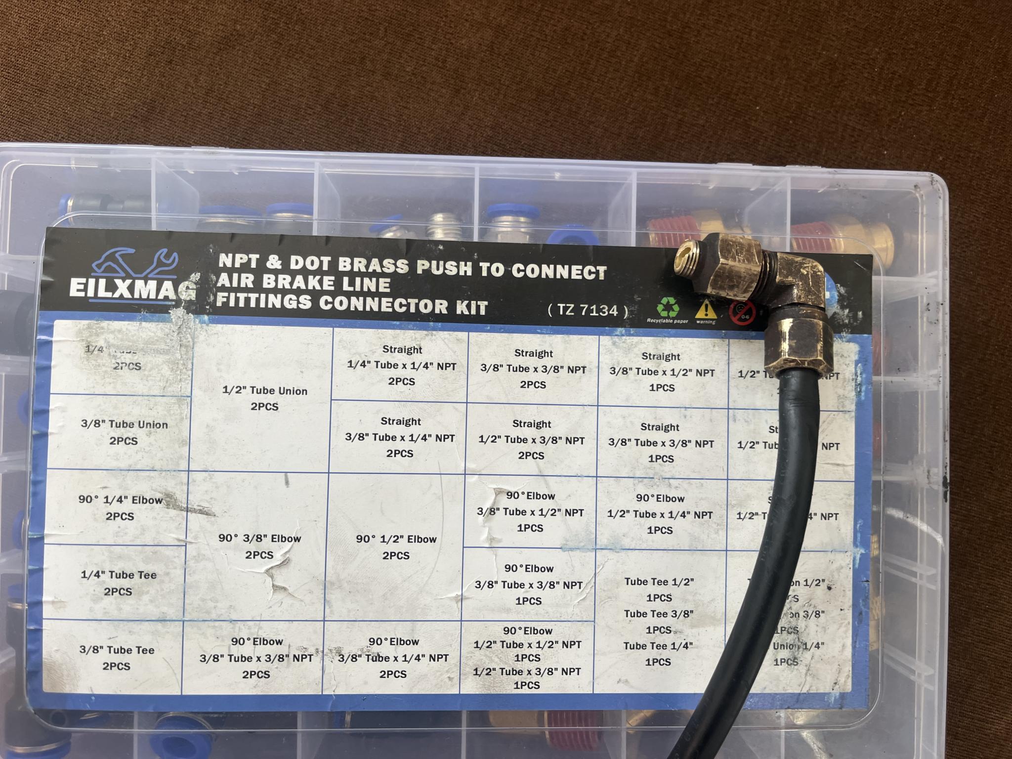

RE: Purge valve keep going off (07-03-2026 )hookliftpete Wrote: Is the governor part of the dryer or located separately? It sounds like a bad governor. The governor is on the compressor . Bought a brand new bendix one, Have it for about two weeks in the truck but didn’t want to mess with it until I get home. Now I’m home for the holiday weekend decided to change it this morning and the Damn threaded end broke in the old governor. The quick connect was old and stuck didn’t want to release. Decided to pull the connected end and it broke. I have an assortment of 90’ quick fittings but the size I want is not in there. Ofcourse everywhere is closed today so that’s now a Monday job. 15 minutes job turns into a whole weekend lol. That’s why I avoid messing with things on the truck if I don’t have to when over the road or under a load. | |||
