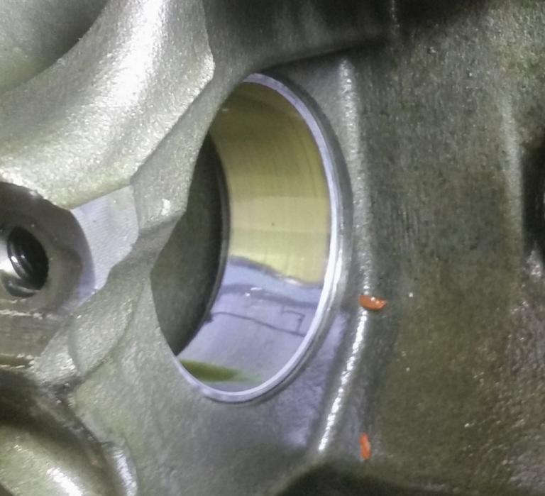

Actually, GL-5 works just fine!.... I have verified that the newer GL-5 oils are no problem and in my own engine after running mostly gl-5 (1 gallon / 12% at every oil change) in it for 955,00 miles,.. the copper components look beautiful!.
Here is some "yellow metal" form my own engine that ran gear lube GL-5 extensively. These components HAVE NOT YET BEEN CLEAN OR EVEN WIPED OFF YET!...
./uploads/201604/post_2_1461240274_a4345aff0fc3430fa80787f282e78a31.jpg
I actually only ran the GL-4 for about a year towards the end, but switched back on purpose just to see if those claims were true or not.
I don't see any etching or discoloring like that paper shows,... Only what you would normally see in any engine at that age, but a LOT less wear than expected.

(04-21-2016 )Rawze Wrote:  Actually, GL-5 works just fine!.... I have verified that the newer GL-5 oils are no problem and in my own engine after running both gl-4 and gl-5 in it for 900,00 miles,.. the copper components look beautiful!.
Got it! I did not know for sure. I know there are differences in the additive packages and how everything is now trending in regards to these new motors and new ratings on these lubricating products. It is hard to keep up with everything! Thanks for setting me straight.

Its all good my friend,.. just letting everyone know that it is nowhere near what that white paper claims.
