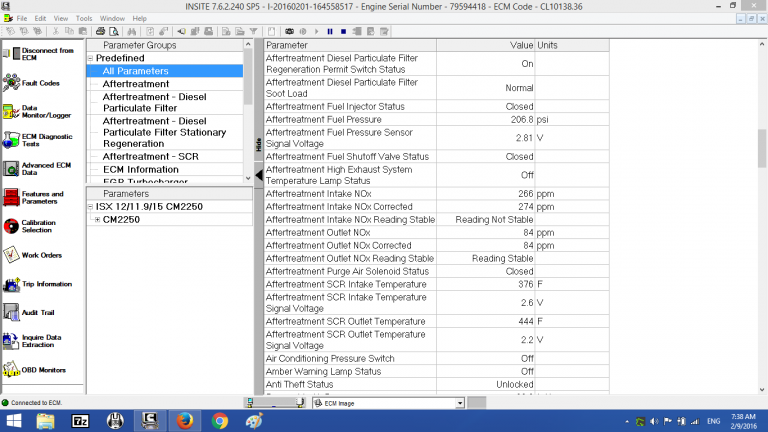

To have more information we need aftertreatment related parameters
./uploads/201611/post_1794_1479129365_c456bdc07b37afd1c92a5f6fef11129d.png
In left side where is PARAMETERS menu hit aftertreatment and run regeneration.
Insite will catch min and max then post it.

Doing a regen right now.
Is the egr valve position commanded suppose to be at 0
11-14-2016, (Subject: 2012 peterbilt 386 isx Cummins cm 2250 regen issues )
RE: 2012 peterbilt 386 isx Cummins cm 2250 regen issues
Started regen at 645pm
Outlet temp is at 988 and intake temp at 790
Catalyst at 550
And time right now is 6.35pm
