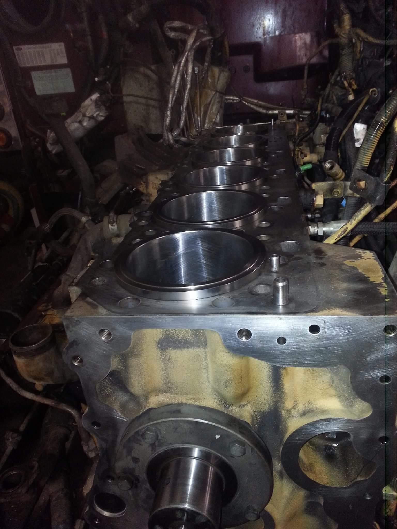

Liners and pistons are in place, removing a bunch of the unneeded junk off the sides of the motor, cleaning up and then it's time to start getting this bad boy together!
 Thanks given by: Texasdude74
