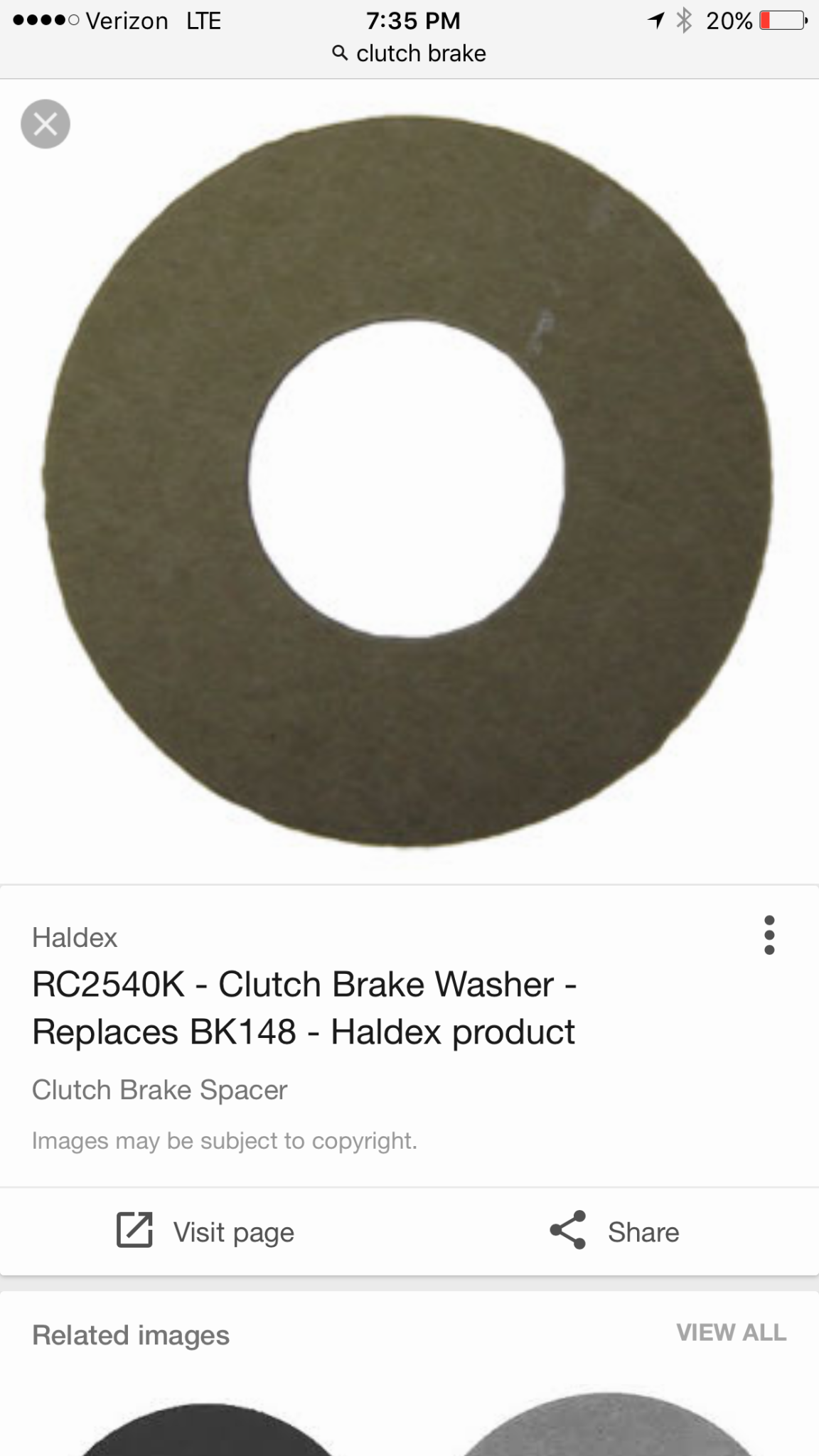

03-06-2017, (Subject: Changing clutch brakes. )
RE: Changing clutch brakes.
Cut a 1/5 of the disc and force it in front of the bad clutch brake
