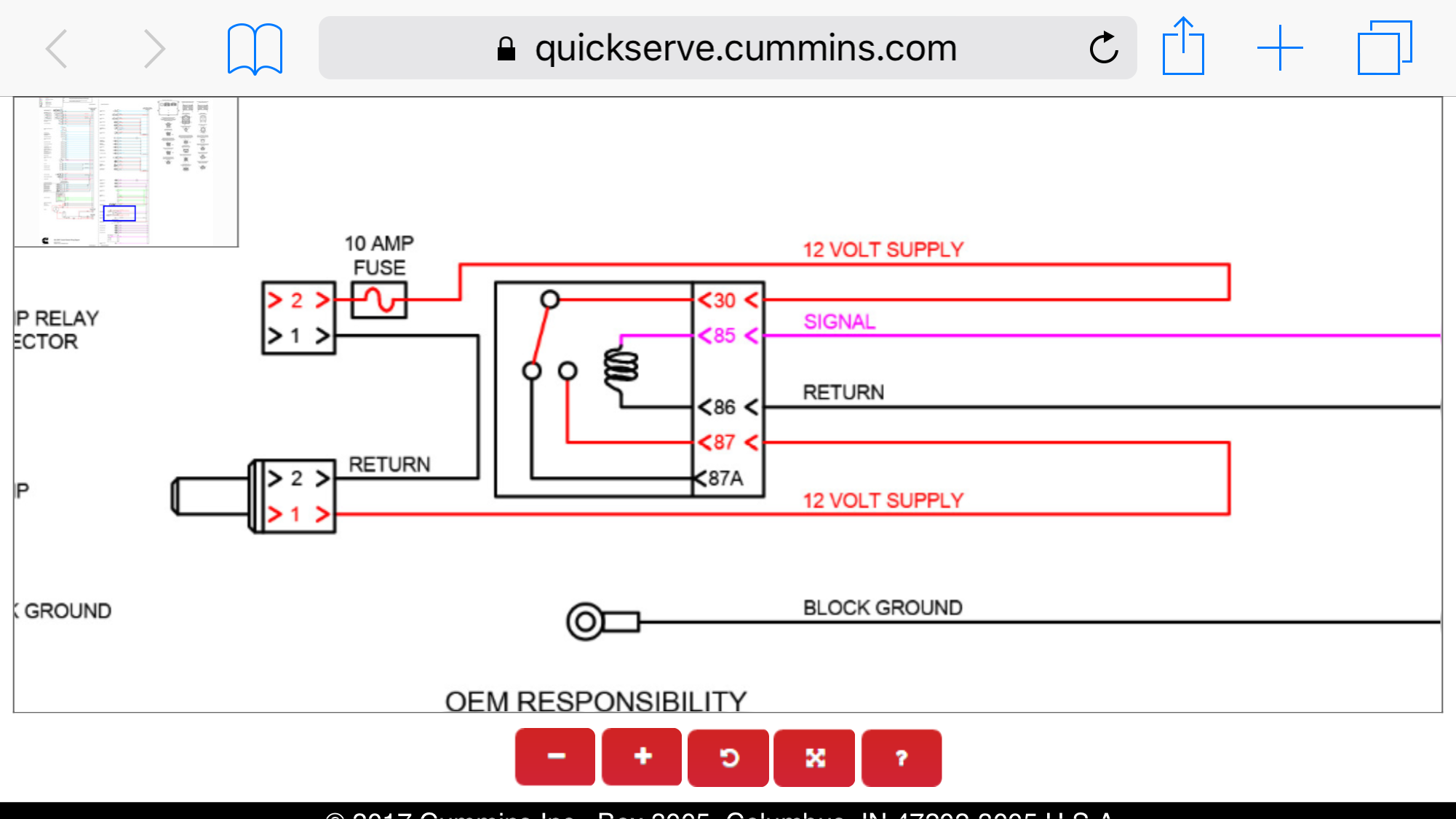

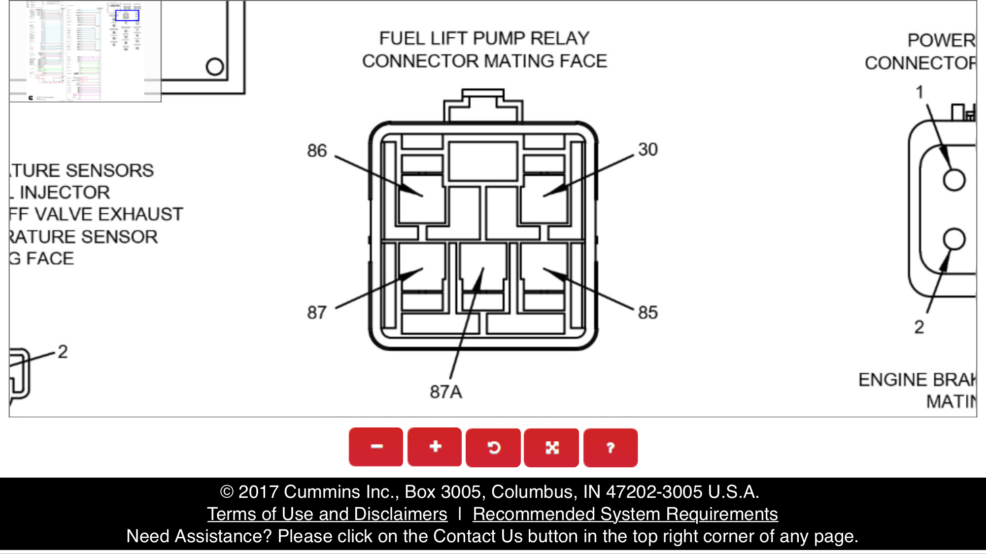

(06-13-2017 )tree98 Wrote:  I checked the wiring today, I'm getting 12V to pin 85 of the relay for about a minute after I turn the key on then it goes out. No power to any other pins. Shouldn't there be a constant 12V to one of the relay pins?
Sorry, I didn't read your post properly.
Quickserve procedure 005-045 Fuel Lift Pump for diagnostics.
Yes, there should be a "Supply Line" (constant +12v), a "Signal Line" (timed +12v), and a "Return Line" (to chassis ground). The other two are the circuit to and from the lift pump and fuse circuit itself.
If you ONLY have +12v power to pin #85, then YES you have a power supply issue. Trace and check the wiring harness for damage.
Here is the wiring diagram and the connector for you.

06-14-2017, (Subject: Possible lift pump problem??? )
Post: #22
RE: Possible lift pump problem???
So now do I just start cutting all the wire loom off the harness looking for a broken wire? Could I just run a 12V constant from the battery box and call it a day?
Post: #23
(06-14-2017 )tree98 Wrote:  So now do I just start cutting all the wire loom off the harness looking for a broken wire? Could I just run a 12V constant from the battery box and call it a day?
The loom is "split loom", or should be, so you can peel it away. Unless the loom is damaged, the likelihood of internal wire damage inside is quite low. Follow it along looking for obvious damage. The problem is probably at a plug, a bend, or a tie/securement point. Checking the cab connection would be where I would start if you don't find any external loom damage.
