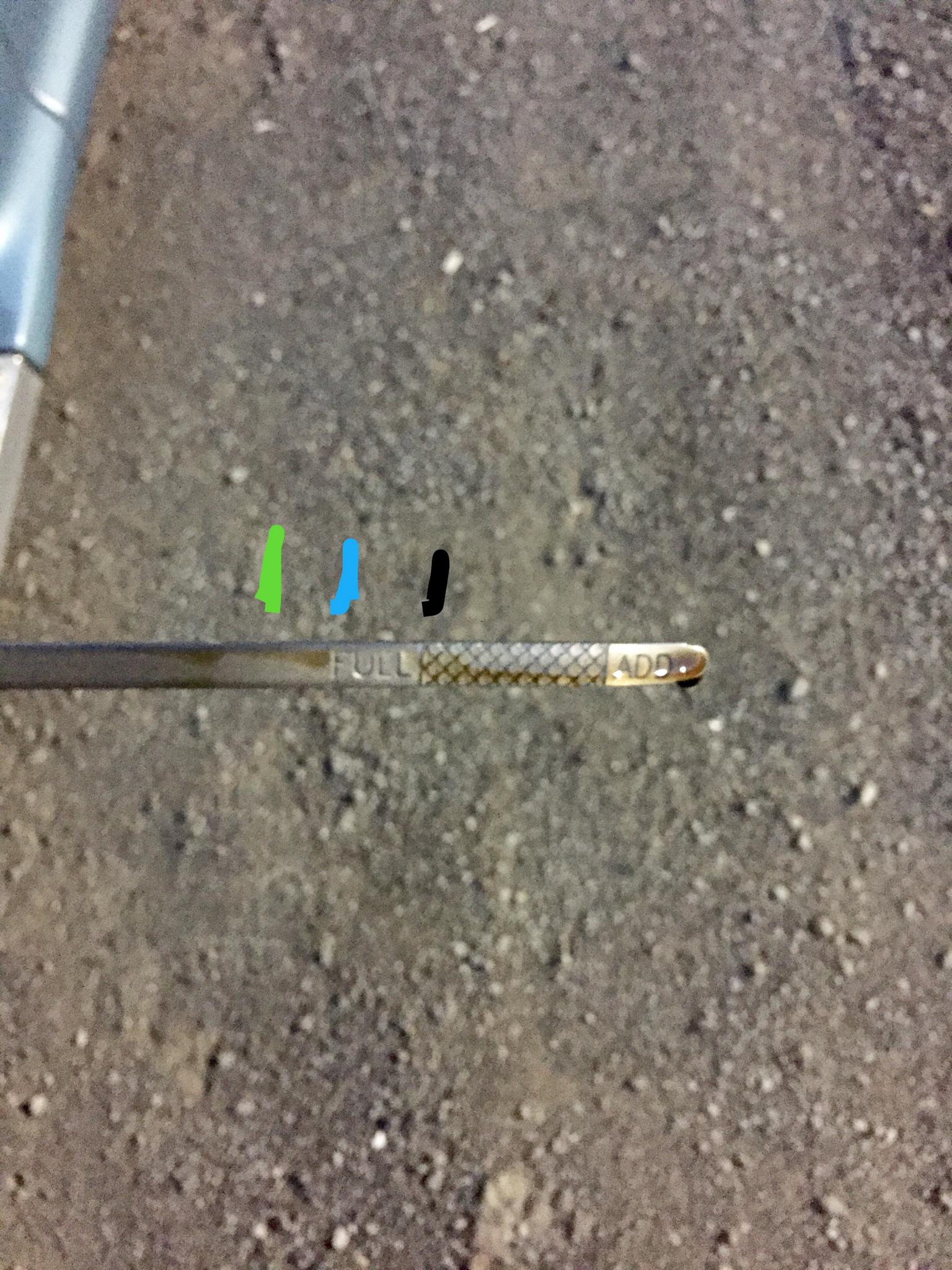

| Oil dipstick/oil capacity I have put 48 qts in before because of what the manual says, and it was at the green line. (I ended up removing a gallon, and adding it back later). I'm just wondering if perhaps the stick is a little off. I also want to see if it consumes less starting at this point. How much do others put in, and where is that on the stick? | |||

| RE: Oil dipstick/oil capacity I always have them fill mine until only the "FU" in "FULL" is dry. User's Signature: ->: What I post is just my own thoughts and Opinions! --- I AM Full Of S__T!. | |||

| RE: Oil dipstick/oil capacity On mine 44 qts brings it to the line right below full ( the black line in your picture.) However, I run mine at 42 qts, which lands smack dab between the full and add lines. It seems like mine consumes less oil like that. User's Signature: Anti-seize EVERYTHING, Except injectors...Use Petroleum Jelly!!! | |||

| RE: Oil dipstick/oil capacity I always add mine to the black mark. The old cats had issues with the dipstick so you would add a little more, volvo engine's like to push it out if you go to the full mark so I'd always put it in the middle of the hashes. User's Signature: I'm no mechanic, I'm just a guy that breaks down enough to know a bit. | |||

| RE: Oil dipstick/oil capacity I have them put 40 qts in and my gallon of Sta-Lube. One thing I notice is that the motor holds back at least a gallon+ until everything drains into the pan overnight. I just stick with what Cummins says in regards to capacity. | |||

RE: Oil dipstick/oil capacity (09-01-2017 )Waterloo Wrote: I have them put 40 qts in and my gallon of Sta-Lube. One thing I notice is that the motor holds back at least a gallon+ until everything drains into the pan overnight. I just stick with what Cummins says in regards to capacity. Just curious where that is on your dipstick in the morning. | |||

| RE: Oil dipstick/oil capacity It is normally just about the middle of the full add mark with 44 qts in the shop, full mark in the morning. When we do the pump it up to the full line at Speedco or TA I find the oil well past the full line the next day. I have gotten under there and drained a gallon or more out a few times. I have one of the ball valve oil pan valves on the pan, so it is easy to do. Sorry, long week and I am in the beer. | |||
