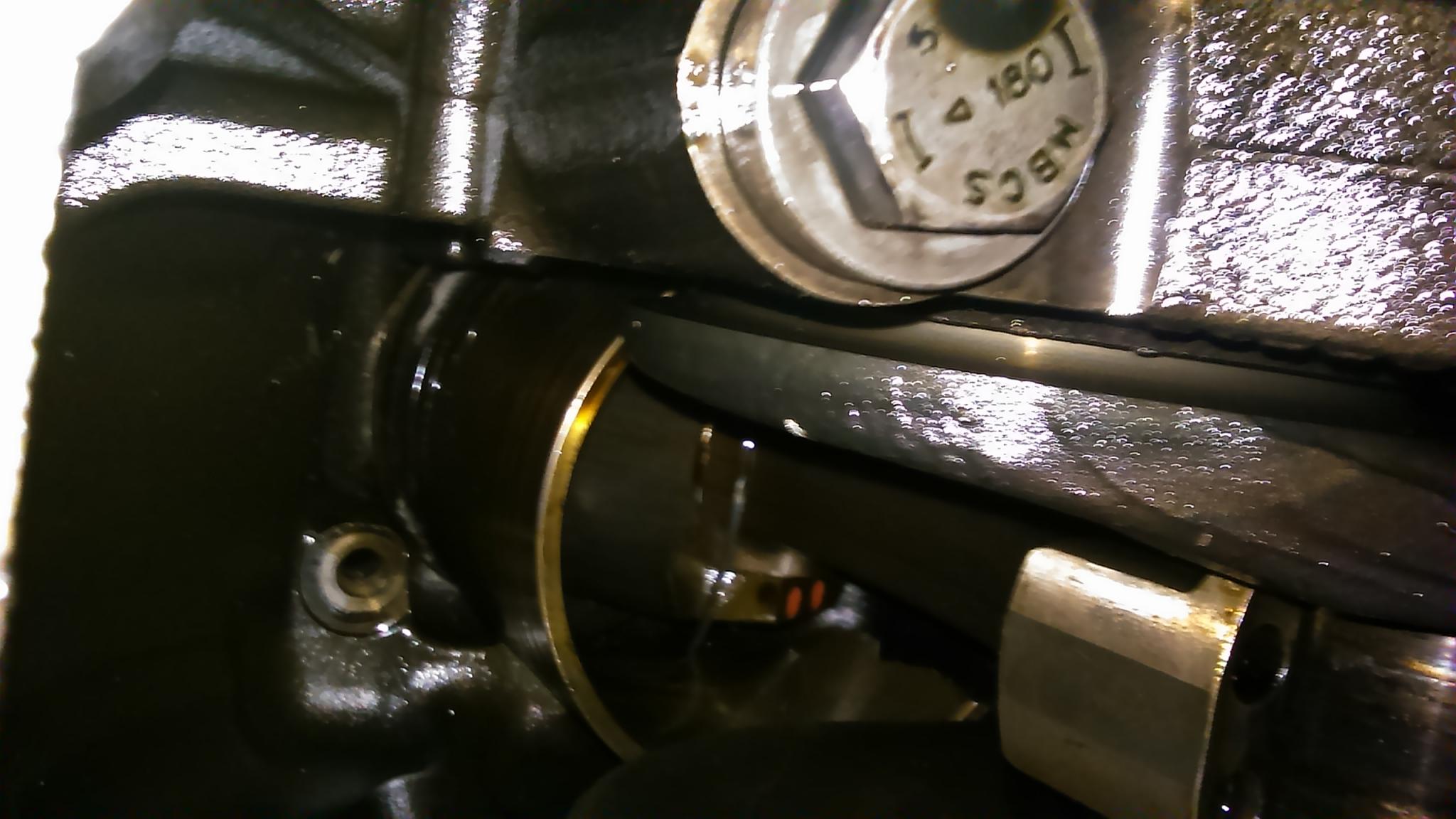

got to see a little of it today. block just off the ground. took some pics sticking phone under only one came out good but good enough to see what looks like liner busted through bottom of what looks like four thumb size tabs that bottom of liner sit on. (if that's right). there saying its not a recon,and that its a new engine no rx number. rating plate very small and most every stamp is NA (horsepower) ect. would upload pic i have, but dont know how.

any way i can post the one picture i have or pm me and i can email it to you?

i sent Rawze a picture. i'm waiting to see what he thinks.
