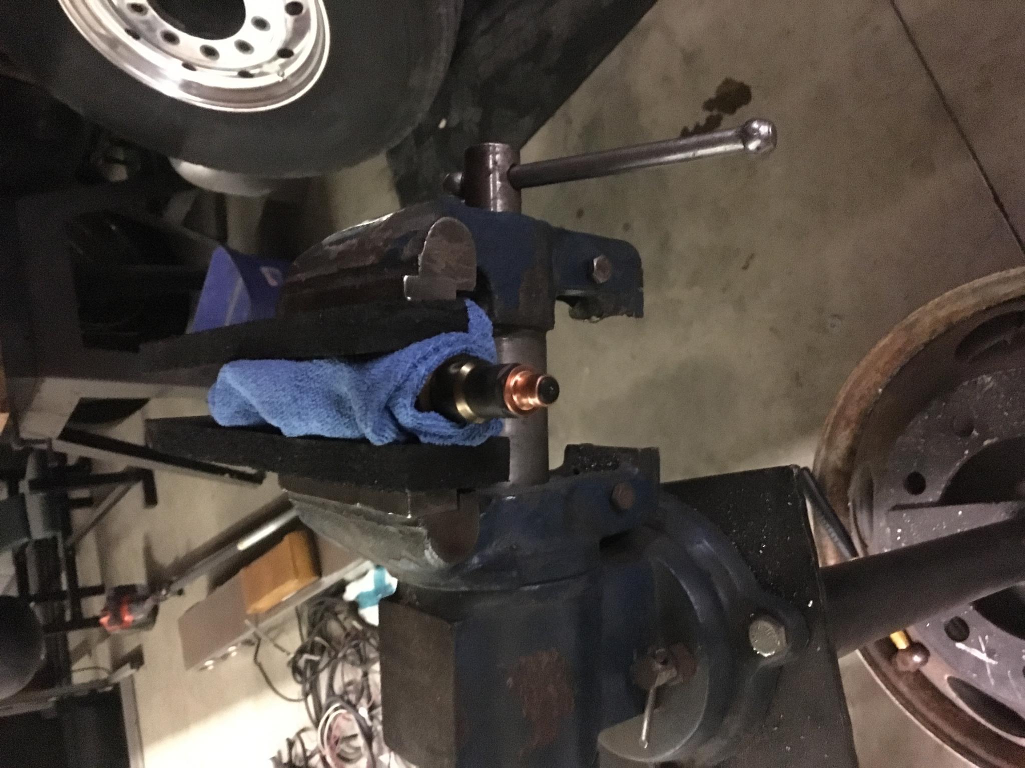

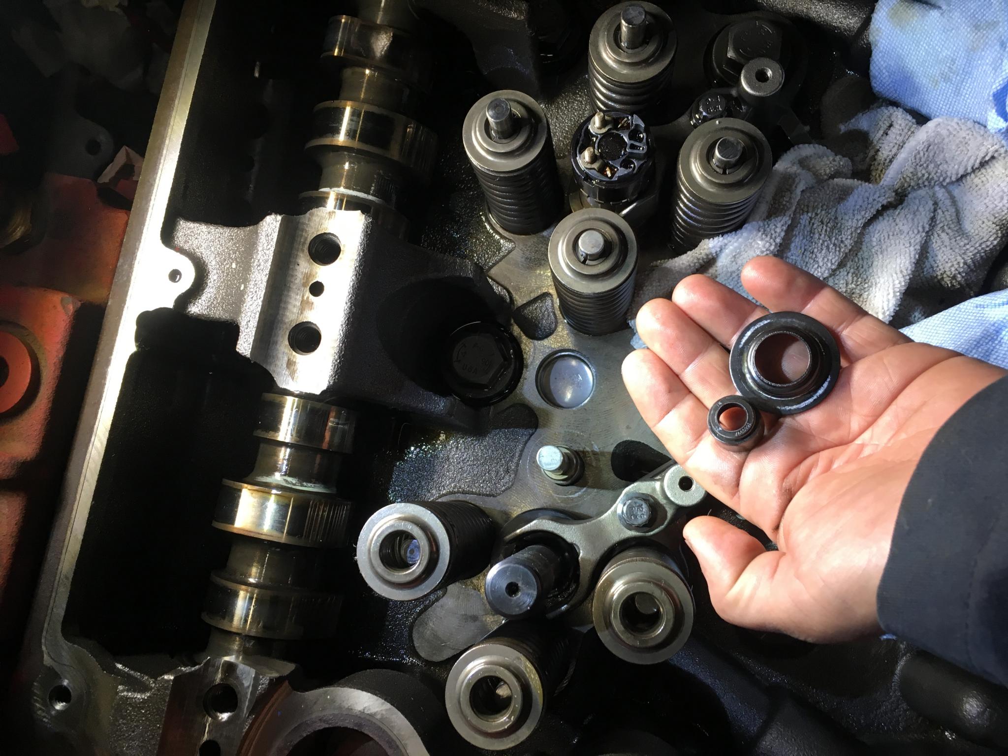

         So brother and I got cylinders 1 & 2 done today!! Found “smoking guns on cylinder 2 exhaust valves. The seals had came off the stem guides and were moving up and down with the valve stems. We R&R’d the injectors with new O rings and new brass tips. Scary, knowing the cost of the injectors, when you are pounding the tips on. Lubed the new O rings and brass injector sleeves with vaseline. Everything went pretty smooth but I know it will get tougher as I move back under the cab! 6 is gonna be a bitch, and brother is leaving tonight to go truck’n so I am flying solo. These are the times I wish for a hood truck, like a W9!! Starting on 3 tomorrow, will see how it goes.

JHNDZ, my truck has 648k. I am doing the valve guide seals because they have been leaking awhile and finally got so bad they started to push oil out of the exhaust manifold. I would not bother yours if they aren’t leaking regardless of miles. I don’t know what this would cost at a shop as I am doing it myself all at my brother’s.
