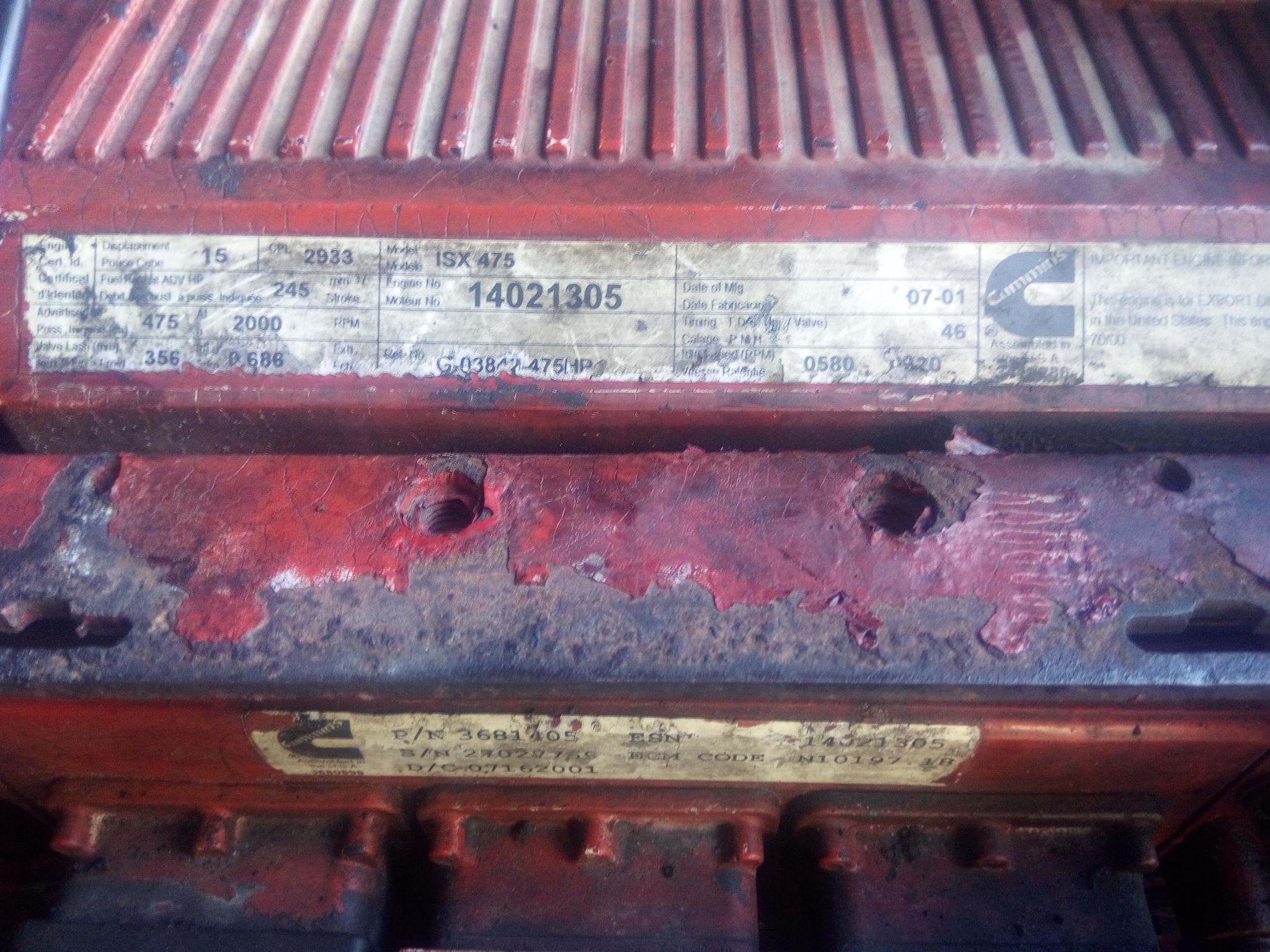

Let’s not worry about crankcase filter for now . Signature 620 asked for a picture for a reason. This will determine what engine you have and we’ll go from there.
ISX family started with CM570 and Signature/ fixed vane / non VGTurbo .
So we can say first generation ISX .
Then came up CM870 with air actuated VGTurbo and EGR .
So we can say second generation ISX .
2002 can be either of first two .
Then came up CM871 with electronically actuated VGTurbo , EGR and DPFilter + crankcase filter .
So we can say third generation ISX .
So far I have to see crankcase filter on first two yet .
Got to focus on this serious blow by and power loss that can be for many reasons.
So , what engine you have ?

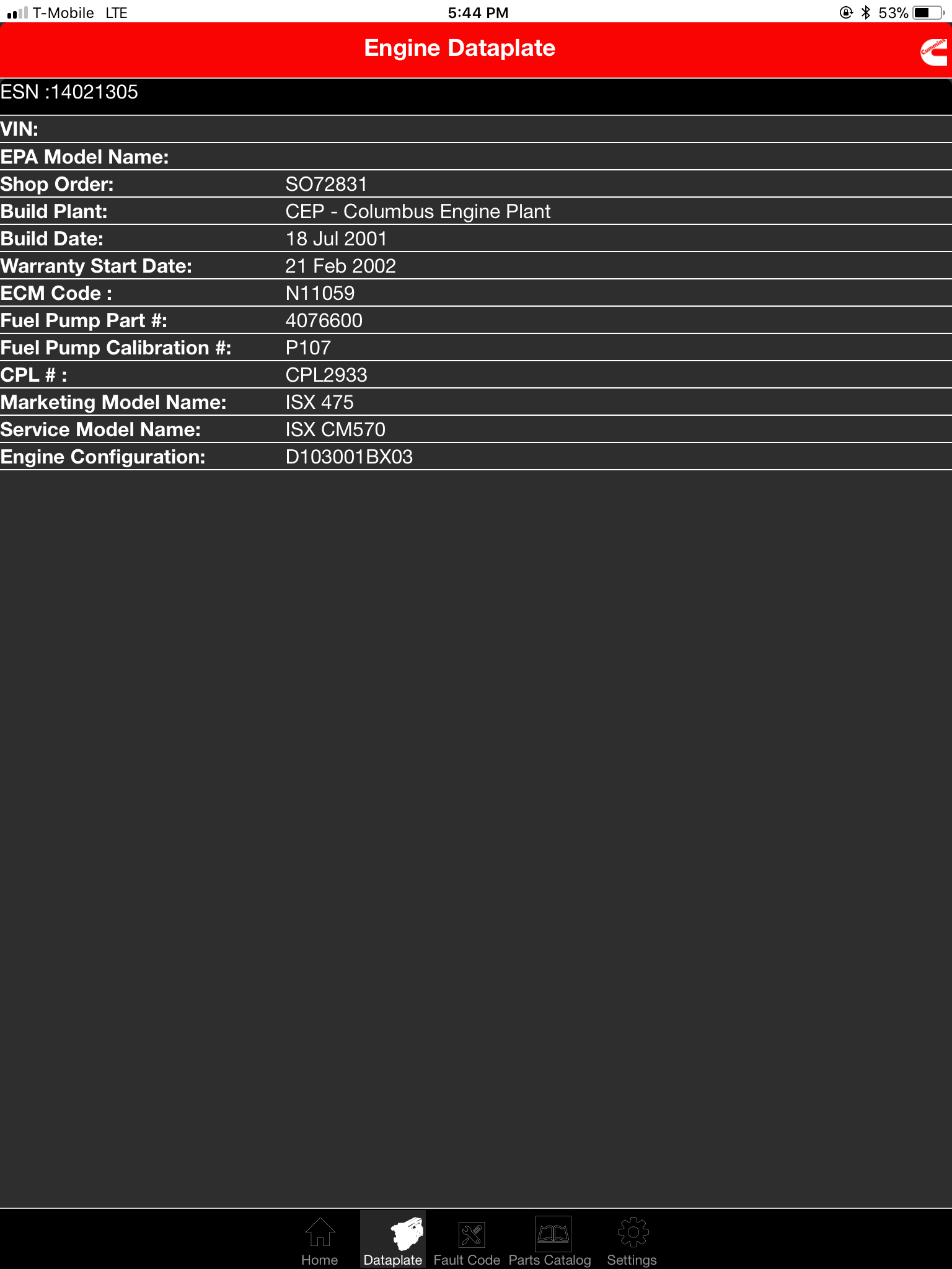

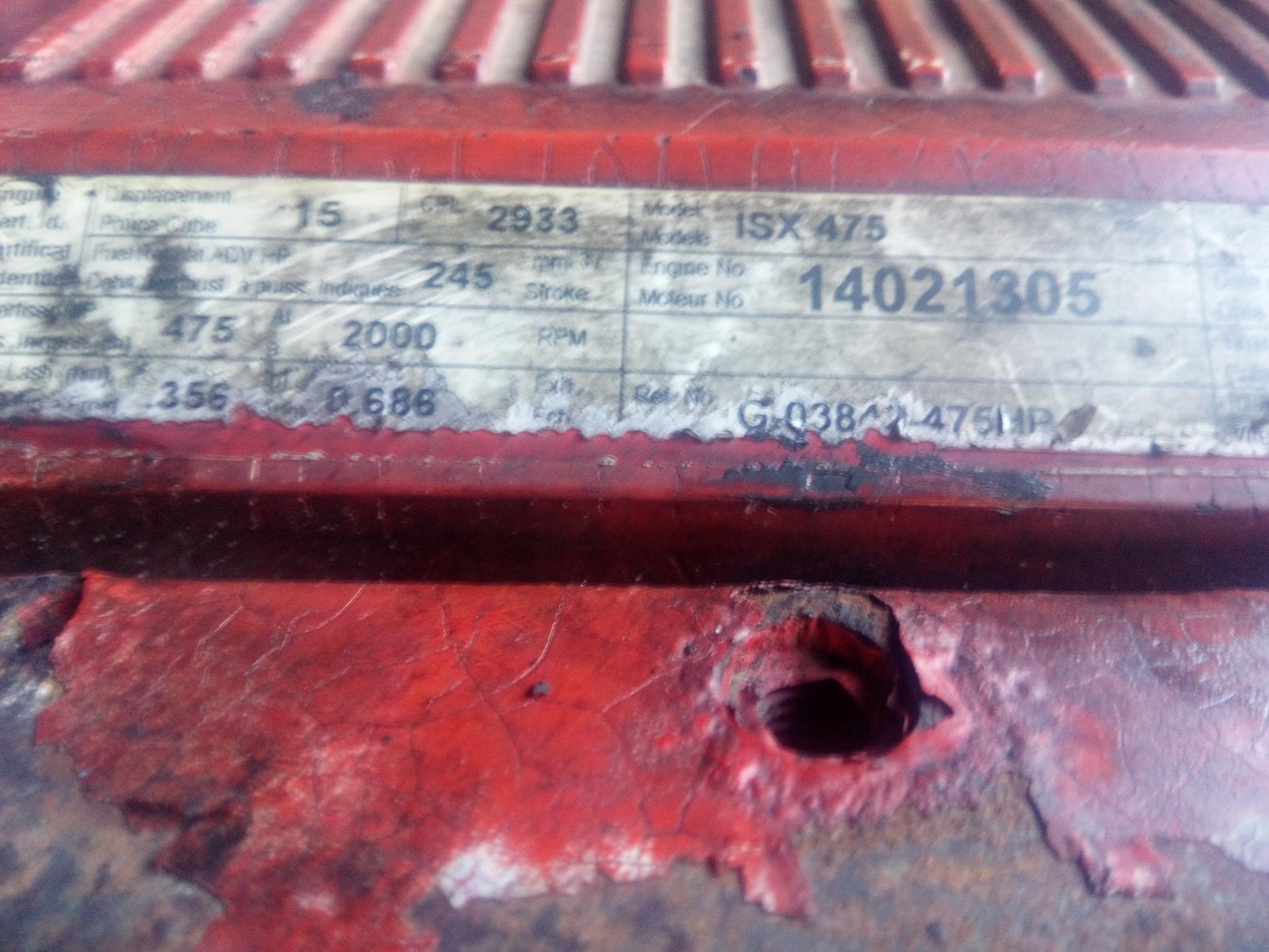

I hope this is clear enough I found it on my phone

    Ok , so it’s CM570 . Nice engine . At least you don’t have to deal with this nice crapp we have to deal here .
Give us all information you currently know about it . Like miles,
Anything done about the head . Boost under full load . Pyro temperatures. Fuel consumption.
And so on ..... anything you can think of it.
