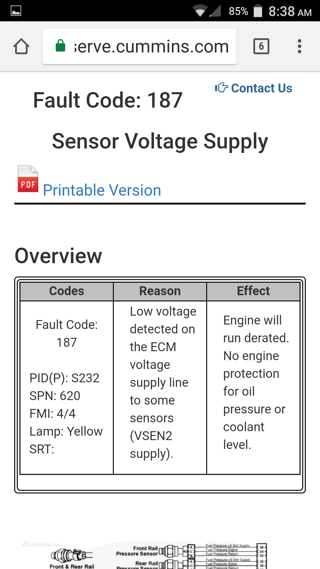

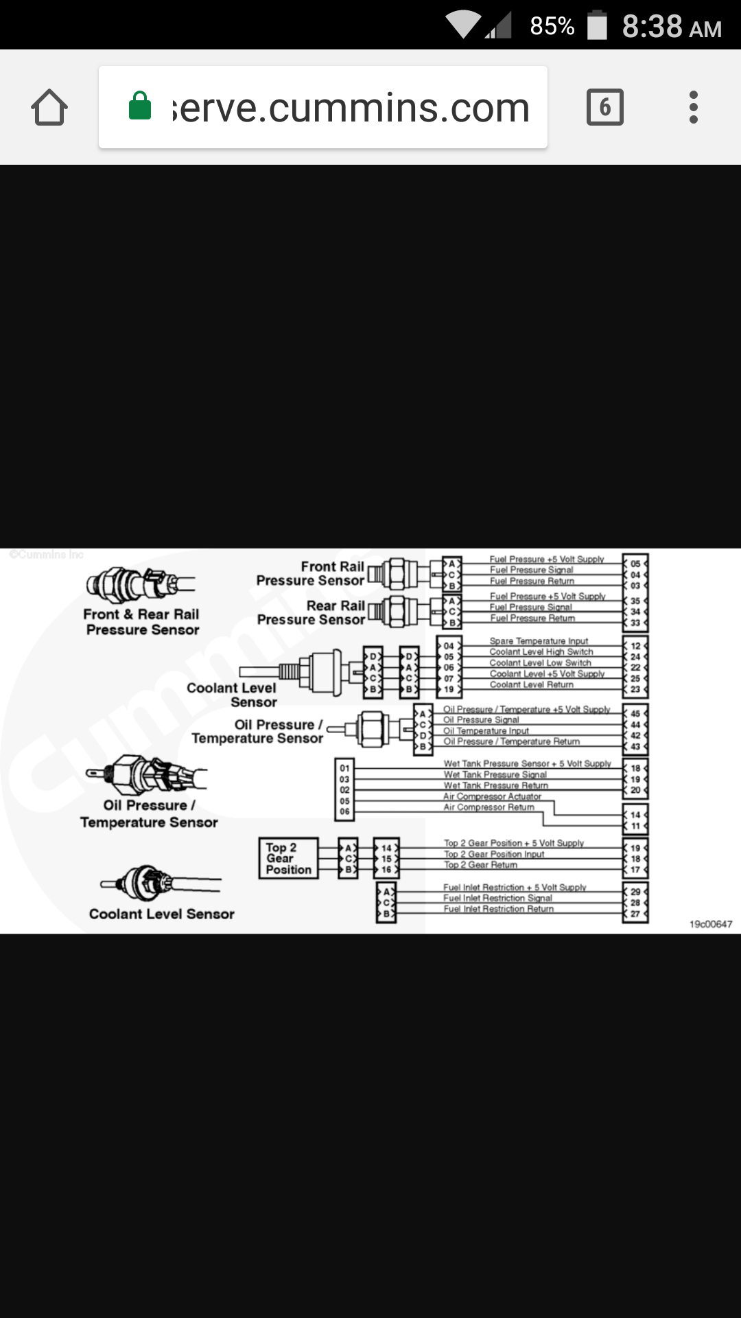

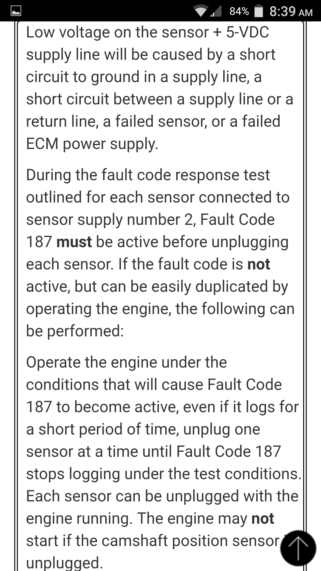

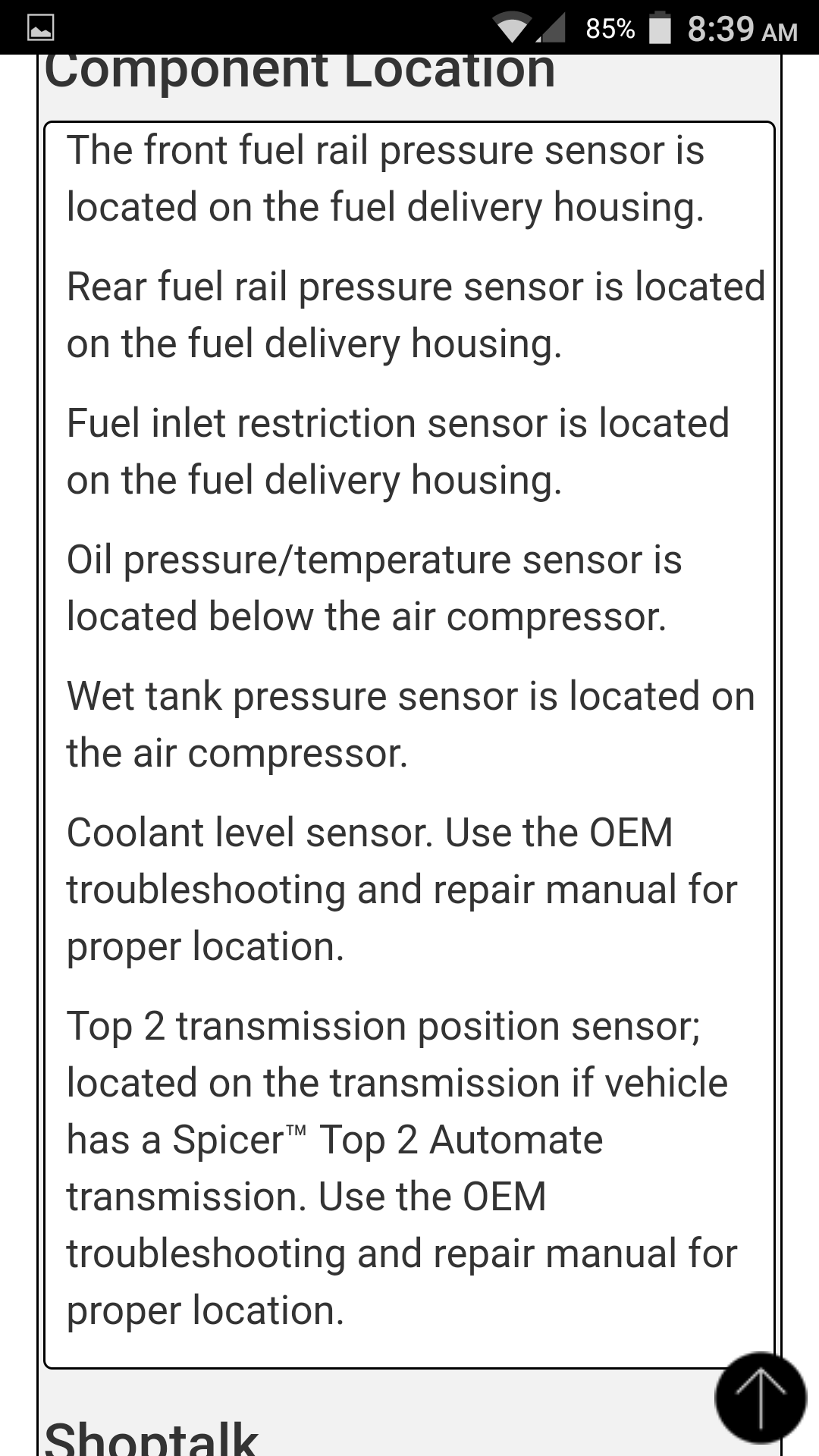

Register your engine on Cummins Quickserv for free and type in the code. It gives a full description of the code.
But if you're in need in a hurry...
./uploads/201806/post_3285_1529844029_e6944da459660ed1a5d8073ecee547f8.png
./uploads/201806/post_3285_1529844055_f0c457e3f8d95b9b107a402b643496cb.png
./uploads/201806/post_3285_1529844070_18aaca97e94f38e2c8e8e6135c1139dc.png
./uploads/201806/post_3285_1529844078_06afb32e6601665a360067735de31774.png

Unplug the sensors listed in Chamberpains' images one at a time to see if the engine will stay running (check eng light will be on but stop eng light will be gone if one of the sensors is faulty)
