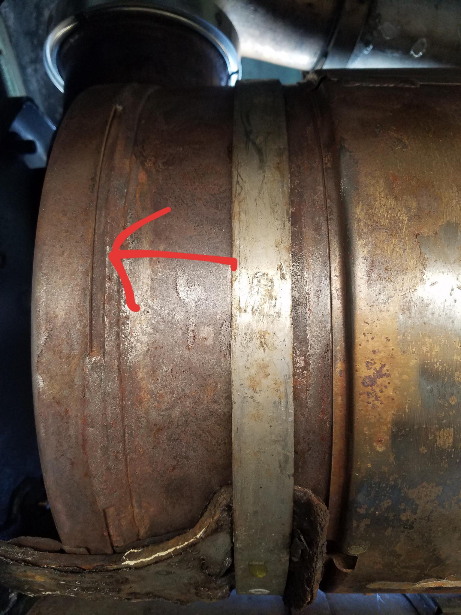

I have an exhaust leak in DOC, before first clamp. Its leaking at front end of can at the joint where cap is welded on. Is there seal in there to replace or do i need new DOC?
Edit: Second truck just came in doing same thing, it smokes alittle out doc until temps go up to 1000, then smoke stops. isthis normal?

maybe some pictures of where its leaking>?
As far as smoking during a regen, depends on how well the fuel ignites. In colder weather for example, it is not unusual to see plumes of white smoke during a regen while going down the road while the system is getting up to temp.

I think some of those cans have small holes in the bottom of the element(s) for condensation runoff. If it is only small amounts, then it may just be from that?. - Jest a guess.

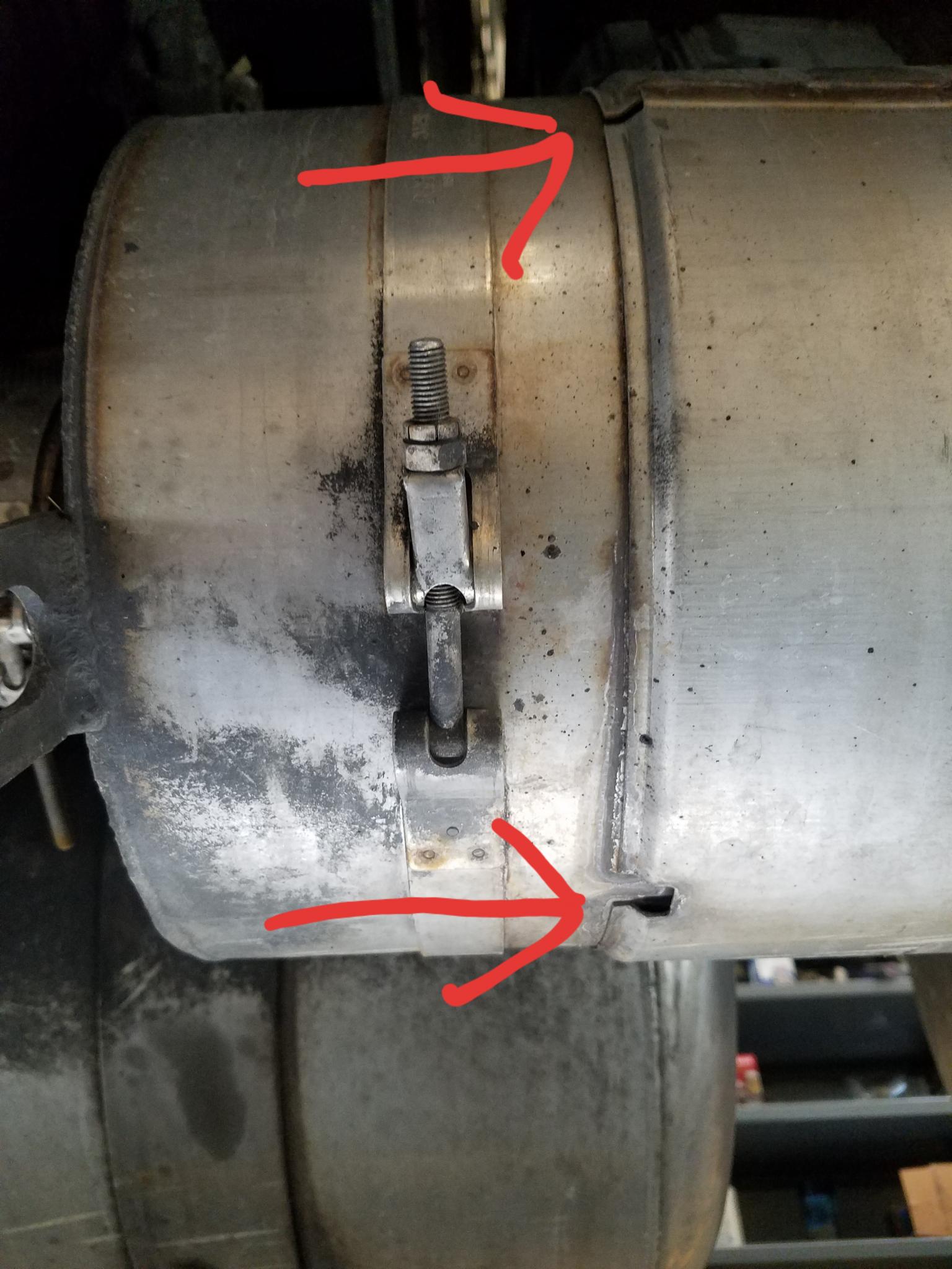

This is where i thought it was leaking on ISX. Maybe actually was coming from same vent
