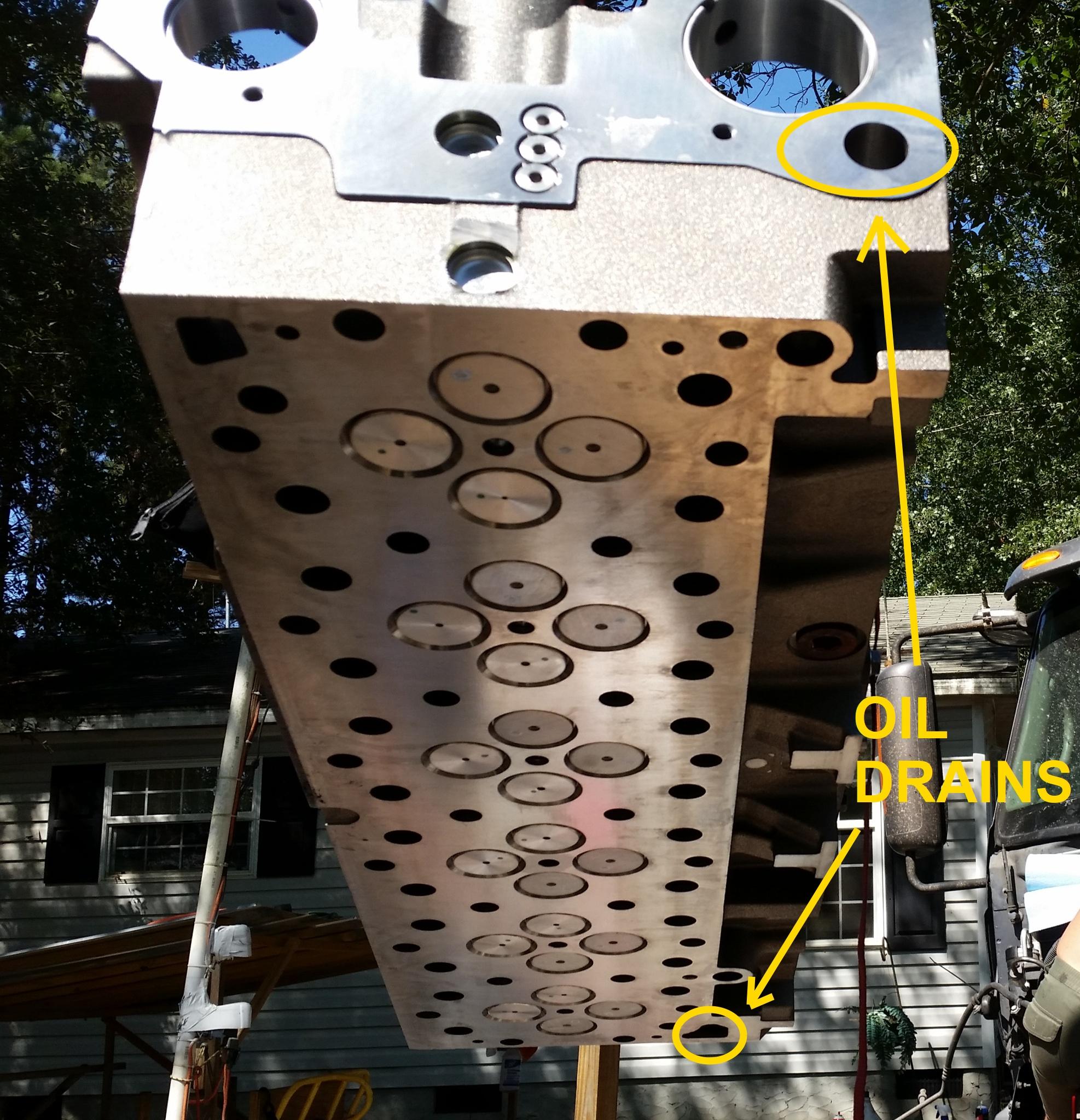

I have a 2007 CM870 that blew an injector tip. While diagnosing the problem I ran the engine with the valve cover off. In about a minute oil pooled up and spilled about a gallon over the rear of the head which explains the leak that 2 new gaskets have failed to stop. Surely those rubber valve cover gaskets are designed for splash sealing not immersion. The engine has less than 100k on an out of frame overhaul and this small leak at the rear of the valve cover is the only it has.
My question is are the head gaskets made with a restriction to slow drainage and if so can I enlarge the opening (in the gasket) without causing a lack of lubrication up top?

I wonder if someone has dropped something in the oil drain casting at the rear intake side corner. Oil drains from the head in that corner and through a hole in the front injector cam plate (front intake side corner).

Signature620 is correct. There are 2 fairly large drains so that oil does not pool up in the head.
Those openings/drains are fairly large so something does not sound right.
You say it was recently re-manned,... did someone make a mistake with the head gasket? did they block them on purpose like a complete fool? -- did they forget a rag stuffed into them?

I don't think a rag or anything else was left in it during the rebuild. I did have to replace a cam shortly after the rebuild (don't buy cheap cams) and there was quite a lot of metal I had to clean up. I did stuff shop towels in all the opening to keep metal fragments from dropping into the pan so I might have left one in the back far corner. I'll check it if I ever get away from this damned desk. To be honest I thought the drains were quite a bit smaller than they are so it must be something like that.
