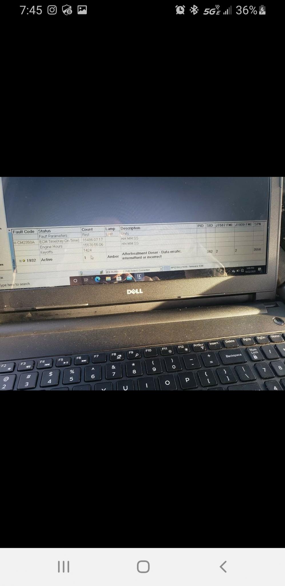

I'm a little over a week from demandate. Truck is throwing this code. Insite is pointing to Doser Injector. Cleared it 3 times now. Truck is trying to regen but it stops and then throws this code.
Question is can I keep clearing it till I get demandate? TIA.

That is a wiring or connection problem -- or your program in your ecm is out of date and does not match the Doser injector that has been instealled.

Its the original Doser injector that I purchased truck with. I did have a new ELD tablet installed on Thursday and the truck threw the code right after that.
Also I saw the tech working in the fuse box area on passenger side.

At 450k (guessing mileage from engine hours in the report)+ miles on it then, the doser is due to be replaced along with a lot of other emissions system items.

I'm going to be in Griffin GA in 1 1/2 weeks. I guess I'm going to have to replace the doser b4 demandate.
