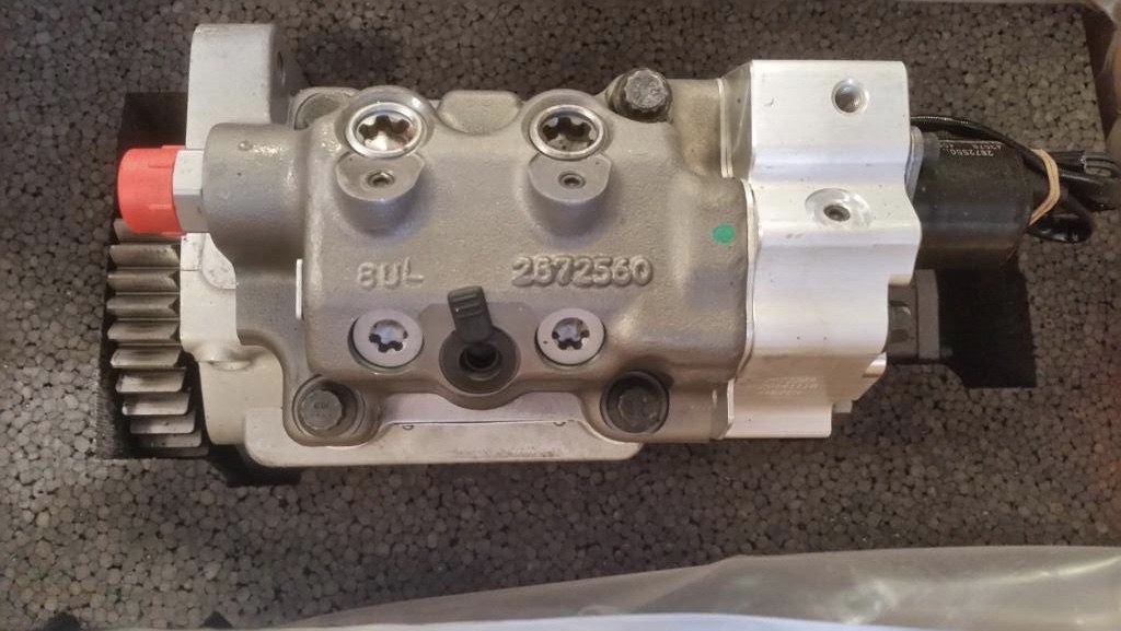

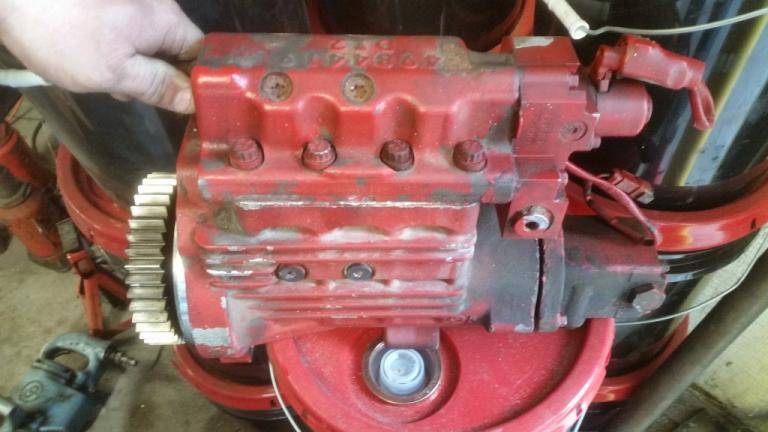

I have a question so I recently bought a new gear fuel pump for my isx since my old one took a dump.
Im noticing that there are 3 lines that connect in different locations of the new pump.
2 being the ones behind and under the pump by the frame.
And 1 on the fuel pump head.
Tried to ask the dealer but they were no help per usual.
Wondering if anybody has done it and has part #s for these new lines that I need to buy. Thanks in advance. Much appreciated it.
Below are 2 photos of the old pump and the new one
./uploads/201810/post_3854_1539202458_870ef0ea812d887d4582ceaf6523a94f.jpeg./uploads/201810/post_3854_1539202474_5004ad166f024b34c3cfe7f8a74b8cdd.jpeg

Mr. Hag has done a lot of them. Maybe he, or someone else can chime in with the right part#'s to do the swap-over.

If you have quickserve access (you should sign up if you don't) here's the installation manual including all the steps, tensions and parts for the job.
https://quickserve.cummins.com/qs3/pubsy...07962.html

That link had everything, thank you...
if anybody else does this in the future and goes from the older style 3 cylinder fuel pump to the new 2 cylinder pump the parts in that link from quickserve will be needed as mounting brackets are different for each pump..
all the parts listed on that link came out to a grand total of $523 the guy at the dealership said i probably wasnt going to use all of them..
tomorrow once i do the pump swap i will update here and mention all the parts that i used.
thanks evrybody for their input
