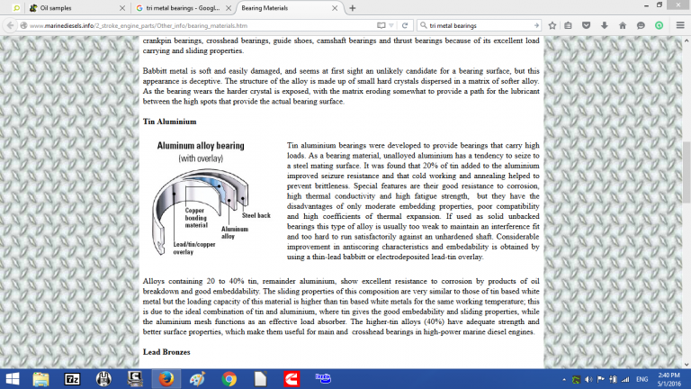

Bearing layers
Hopefully not yours case.
./uploads/201605/post_1794_1462135585_3c9a5a42fed3b38cfa8315b300f7e890.png

If you're still driving it, take note of any change in cranking speed and any rough running.
