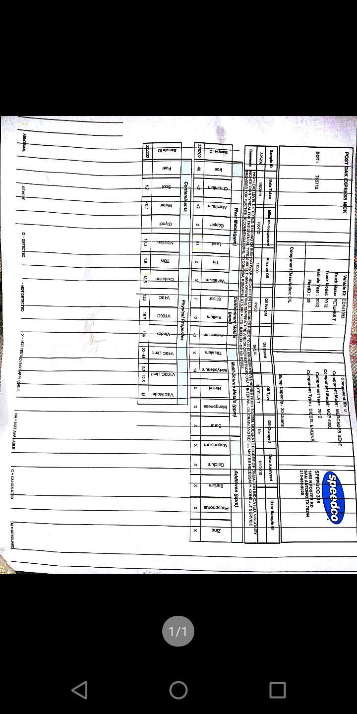

Here are the results i know it may not be accurate but does anything look alarming? They put that the weight of the oil was 5w30 and that I had an mbe motor but that shouldn't effect what the results say

It says lead is at 61 iron at 40 chromium<2 aluminum<2 copper 2 tin2 those are the wear metals and soot is at 1.7 and that oil has been in there quite a while the dealer told me they changed the oil but today found out they did not and it was about 50k on the oil all they did was filters

(01-09-2019 )SIDE_SHOW Wrote:  Here are the results i know it may not be accurate but does anything look alarming? They put that the weight of the oil was 5w30 and that I had an mbe motor but that shouldn't effect what the results say
complete waste of time. Those damn machines are almost always so contaminated with thousands of oil samples that they usually don;t even read the wear metals even halfway close to right.
The speedco down the road form me goes out of their way to clean the hell out of their machine and do all things correctly and was still is whacked every time they have tried it on my oil. -- I gave up on those things.
Only thing they are good for is if you got a severe coolant leak into the oil,.. it MAY,. and i say MAY kind of find it, but usually not if it is a slow leak.
that is my, and several others I have seen experience with them so far,.. Just saying.
Go get pre-paid oil sample kits that you can send off yourself to a real lab.
