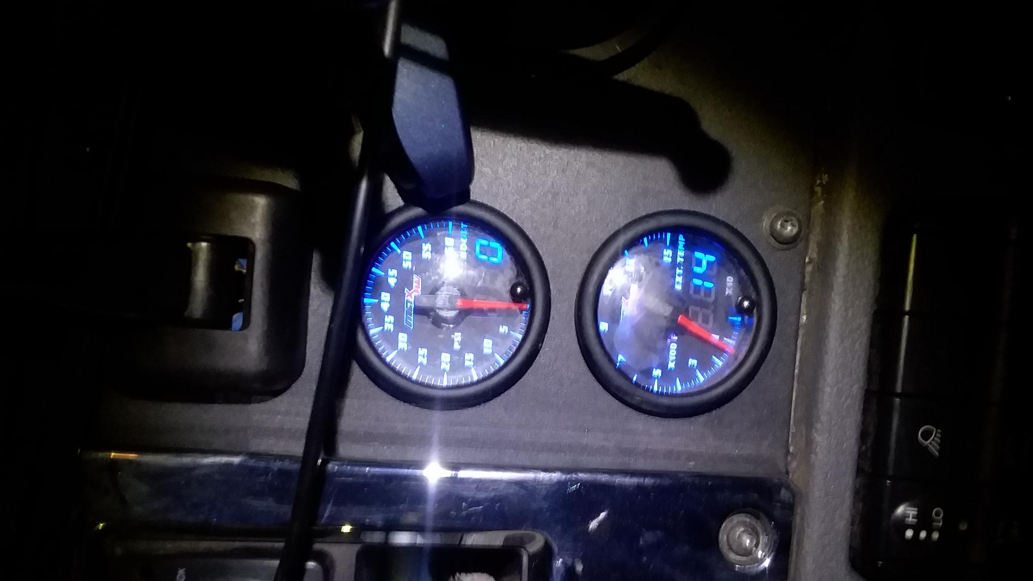

|  GlowShift boost gauge response    13 Cascadia w/ ISX....everything in factory form. Just installed the GlowShift boost/pyro gauges and had a question...   - How responsive are the GlowShiftboost gauges? If I'm not mistaken, aren't they stepper motors? I ask because it seems I should be reading a few PSI at idle (being full factory emission system). If I give it a quick stab in neutral to 14-1500, it will jump the gauge quickly to about 9psi then quickly return to 0. I haven't taken the truck out yet to see any other readings so it very well may be fine. At a low idle (although I havent verified with Insite yet) you can def hear the turbo whistle which is leading to the conclusion of it generating a few PSI. FYI, using the port on the top the intake manifold (right behind where the EGR pipe comes in). Thanks guys  |  |||

|  RE: GlowShift boost gauge response    Depends on the conditions, if the engine isn't requesting EGR gas it could be very close to zero.     |  |||

|  RE: GlowShift boost gauge response    The pyro seems to be all good. I bumped the idle up to about 900 to let the engine get to op temp and the pyro was reading about 225-230 once up to temp (it was at 0 when cold). I went down and shot the manifold right where it is installed with my digital temp gun and it ranged from 200-223 depending on where I swept it. That's pretty close....close enough to let me know when to be on alert. I'll continue checking it to see how accurate it stays. Only time will tell what it will do...   ...and yes, it does have pretty colors lol!  |  |||

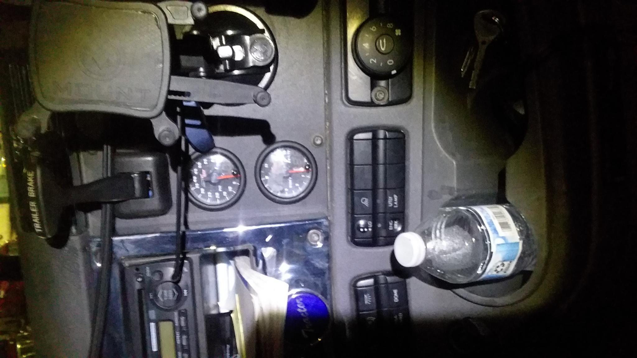

|  RE: GlowShift boost gauge response    FBK, I like the vertical setup....I almost did just that. I ended up putting them across the bottom ( lining each one to the A/C knobs ). I plan on putting 2 more gauges above them and possibly a TPMS system where you have yours now.   BTW, I dig the digital read outs....looks good! Never saw that as an option or I would've scooped those up for sure.  |  |||

 RE: GlowShift boost gauge response  (03-15-2019 )SquareOne Wrote: 13 Cascadia w/ ISX....everything in factory form. Just installed the GlowShift boost/pyro gauges and had a question...What did you run from intake manifold port to the gauge - if it's tube then gauge is just regular manometer  |  |||
|    03-17-2019, (Subject: GlowShift boost gauge response )   Post: #8   |  |||
|  RE: GlowShift boost gauge response    I have used Glowshift in a few Powerstrokes ive owned you can get either a screwin pressure sensor with wires to the gauge or a compression fitting with hose from manifold to gauge if i remember right.     |  |||
