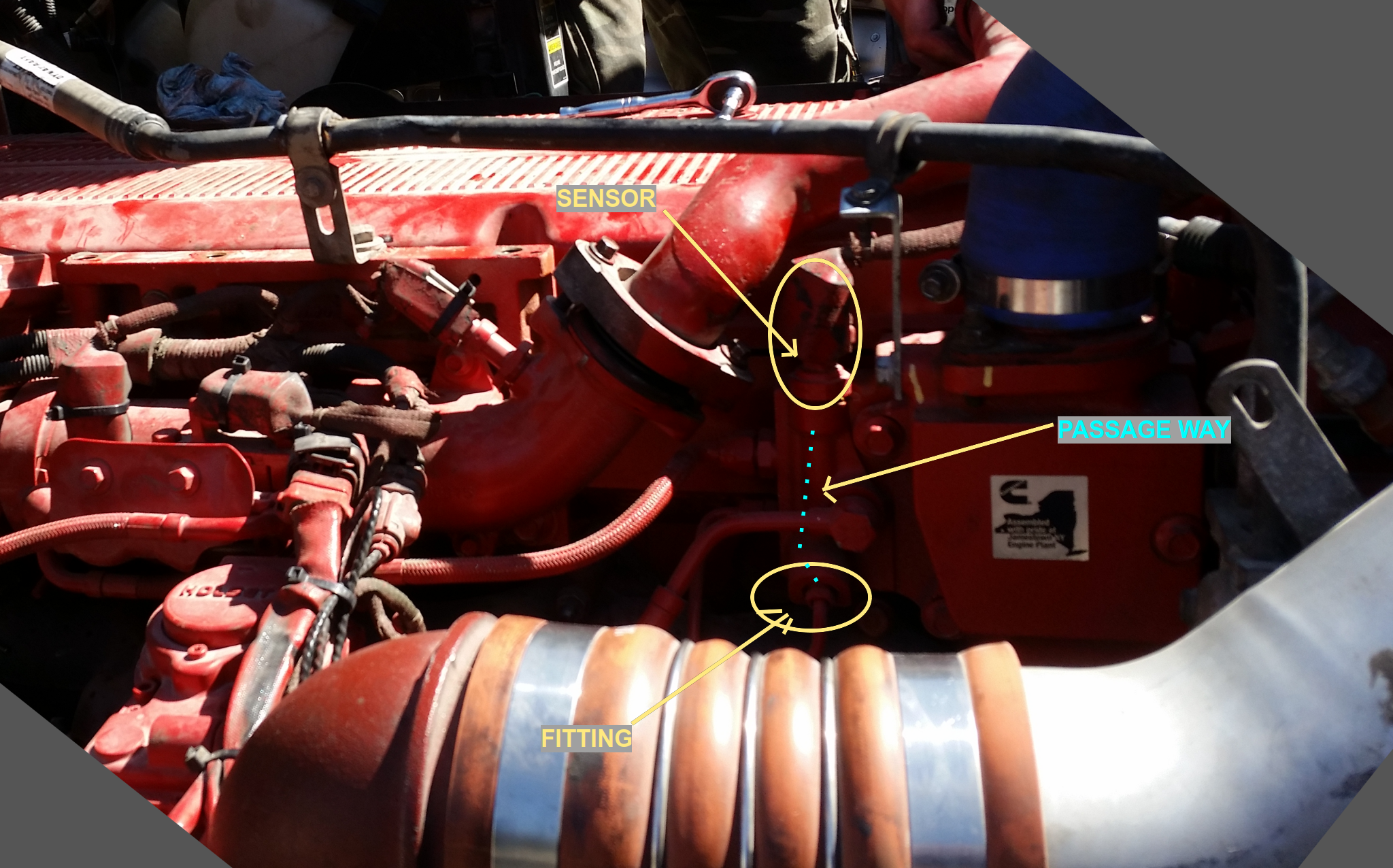

(03-22-2023 )Scoot5869 Wrote:  Thanks!! Got everything in truck this morning and just got first load on. Turbo sounds much better. Have an exhaust gas pressure light on now hopefully sensor is bad I imagine it was shut off before
Yup. It was blocked from being able to show faults on the garbage-can program you had in there.
That sensor is needed for cylinder mis-fire detection and is used to help with fuel economy among other things. Make sure the passageway thru the thermostat housing is also clear .... it passageway likes to clog up.
While the sensor is off, spray some brake cleaner down into the hole and make sure it does not pool up. If it does then remove the little pipe (upper fitting only) at the bottom of the thermostat housing that goes to the exhaust manifold and take a stiff wire or something to clear it out.

RE: New to me cm871
Ok thanks it keeps going on and off so could be the connection I think that’s the one that I have zip tied in place. But I’ll also check to mange sure passage is clear

(03-22-2023 )Scoot5869 Wrote:  Ok thanks it keeps going on and off so could be the connection I think that’s the one that I have zip tied in place. But I’ll also check to mange sure passage is clear
It is not normal at all to get faults with the exhaust pressure sensor.
With proper de-mandate programming, the "cans" under the truck have to also be 100% hollow. Exhaust has to be as free-flowing as absolutely possible. Not a bunch of little holes, or a big hole in the elements but the insides entirely remove all including the insulation to the bare metal. Any back pressure or places to reflect heat in the exhaust cans is bad for the engine and its turbocharger!... and a lot of de-mandate shops are lazy and do not do this kind of stuff properly.

There are no cans anymore. I replaced the sensor and the plug will be here tomorrow the lock is broke so it’s zipped tied down. The fault light started to randomly come and go last week. I could never catch it in park to see what it was until today and just got insite up yesterday. Thinking of replacing the whole harness those plugs are getting brittle
