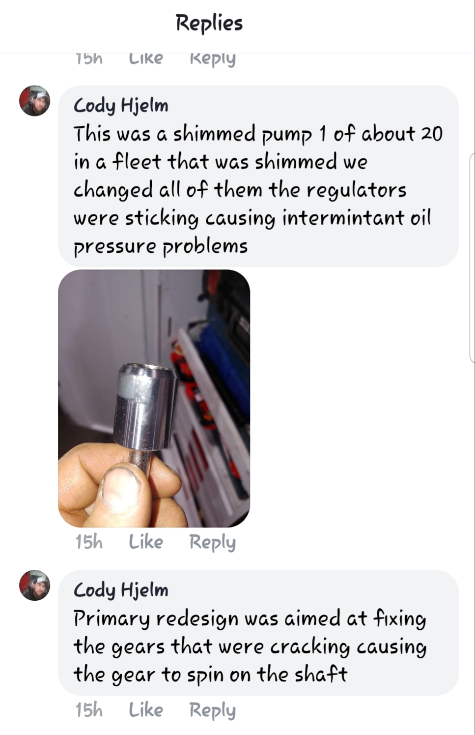

@rawze have you guys had anything like this happen from the oil pump shim?
./uploads/201907/post_2987_1563650610_6a4b587b4f83de4aee5d05c243079148.jpg
