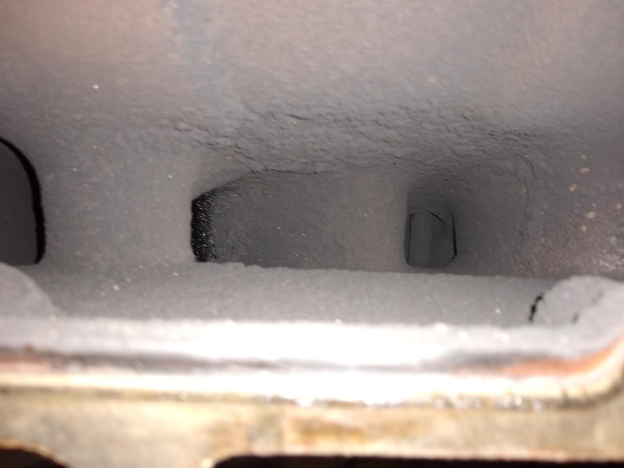

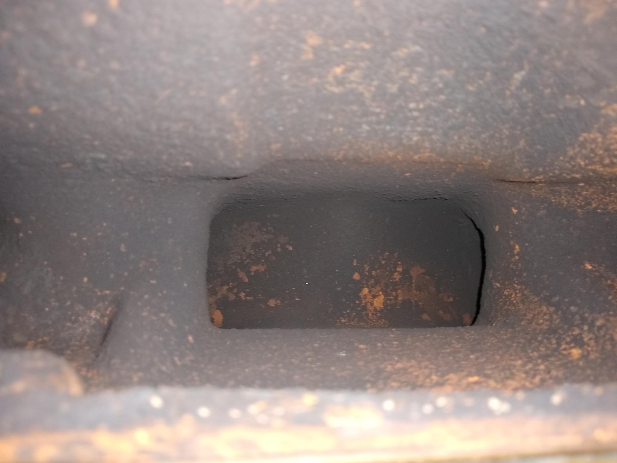

Head isn't too sooted up first pic is behind ECM 2nd is intake
