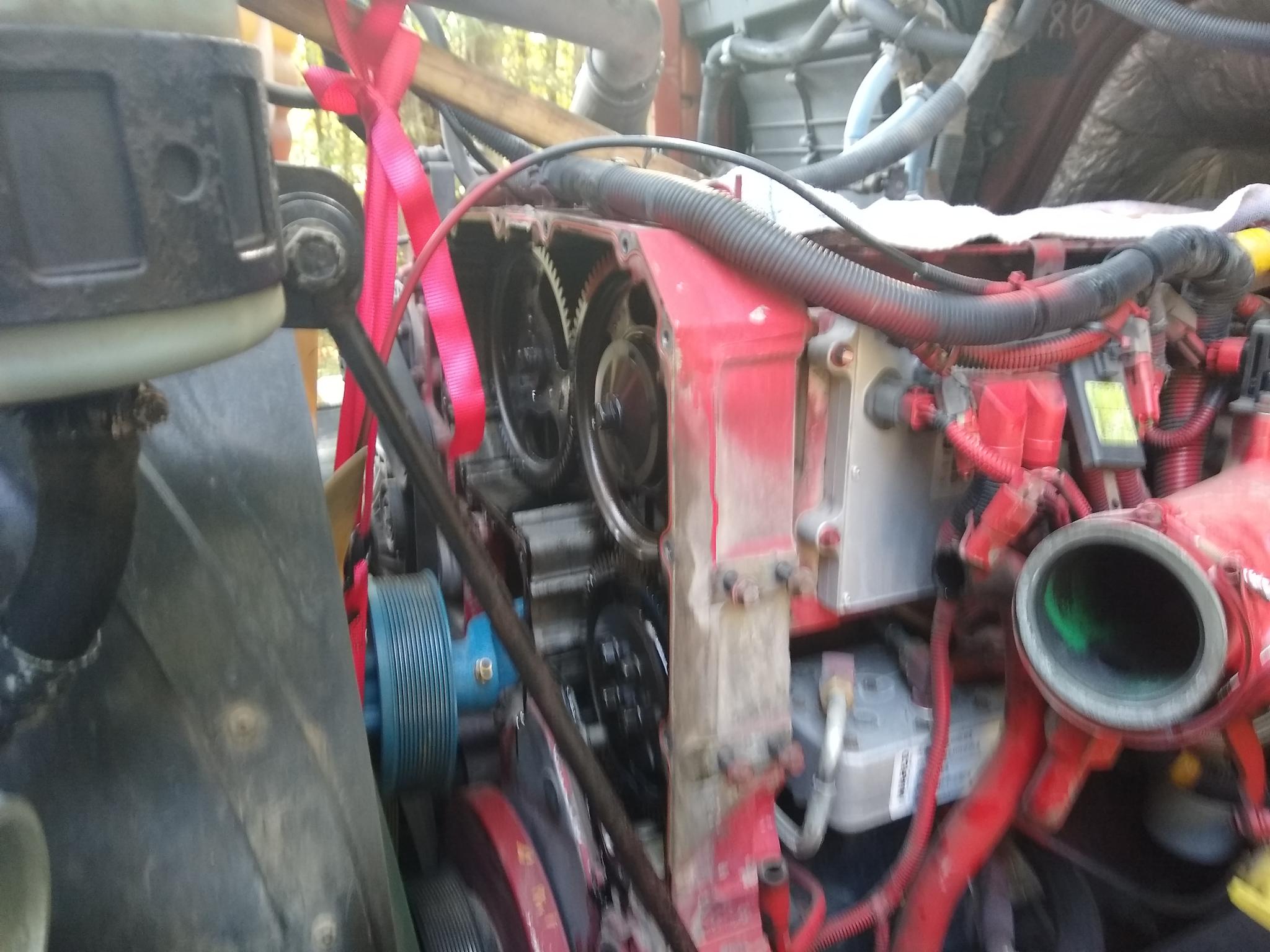

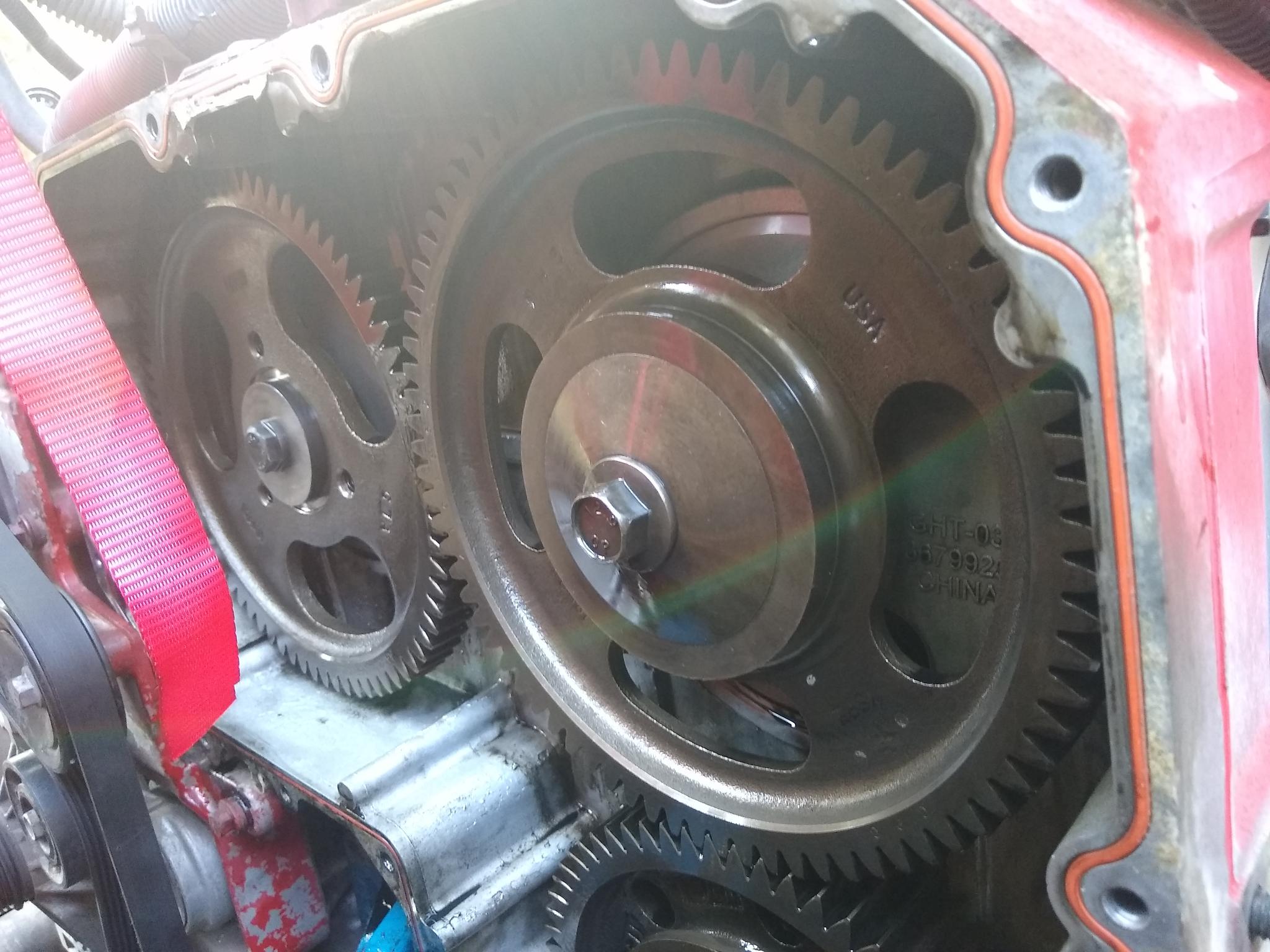

RE: Last straw
Also 1/2 rockers were under torqued 1/2 were over torqued and the plate on the injector cam isn't the updated plate that should have been used when overhauled.

RE: Last straw
Yep, sounds like the same overhaul I received, no wonder your fuel mileage sucked... That plate too, they reinstalled on mine, it is very clear in Quickserve that this plate has to be replaced, one time use only. Good thing you are at Rawze's house.

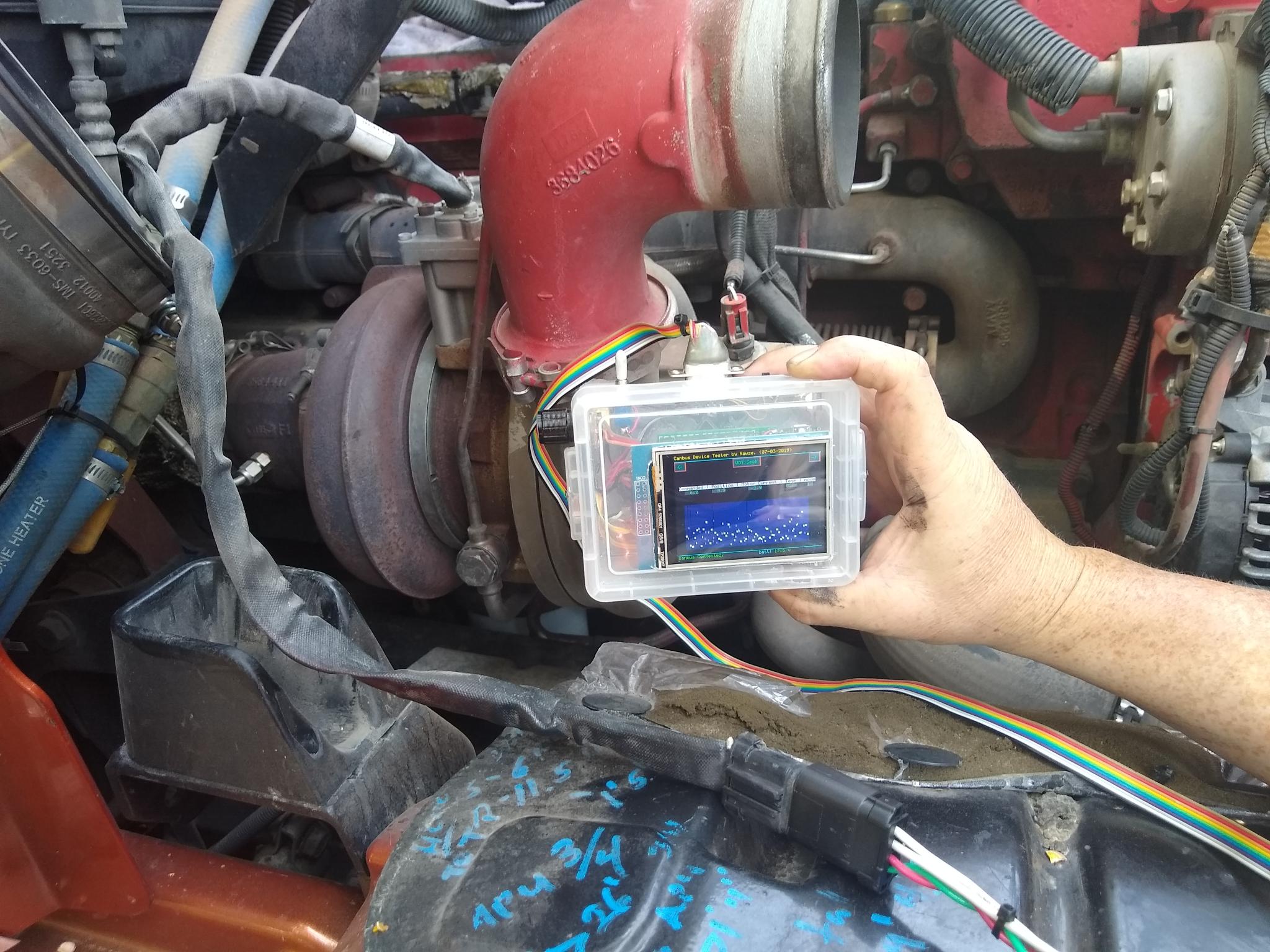

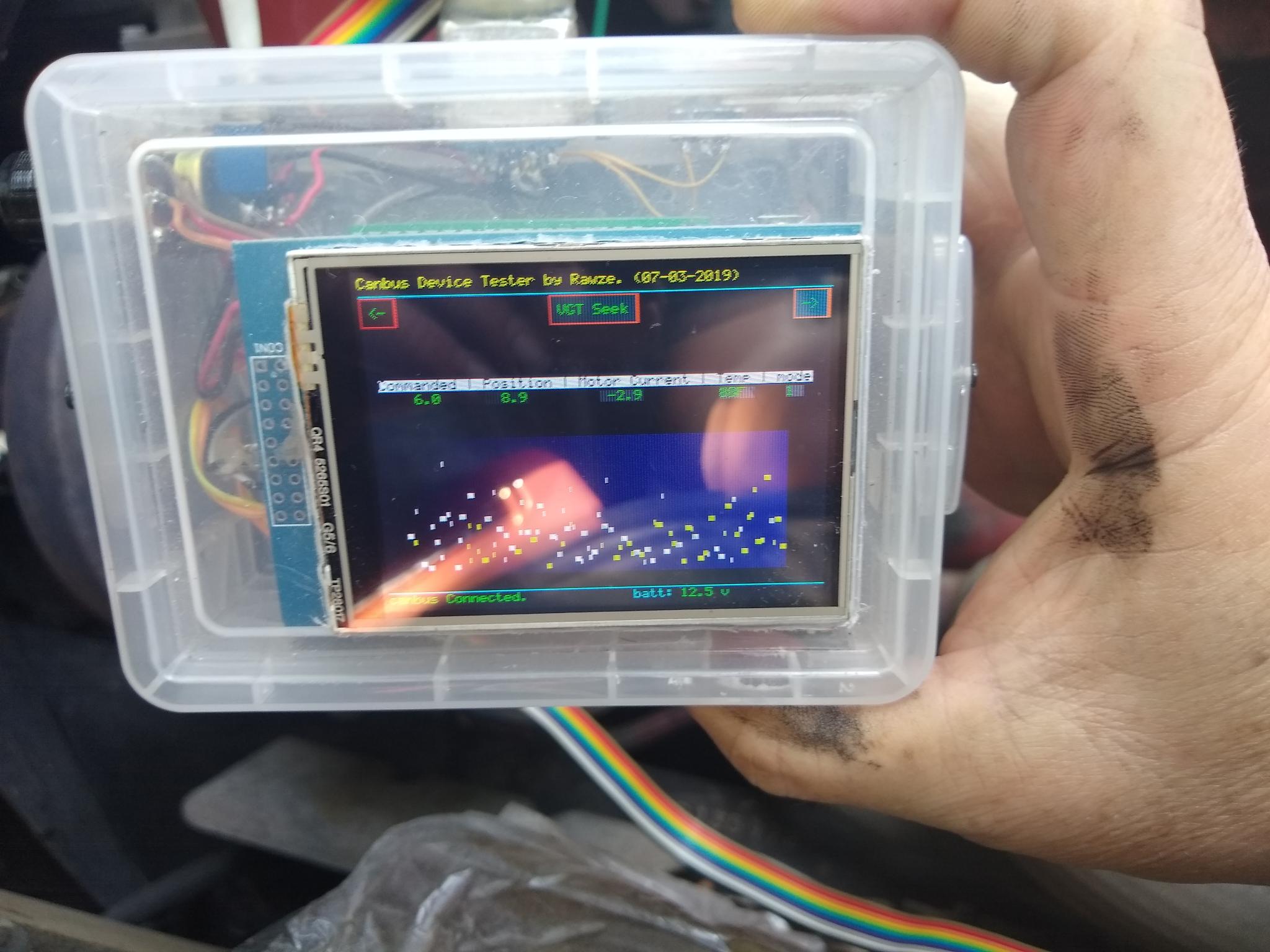

RE: Last straw
And turbo actuator has a bad logic board and turbo itself sounds little rough sounds like a trip to yiyoto

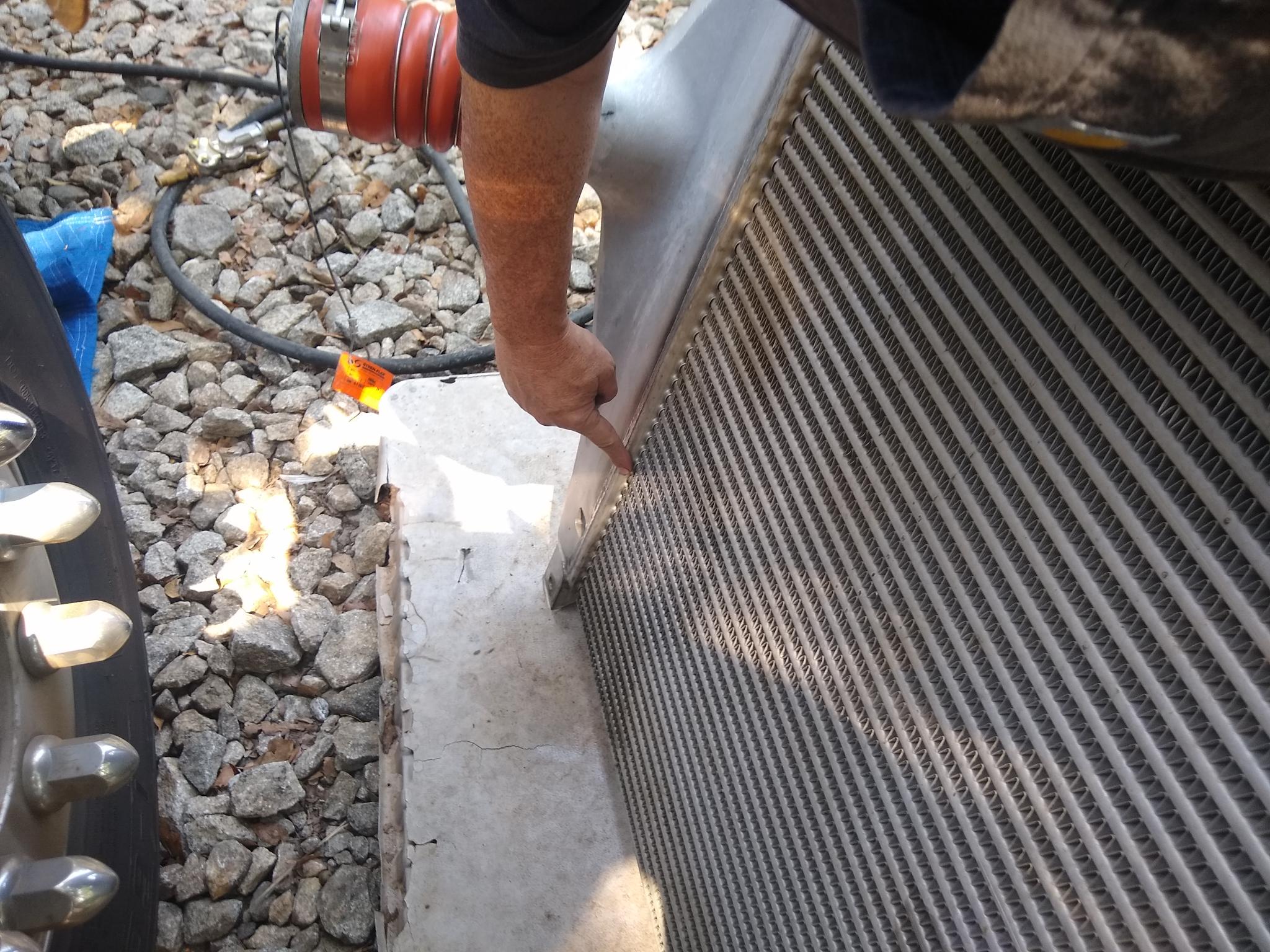

RE: Last straw
And the charger cooler has a leak where the center section meets the outside section and it's only 2 months old damn rawze trying to bleed me dry death by 1000 cuts. Lol
