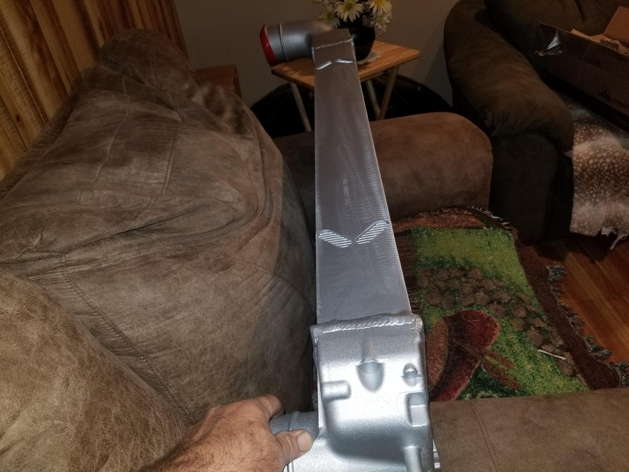

| RE: Cac replacement After calling the dealer for price quote of like 1200.00 for a OEM cac I found this one of fleabay...very well made for less than half of what the stealership wanted... | |||

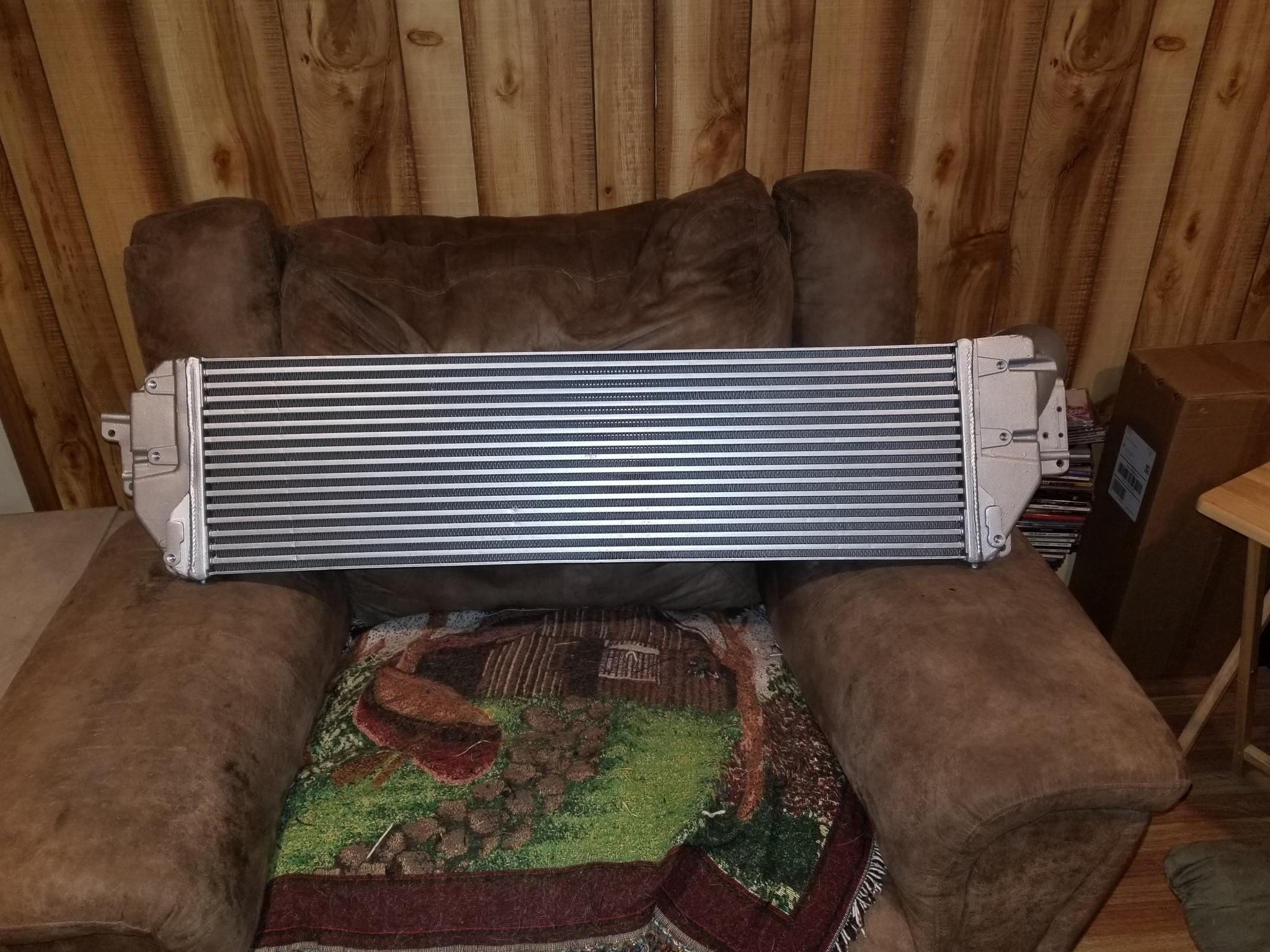

| RE: Cac replacement Another pic | |||
| 10-19-2019, (Subject: Cac replacement ) Post: #5 | |||
| RE: Cac replacement maybe 600 cheaper but is it as efficient as the OEM is the question if its not your going to spend more than that 600 in fuel. you may have saved a nickle to wind up spending a dollar somewhere else over time and never recovered. User's Signature: 2010 Lonestar - CM871 - 13sp - 3.70s, 2016 T680 - cm2350 - 13sp - 3.36s - skateboarder | |||
| 10-19-2019, (Subject: Cac replacement ) Post: #6 | |||
| RE: Cac replacement It's exactly the same as oem... looks like maybe a recore? | |||
| 10-19-2019, (Subject: Cac replacement ) Post: #7 | |||
| RE: Cac replacement That's the CAC on a prostar??!! Wow smaller than I would have thought for a 15 liter engine. | |||
| 10-19-2019, (Subject: Cac replacement ) Post: #8 | |||
| RE: Cac replacement I was thinking the same thing holy shi#t that's tiny | |||
| 10-19-2019, (Subject: Cac replacement ) Post: #9 | |||
| RE: Cac replacement I have a prostar. The CAC has 18 passageways + top/bottom plates. - That fleabay P.O.S. is going to be restrictive. - looks like a cheaper version of the duraf$uck re-build wannabe with the same 12 (or 15 on the chineesium version copies) or so passageways as that restricted garbage fuel-mileage killing knockoff junk!!. CAC is a critical component towards the enigne's efficiency. You get exactly what you pay for!. - Go get an OEM or pay the price every single day you drive your truck. Save a dollar to spend ten times that every year making the oil companies richer!. I hope like hell you did not purchase that thing!. There is a sucker born every minute!. ref: http://rawze.com/forums/showthread.php?t...45#pid5845 User's Signature: ->: What I post is just my own thoughts and Opinions! --- I AM Full Of S__T!. | |||
