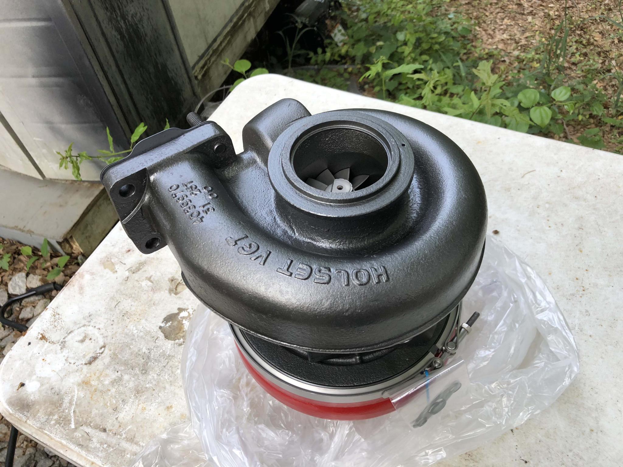

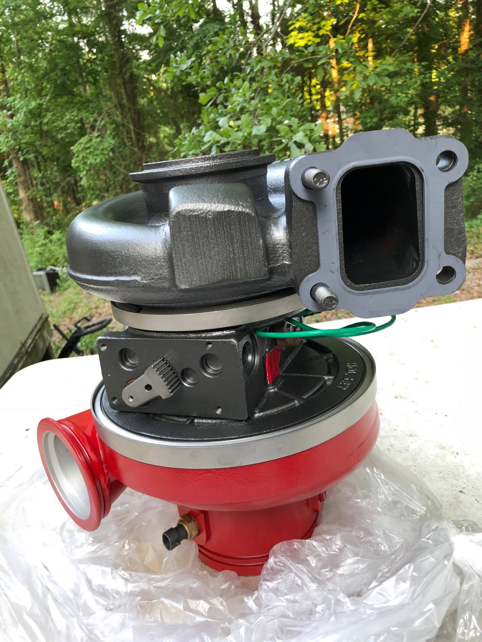

YTS, mine is going strong, just inspected CAC and lines, no slobber like those expensive Cummins remans. Call them, he will take care of you, great folks, incredible pricing. When I received mine, after replacing several reman Cummins units for puking oil everywhere, I did not want to put that YTS Turbo on my truck, I wanted to take it home and place it on the coffee table. Seriously, it is a damn work of art. And that finish is holding up.

I appreciate every one and rawze. My turbo blewout. I can't complain the turbo lasted 877,000 miles. I'm down here in Griffin at YTS picking up my new reman. Thanks to Rawze.com again, I think I'm in good shape.
