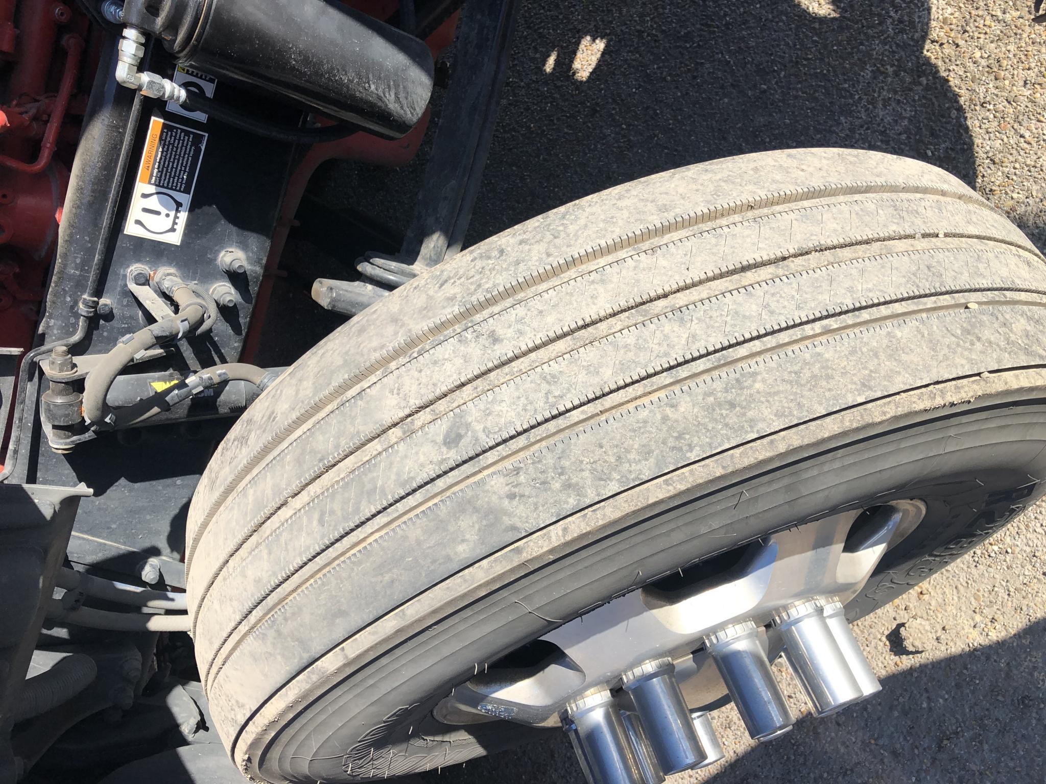

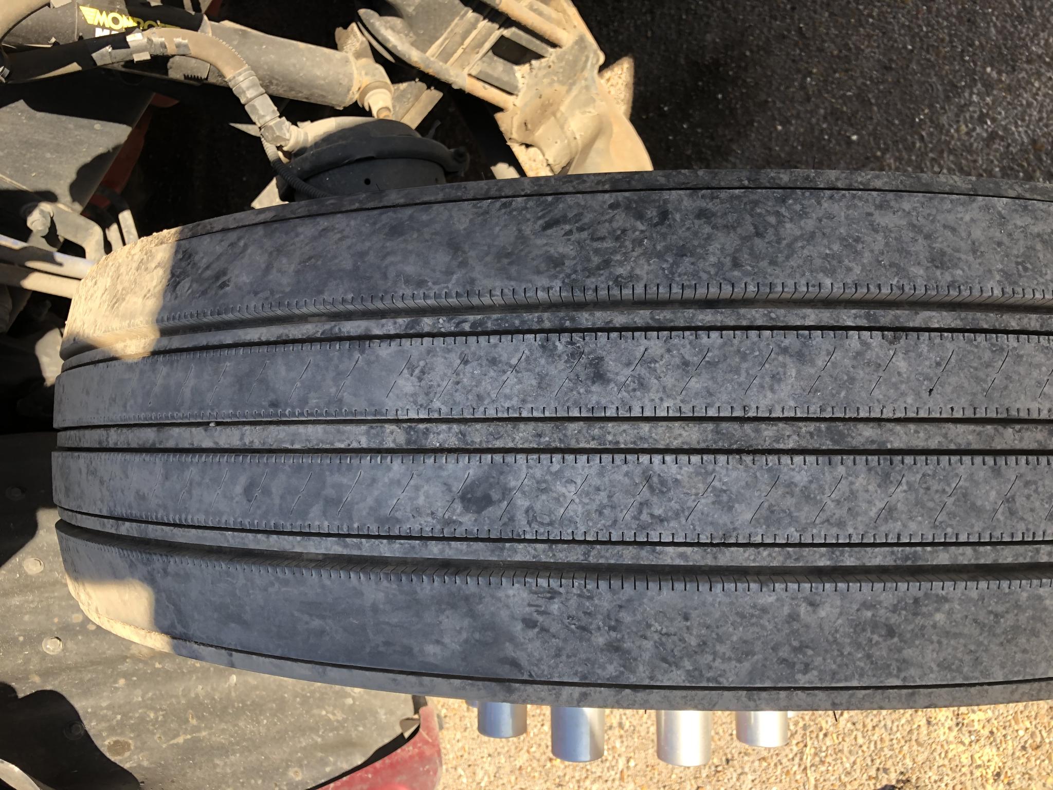

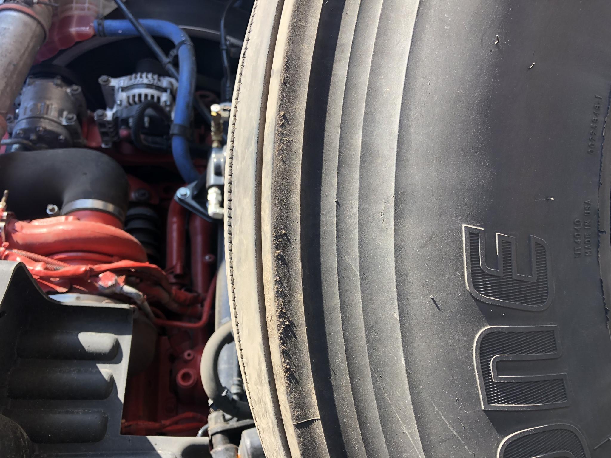

Tire wear is outside passenger side. 70k miles on tires.

Rear axle alignment compounded by that tire wore like that will really make to pull. Rear alignment creates the tire wear then together they really make the truck pull to the right.
