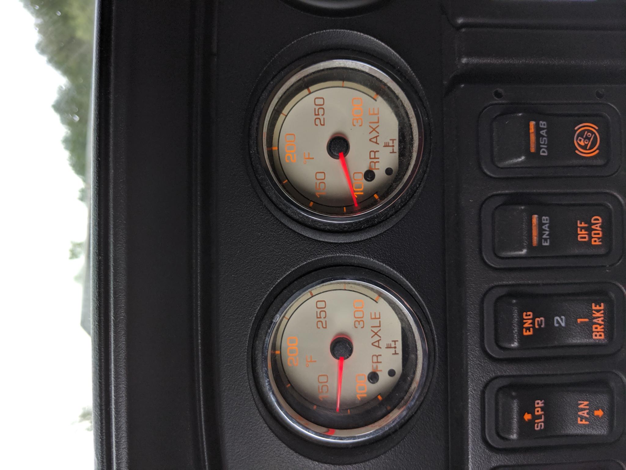

Is this normal? The RR axle was at 100 for a few minutes while I was rolling. The light had came on and went off
10-21-2019, (Subject: How hot is too hot for a new set of brake shoes and drum to run??? )
RE: How hot is too hot for a new set of brake shoes and drum to run???
I have the same gauges in my Lonestar those lights light up all the time
(10-21-2019 )Lonestar10 Wrote:  I have the same gauges in my Lonestar those lights light up all the time
Okay. Thought I might have had a problem
