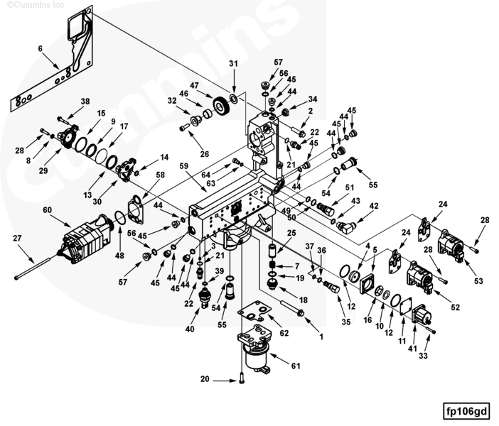

The quickserve manual show the repair procedures for all three motors an it usually states which motor its for if there is differences.
I doubt you have the filter as chamberpains mentioned it was mostly on the 570 an caused issues so it was scrapped, #25 he mention is the 250psi check valve for feeding the ecm cooling plate not a filter

Ynot, I was saying on the blowup of a cm570 IFSM it would be #25. On his blow up (cm870), its nonexistent. The extra close up of the filter, I'm not sure why he had them under his ESN (cm870)

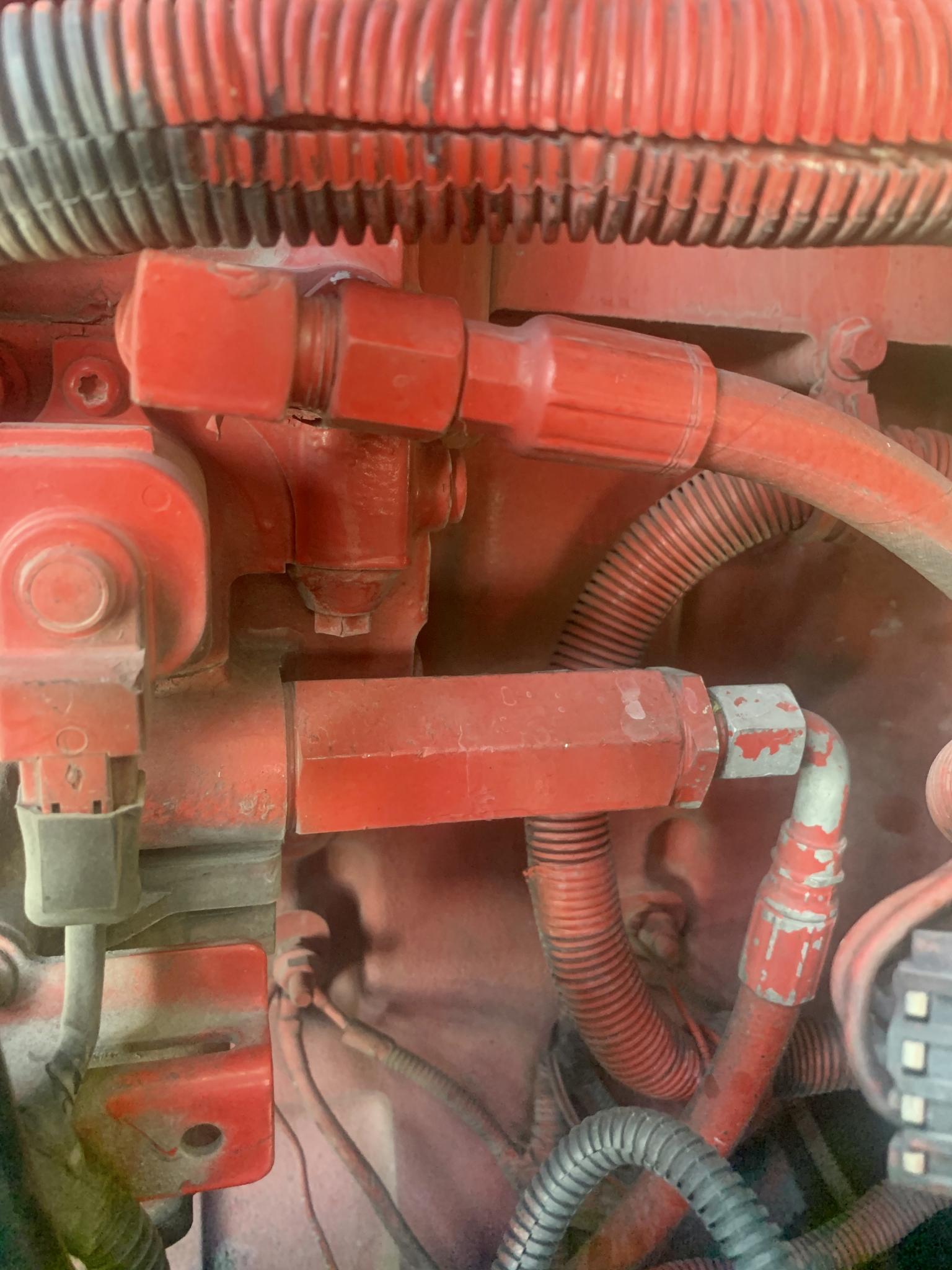

Filter Your talking about , here’s what it looks like on my CM570

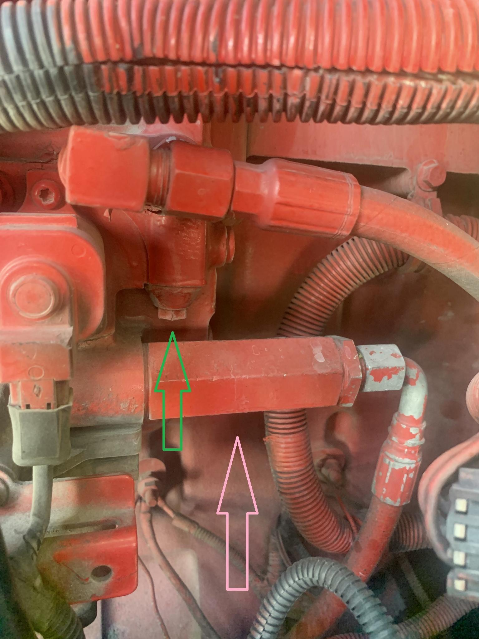

Pd6cas2, We may be talking about the same thing but just to be clear
This blow up is for a CM570
./uploads/201911/post_3285_1573771427_346ac3a23fdf5cd4063a1d9e57ad6f21.png
Part # 25 is what Evotrucker posted originally. I believe it's where I have the green arrow pointing in the picture below. Are you referring to where I have the Pink arrow as a filter also? That looks similar to a pressure reducer/regulator I have for my air turbo actuator. I've never pulled and IFSM on a CM570 apart. I'm going off of quickserve alone.

(11-14-2019 )Chamberpains Wrote:  Pd6cas2, We may be talking about the same thing but just to be clear
I dont remember seeing one like that on my IFSM but its what it should on my quickserve maybe i accidentally used the blueprints for the cm570 by accident.
